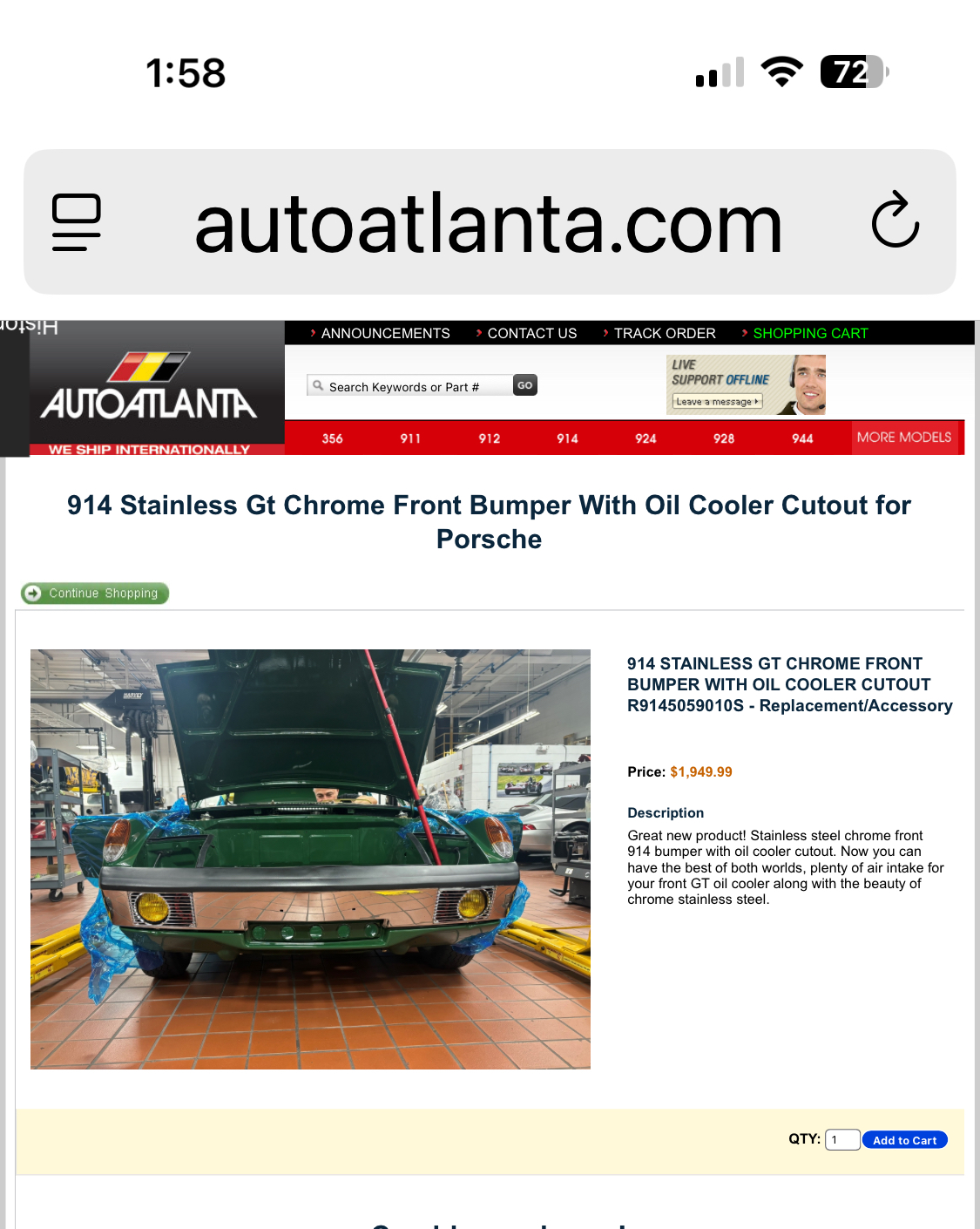

Oh, I see George has them as well!
https://www.autoatlanta.com/Porsche-914-Sta...mpers-srch.html

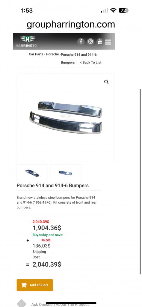

They all come from Group Harrington. I actually need a ss rear bumper (already have a front) so if they don’t sell bumpers individually, I’d be up for splitting an order with someone.

Looks like AA now sells a ss GT bumper

QUOTE(mepstein @ Sep 13 2025, 10:59 AM) *
Oh, holy smokes.
Thanks for letting me know. Wildcard as how it aligns with my Getty GT valance. If Ben did the custom work, I would know that it would fit just right.
I’ll reach out to AA for more info

QUOTE(mepstein @ Sep 13 2025, 09:59 AM) *
Pretty sure that I do those for them. I have done a handful for them
mb911
post Sep 14 2025, 04:39 AM
Posts: 7,641
Joined: 2-January 09
From: Burlington wi
Member No.: 9,892
So cat out of the bag I worked with Harrington to have them make the GT cut outs. The were not the right radius on the corners or even centered in the opening. Currently my car has one on it and the opening is offset by 1”. I need to fix that at some point.
To everyone’s point there are NO premade GT bumpers that exist currently. I am the one that does the conversions to the stainless bumpers for AA. Once the conversion is done to the stainless bumpers bumper the whole bumper needs to be repolished at a cost of about $300.
