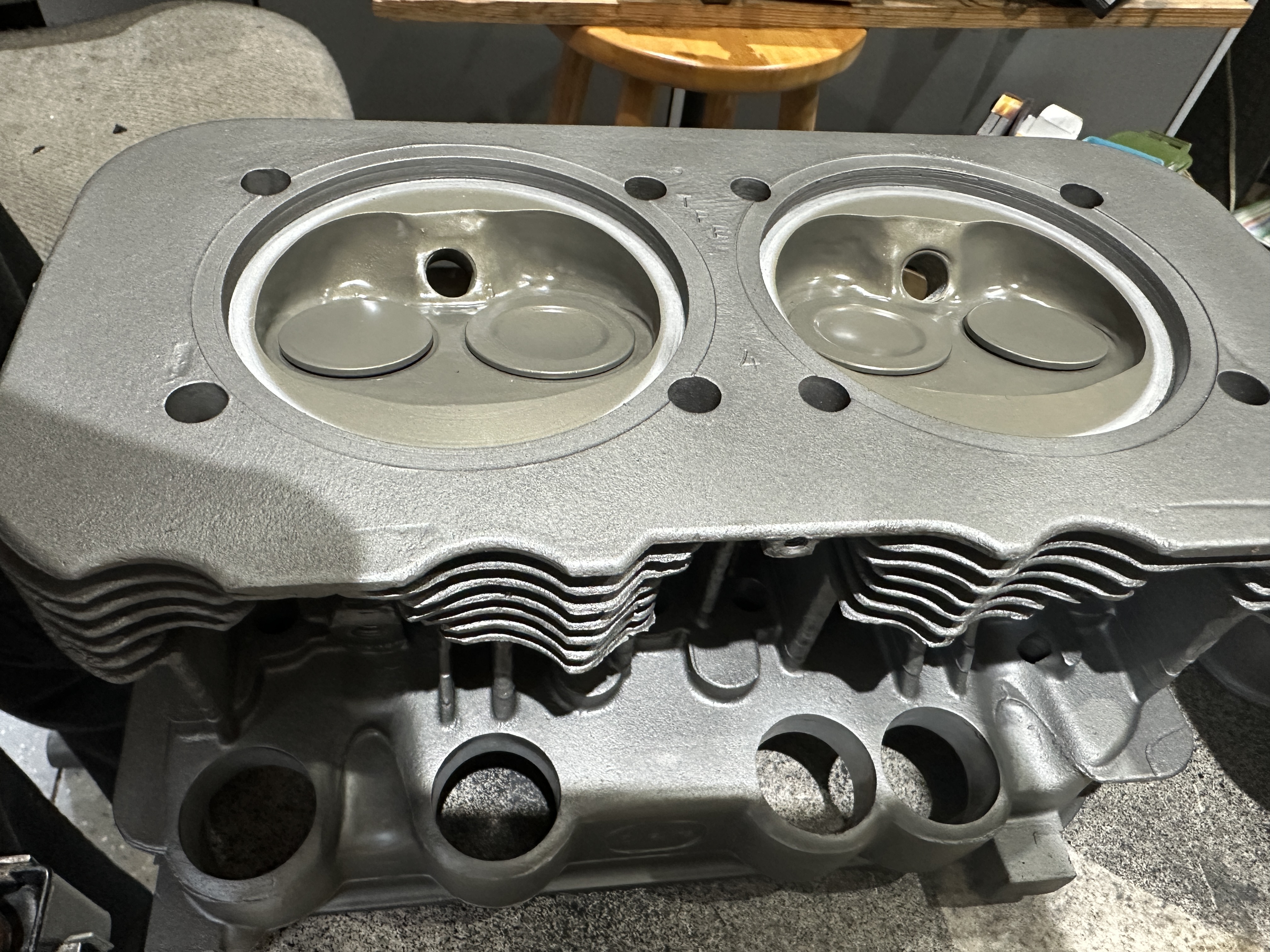

Cerakote air cured piston coatings on the exhaust ports and combustion chambers.
Next will be piston tops and heads get heat dispersion coating too.
Turned out pretty good one coat coverage

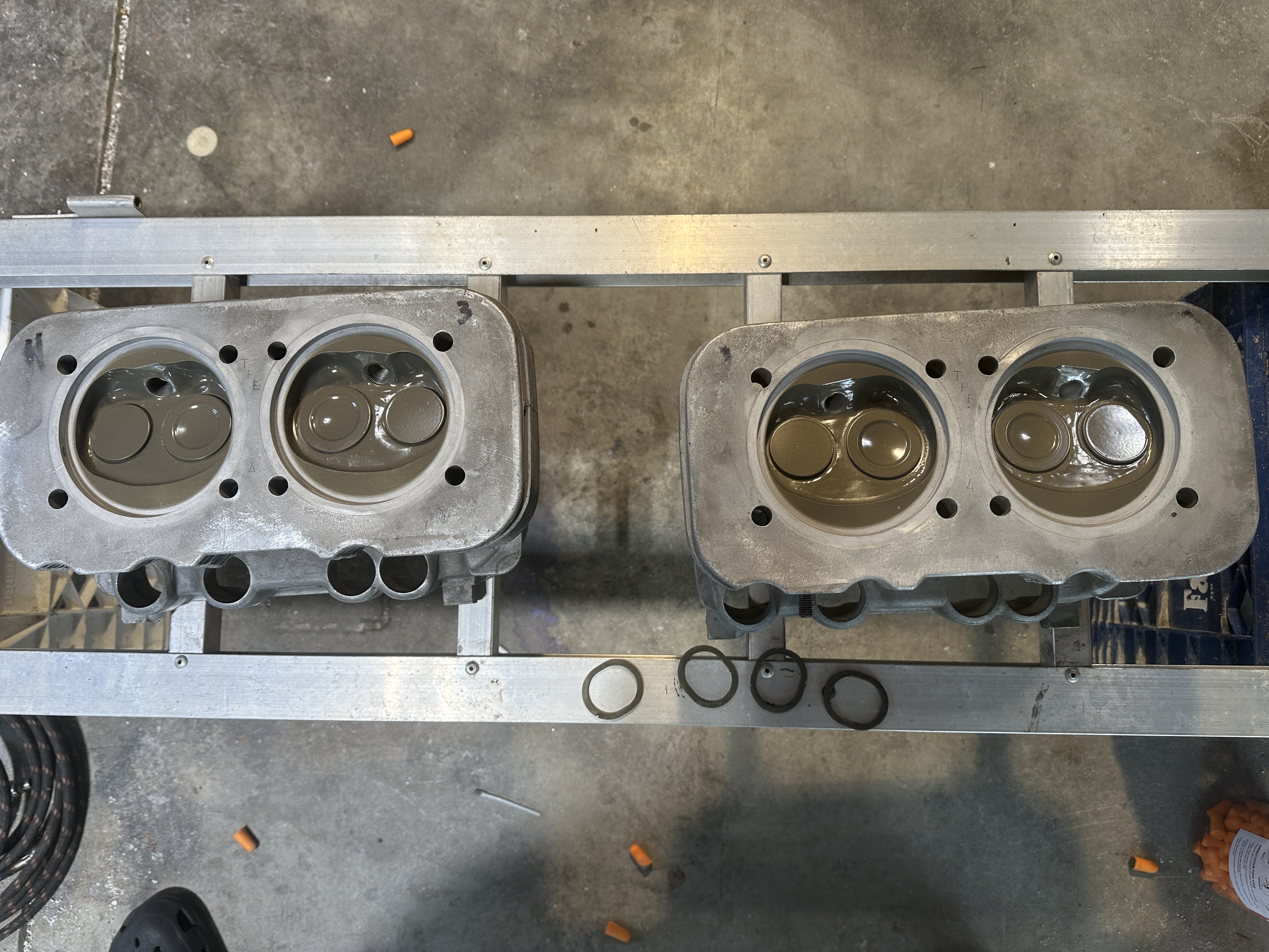

These heads were purchase here and included: welding of the ports and chambers seats and guides as well as around spark plug holed and one cert to a stopped plug hole
Prep included:
Blast with 120 mesh aluminum oxide to combustion, chamber and valves
Clean with acetone I did not gas as the oven was not use (air cured)
Tape
1 coat of Cerakote piston coating to combustion chambers, valves, back of exhaust valves and exhaust ports
Air cure 5 days

A couple questions if you don't mind.
Why not bake the heads after the Ceracoat?
How did you mask the sealing surfaces to keep the coating from messing up the seal?
Thanks
rfinegan
post Sep 13 2025, 03:07 PM
Posts: 1,104
Joined: 8-February 13
From: NC
Member No.: 15,499
Yeah they offer oven cure and catalyst hardeners, this one is 5 day air cure. the end result should be the same?
The area on the head was blue taped, the vertical edged and the folded over then wider tape to cover the bottom of the head. I just use 4 of the head gaskets you get in rebuild kits and set one on each head. The added tape help them tight. A little clean up with acetone.
I did the same with the exhaust ports and back of exhaust valve and use a old brass seal the same way as above t okeep the are free of coating

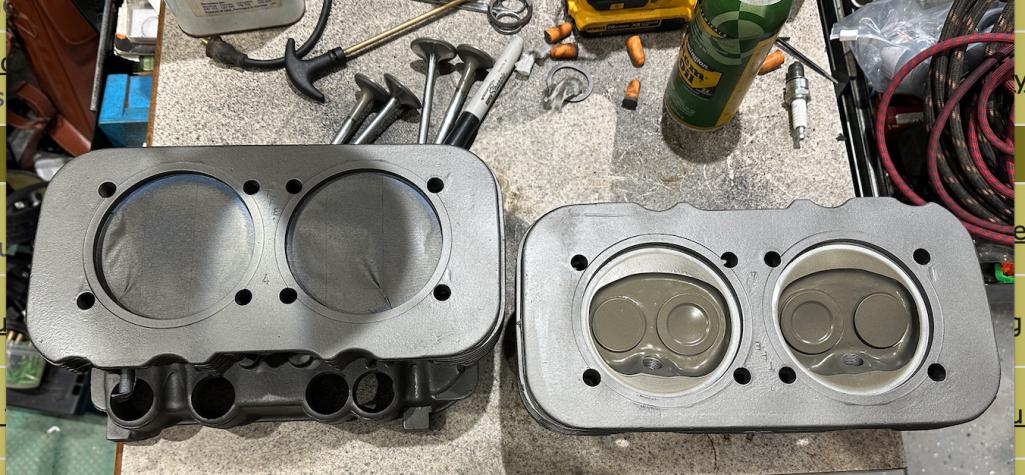

...you can see the exhaust seal in the pic to keep the surface free of coating

Oh, the ear plugs seal off holes very well that you do not want coating (or blasting)....see pic and spark plug holes

A little problems with the Passche air brush, but the thermal dispersion paint is done and drying.... This too is CeraKote...

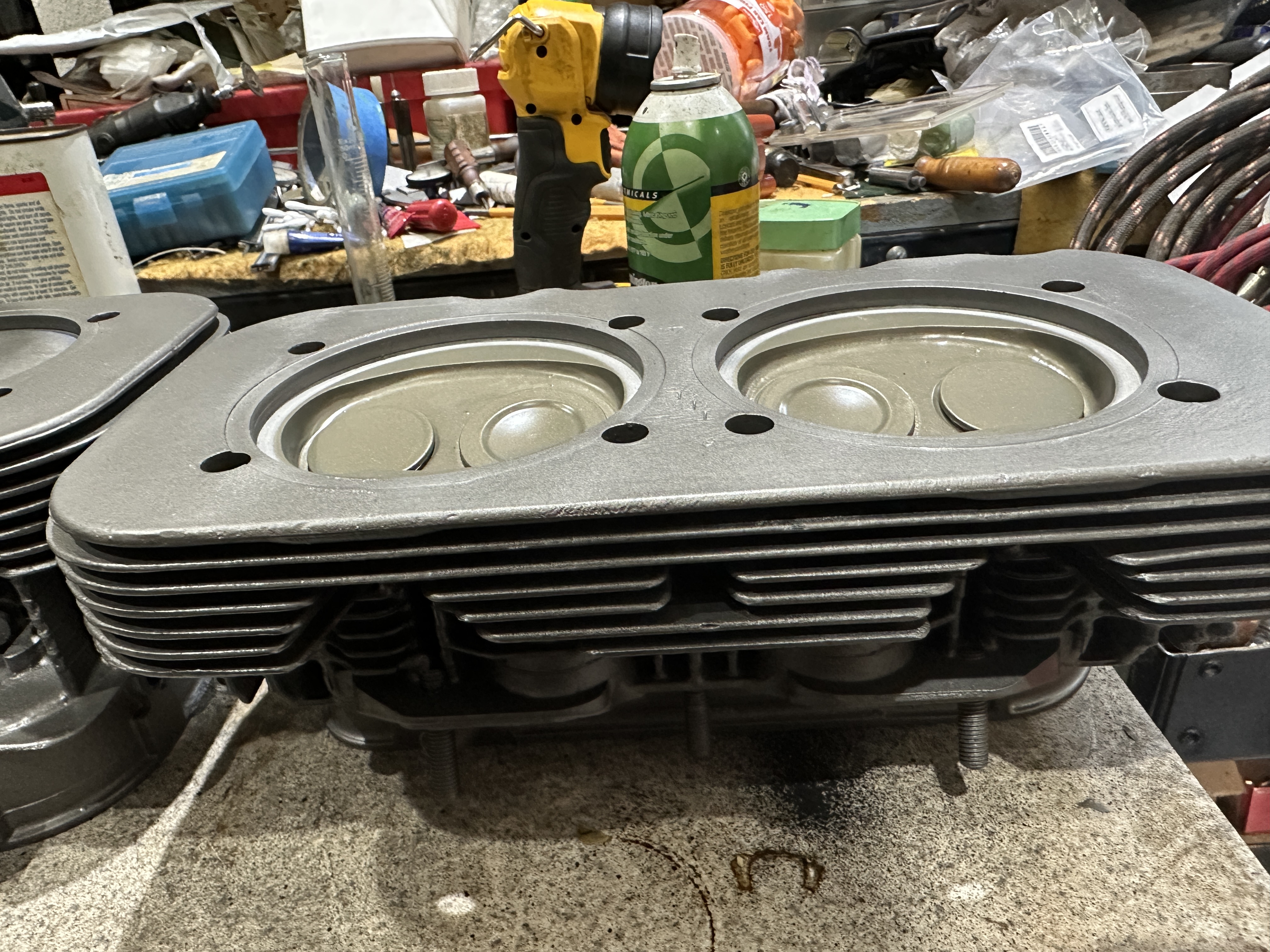

Member No.: 15,499
another:

Member No.: 15,499
another:
