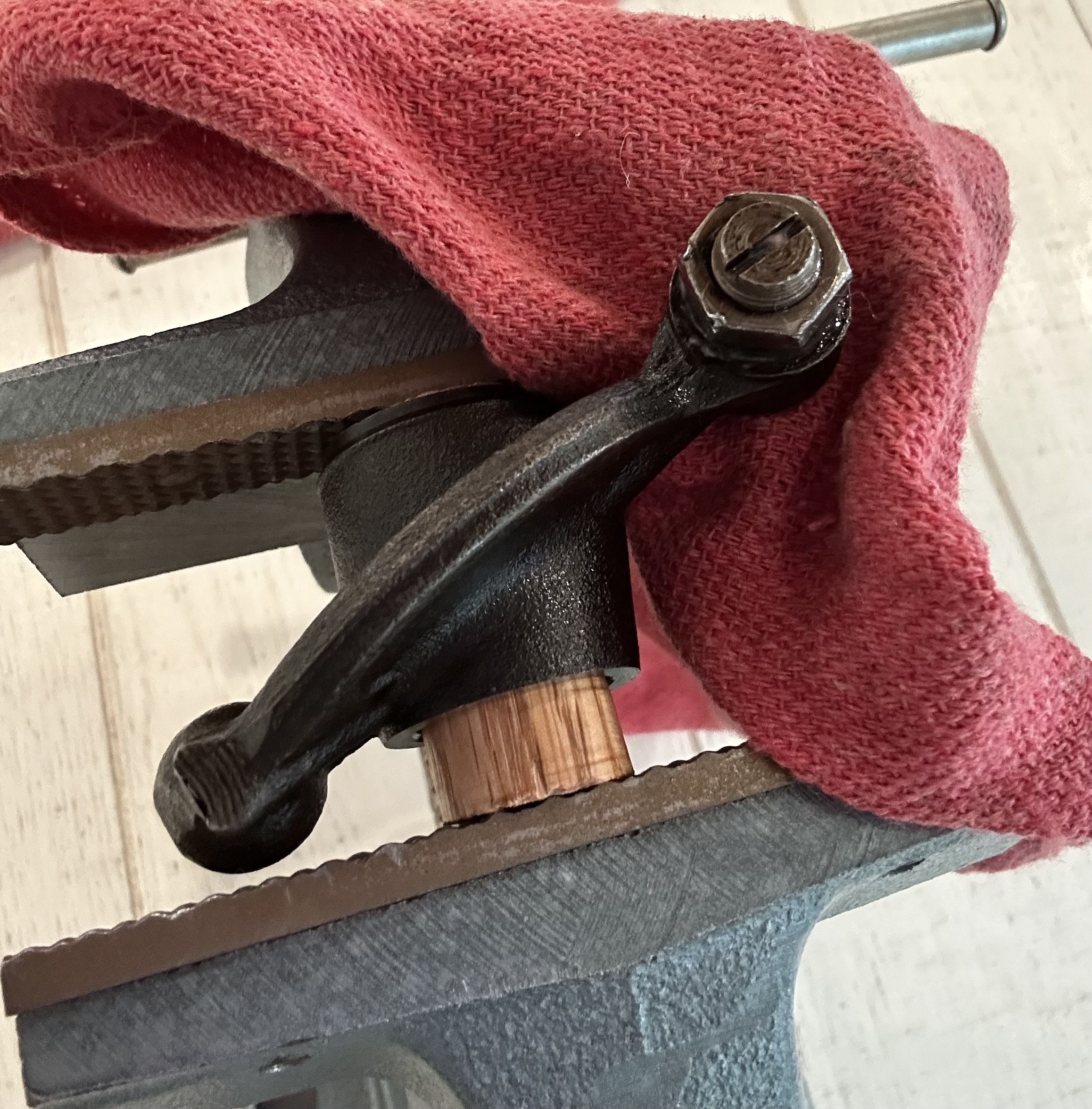

DC_neun_vierzehn
post Nov 17 2025, 08:47 PM
Posts: 596
Joined: 16-November 20
From: Coastal Delaware
Member No.: 24,893
Gents, thanks for all the recos. I soaked the rockers overnight in a 50/50 mix of acetone and ATF. Then slipped each rocker in a 3/4” diameter dowel (about 2” long) and dropped into a vice. Used a 6 point socket … took a good bit of force but they eventually broke loose. I will inspect the treads on the adjustment screws for over tightening damage tomorrow in the daylight. But at least I have them completely apart now.
