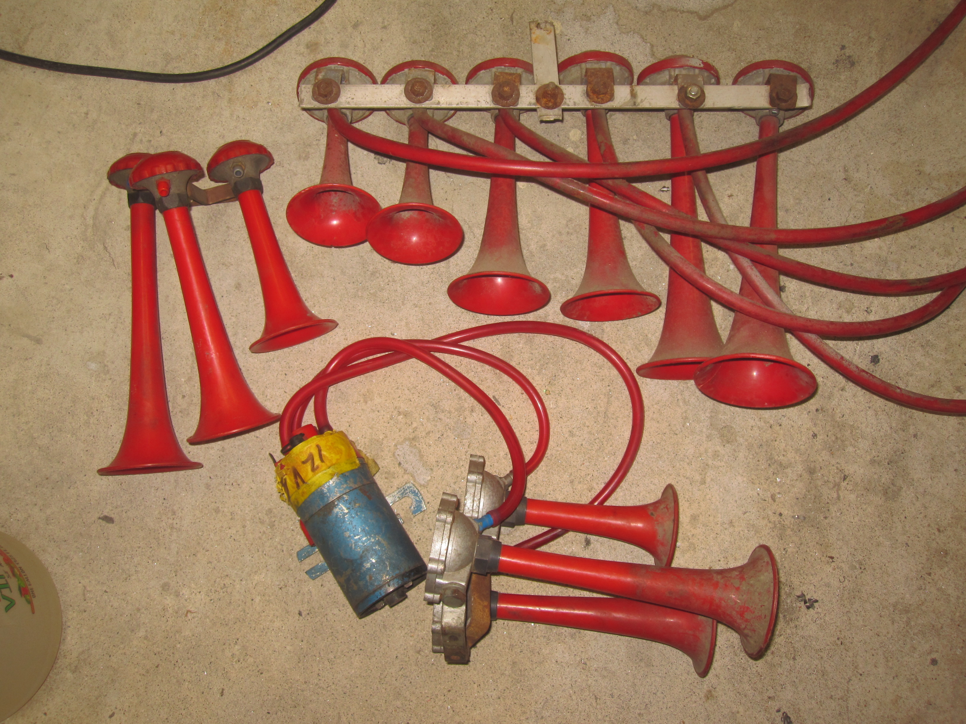

I want to run trumpet horns.
I have vintage ones that have three trumpets and a pump so
packaging is a real issue.
In the past it was possible to have them play various tunes. (IMG:style_emoticons/default/smile.gif)

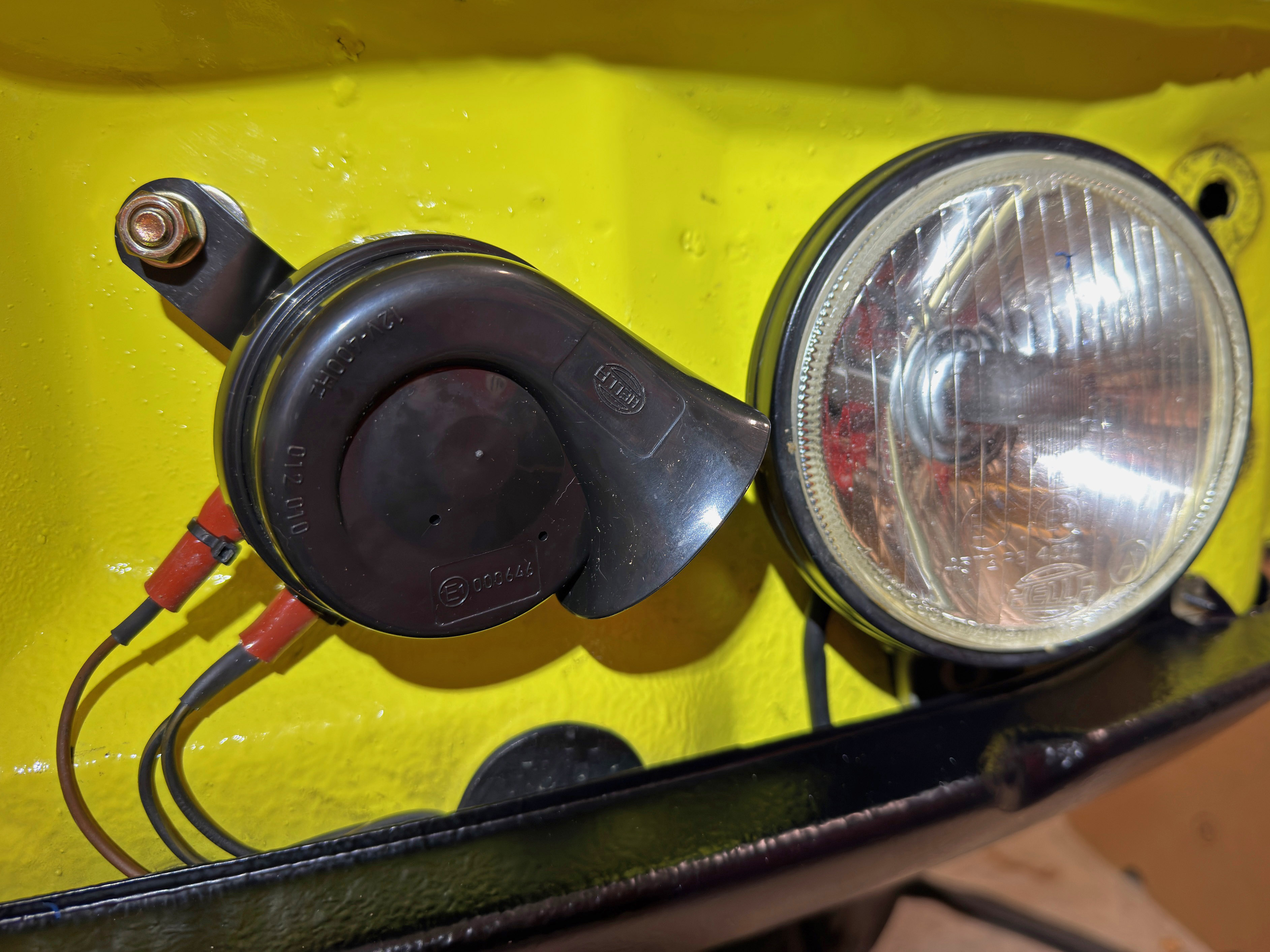

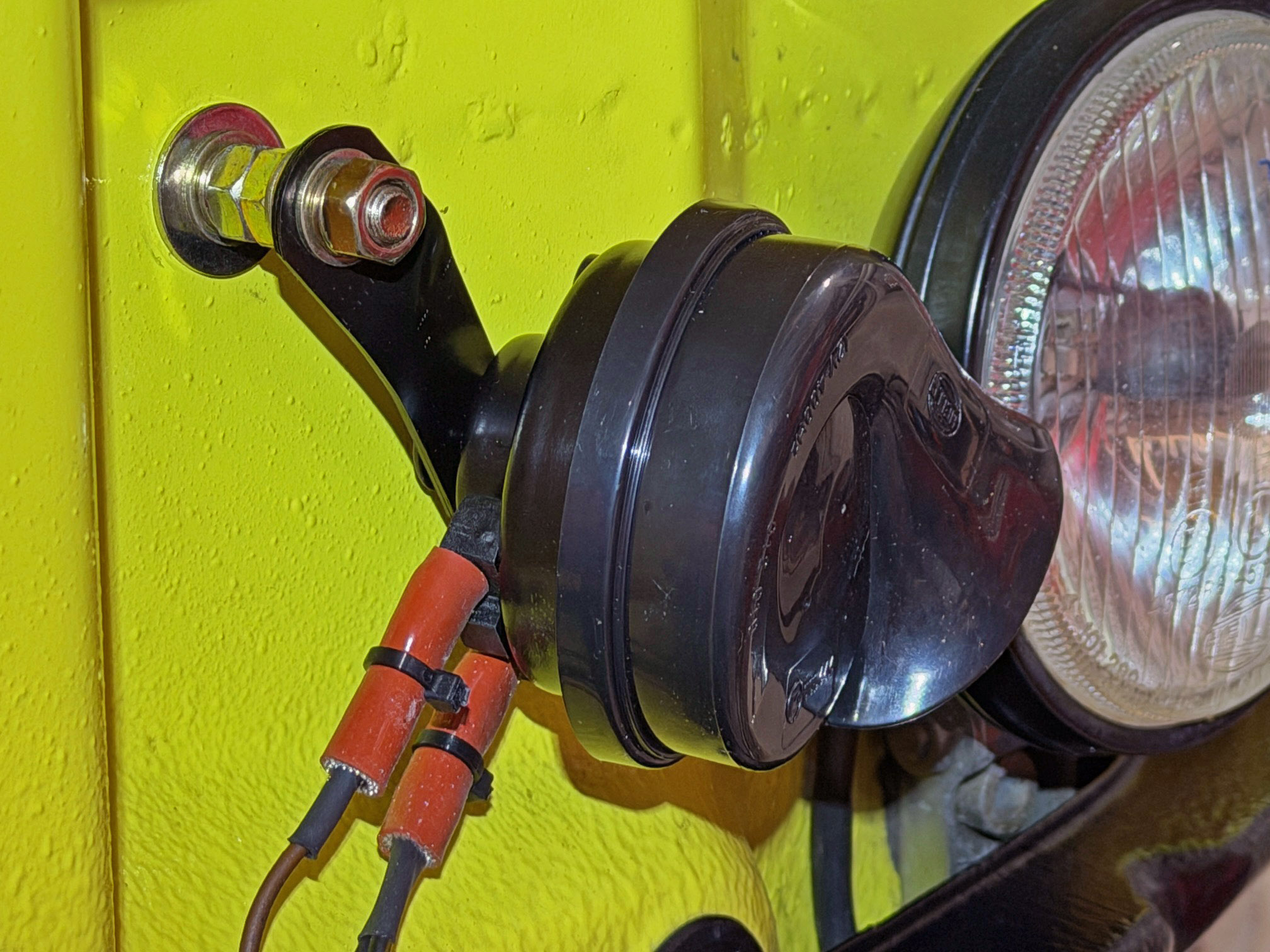

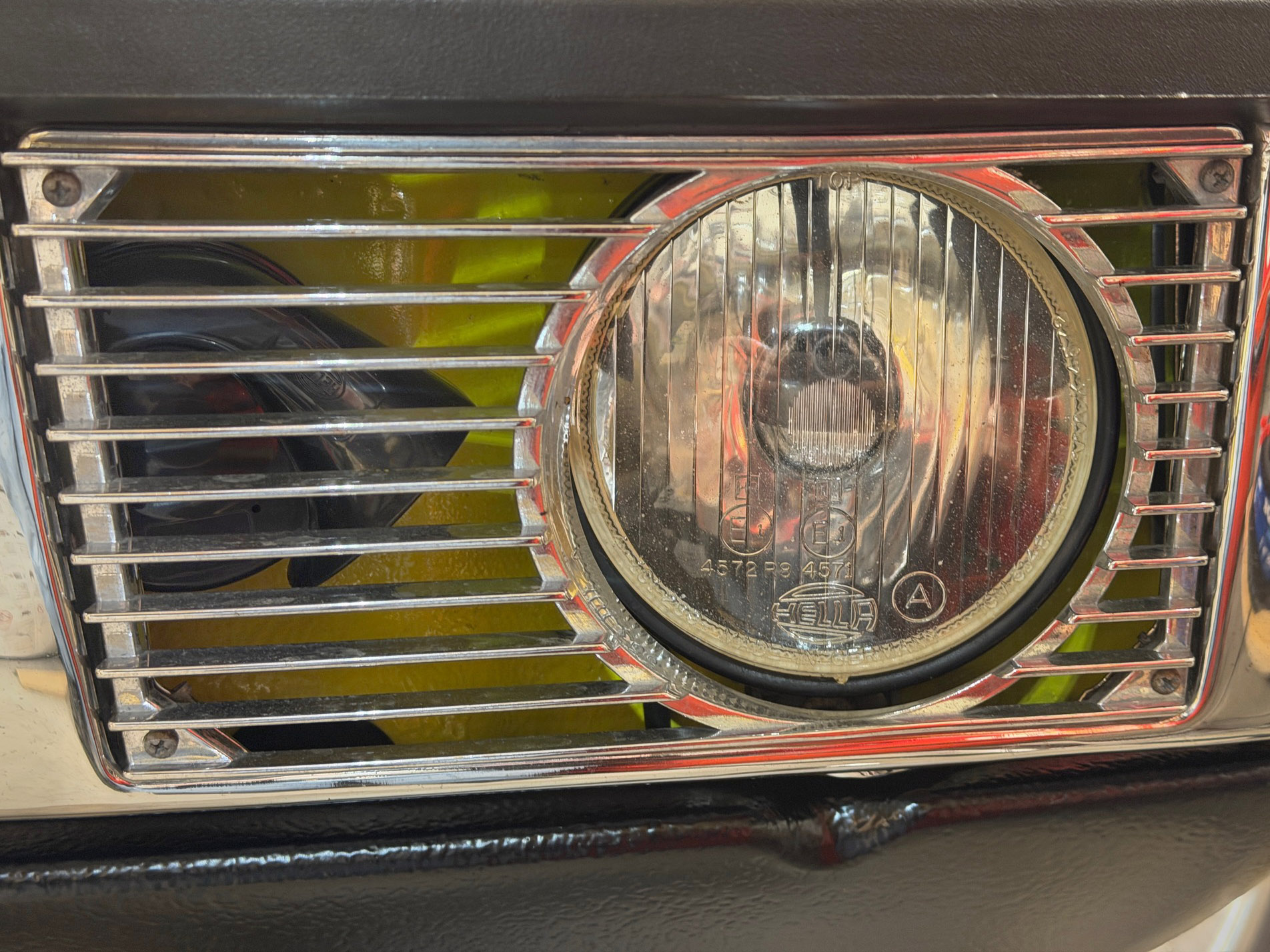

So I finally installed a set of Hella Twin Tone horns. They do fit in the space but there was a bit of work to do. The instructions that came with them said to absolutely not touch the nut that mounts the bracket to the horn or the sound might be affected. So I carefully bent the brackets and made standoffs to re-orient the horn so it would fit behind the grille.
They definitely sound great - no longer a "beep" and much more like a "honk". Still does not quite rival the horns on my '57 T-Bird - one thing I can say about her is she has great honkers! (IMG:style_emoticons/default/laugh.gif) (IMG:style_emoticons/default/shades.gif)
I don't know what the original horns for a 914 were like - the ones I took off the car look too new to be original - and they are both the same tone.
