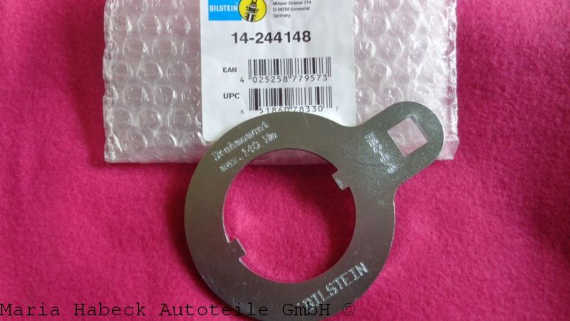

The torque spec from Bilstein was 95ft lbs + or - 7ft lbs (little paper instruction insert that comes with the inserts) for the strut insert retaining nut. I had a clunk from the left front on my father's 914 before I replaced the strut inserts. Found the left front strut insert retaining nut was finger tight from the person who installed them in a repair shop many years ago before I started to go through my father's 914. I torqued the retaining nuts to spec with the Bilstein tool adapter when I put the new strut inserts in. No more clunk.

Excellent, our next move -
tool adapter? In some of the posts pipe wrenches were mentioned- not here, in a suspension forum (IMG:style_emoticons/default/smile.gif)

This is the gland nut tool for the bilstein strut insert retaining nut. I placed the order directly through Bilstein. I think it was just over $20 shipped to my door. Re-read the installation instructions and the recommended torque spec from Bilstein is 95 + or - 7ft lbs.

Tool is $8+shipping a Sierra Madre Corp
