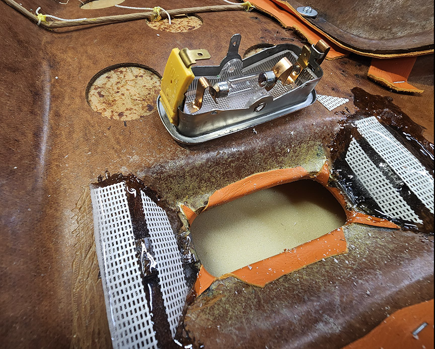

Has anyone had success repairing the hardboard that is behind the seat back pads? I think it's melamine, but it could be some other fiber board or hardboard like MDF.
I have a a couple screw holes that have pulled through, and one side of the interior light clip is pulled out.
Most of what I'm finding online seems geared towards thicker furniture applications.
P.S. Perhaps of interest to the originality folks, what appears to be a hand written marking. I think it reads "165".

Its just a formed wood fiber fiberboard. You can try a fiberglass patch to good material beyond the holes.

DennisV
post Jun 11 2026, 01:00 PM
Posts: 973
Joined: 8-August 20
From: Santa Rosa, CA
Member No.: 24,575
QUOTE(JeffBowlsby @ Oct 23 2025, 06:27 AM) *
Thanks for the fiberglass suggestions. I did some poking around, but most fiberglass videos seem to be for boats or flat surfaces. Didn't scare up much for molded / contoured fiberboard, so I made a short video with help from my dad. There ended up being a few different repairs needed. Not very elegant, but I learned a lot and it should be functionally sound. Maybe it will help someone else down the road.
Molded Fiberboard Seat Back Repair with Fiberglass

Member No.: 15,674
thanks for the video. Nice work and effective.
I have often thought about using heavy paper like from a brown paper bag and using the thin penetrating resin as used for wood rot.
Its one of those deals that no one but you will ever see

I just reinstalled my interior and for the various cracks and missing tabs I just used a 2 part epoxy. It filled the voids fine.

This is the way Dale repaired my back pad. I put in a 911 interior light. Metal
