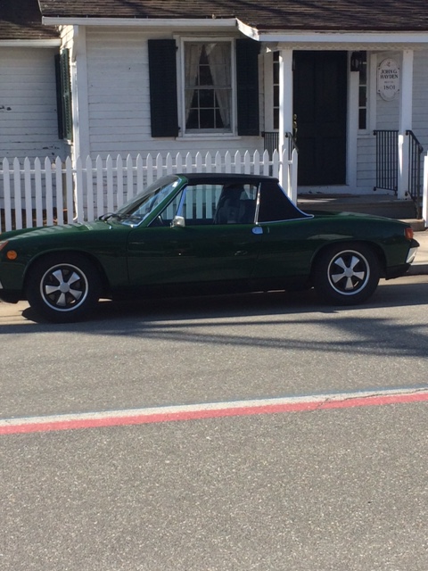

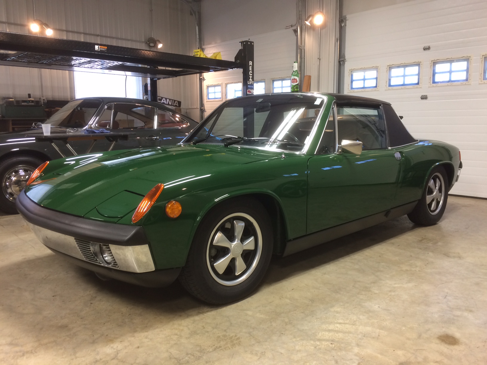

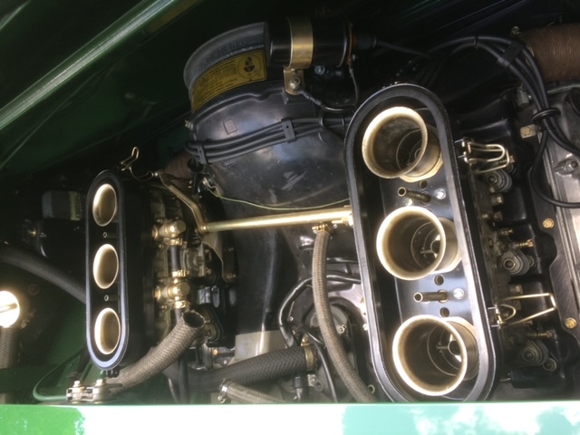

That piece could probably be 3D printed in suitable plastic.
From what I can see your car looks very clean. Pictures please !
John I'm in North Jersey good to see a new original 'local' 6 Rory

Thanks -- I've had the 6 for about 15 years now -- all numbers matching.

Looks nice John. Have you kept it mostly stock?
