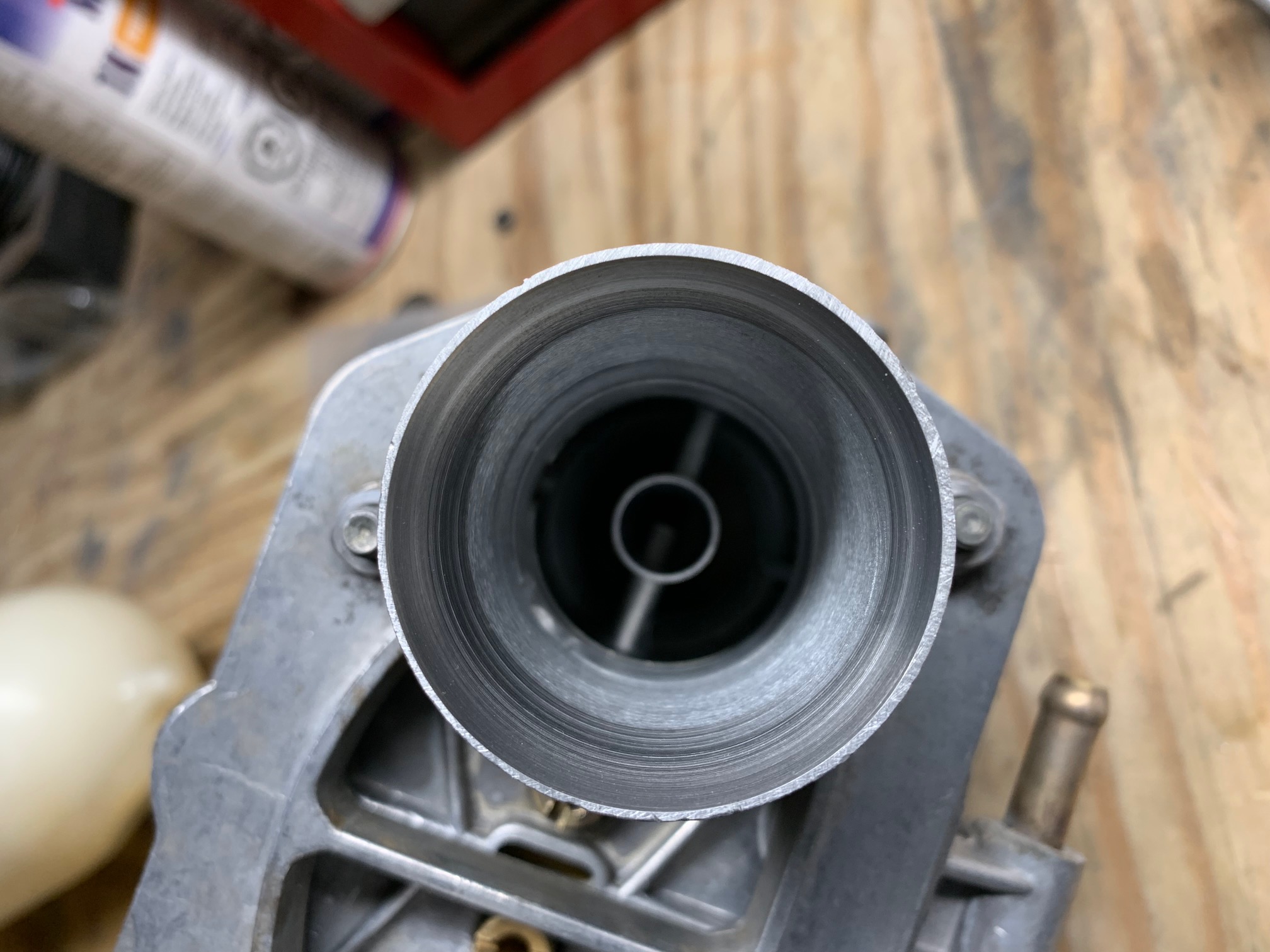

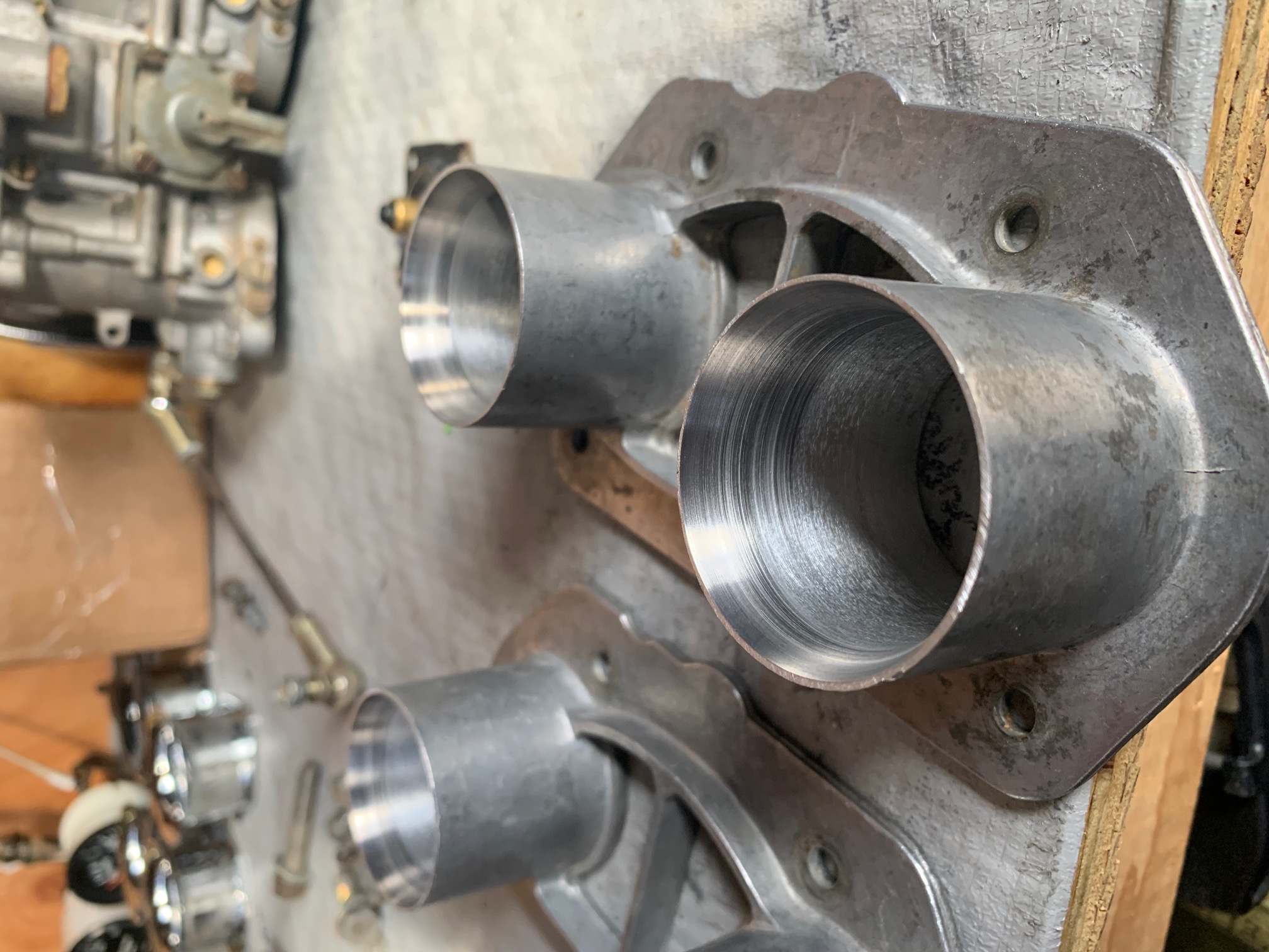

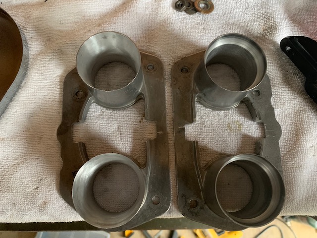

I am using dual Weber 40 IDF's. 96mm cylinders c35 scat cam

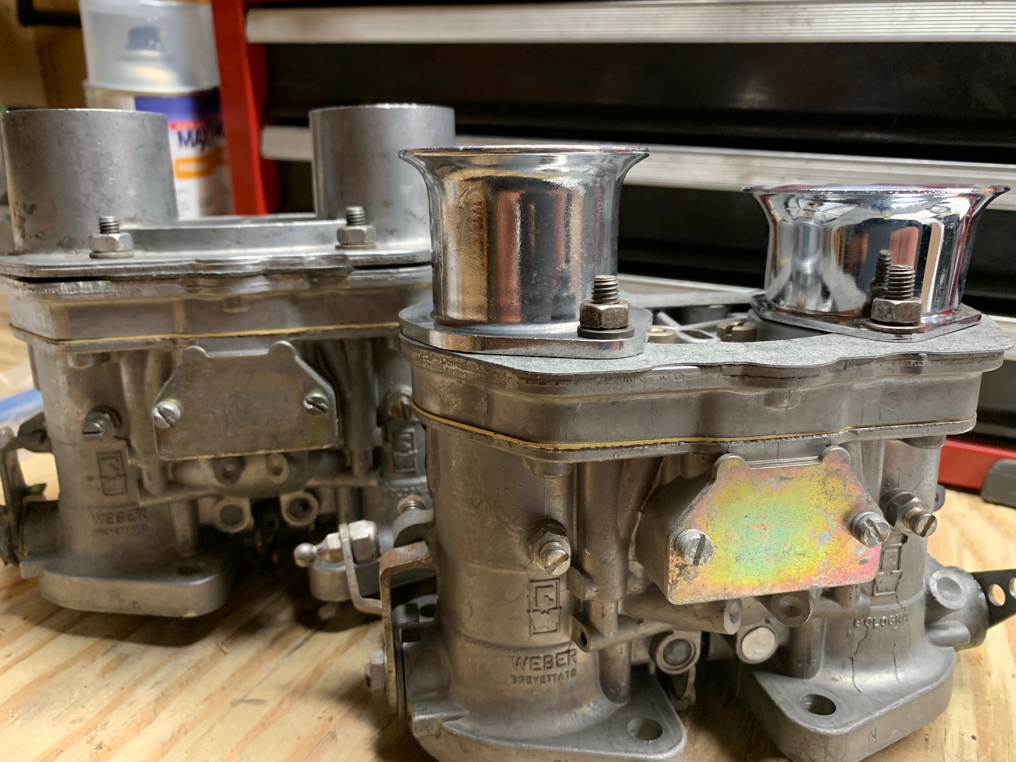

#1 The Original "velocity stack" is a straight shot down the throat of the carb.

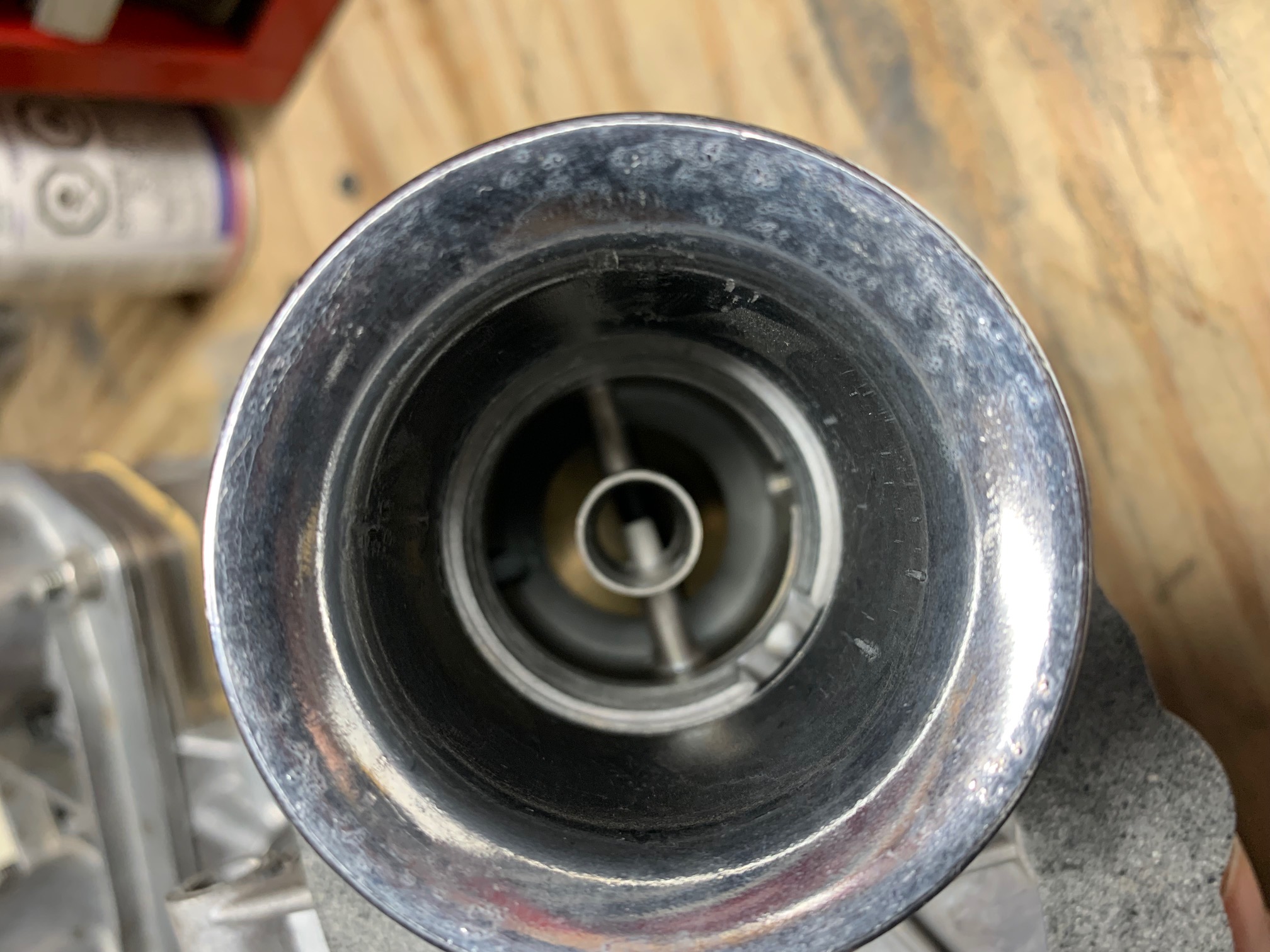

#2 Shorter shinier velocity stack is for 40 - 48 IDF and leaves about a 1/8" lip at the top plate of the carb

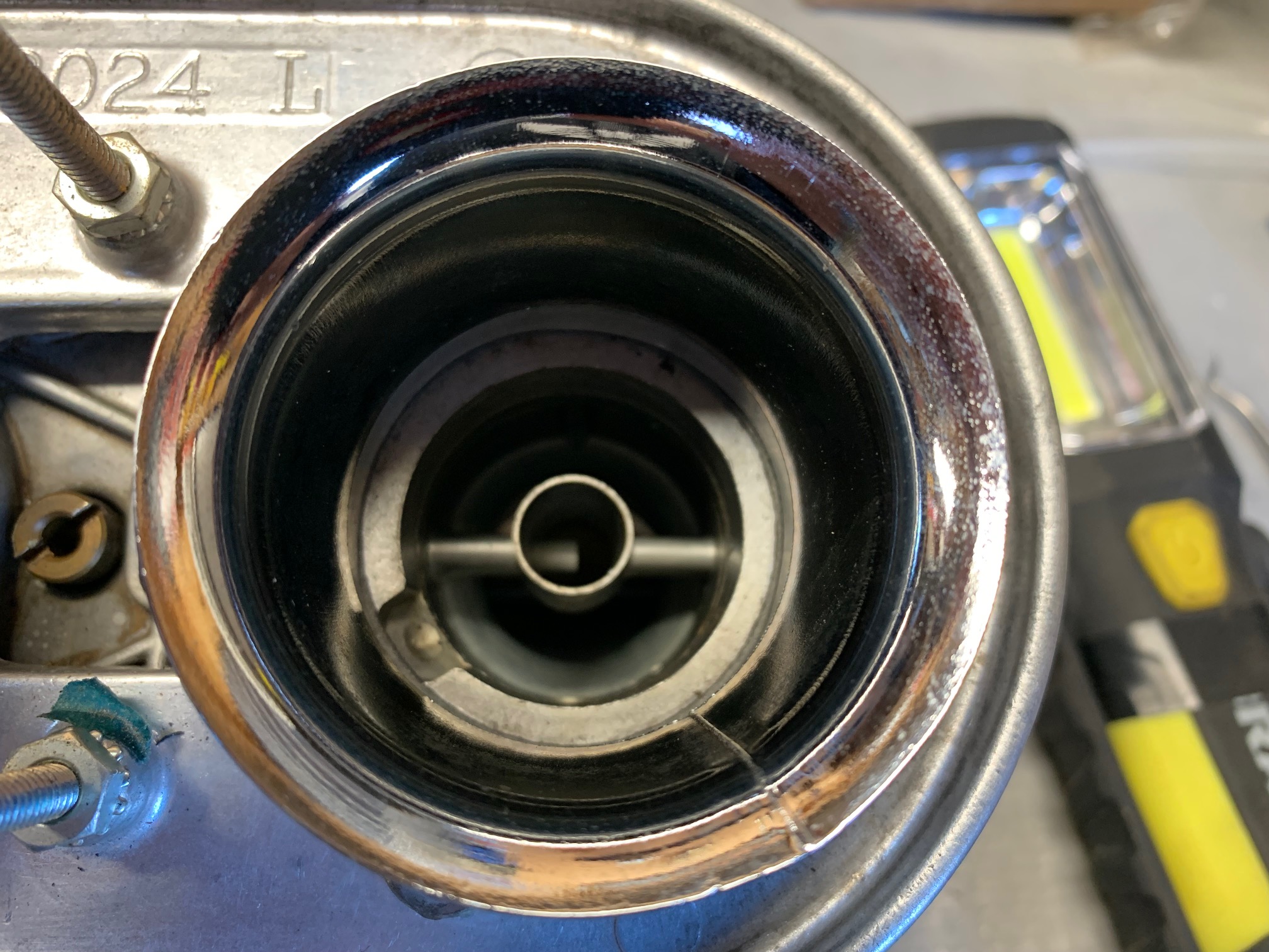

#3 The taller less shiny velocity stack says it is for DRLA & IDF 36 - 40mm but leaves about a 1/16" lip at the top plate of the carb
I started to widen the inside of the #1 Original and thought it better to have a straight shot down the throat then it would be to have any bit of a lip.... however, I was recommended to use the non original velocity stacks and don't worry about the lip, they've "found it doesn't affect performance".... which seems counterintuitive to the ideas of porting, polishing, and general flow etc
1. Do you think opening up the original velocity stack and having the straight shot is worth it?
2. Should I not worry about the lip?
3. Is there a stack that would fit the 40 IDF specifically without covering a range?

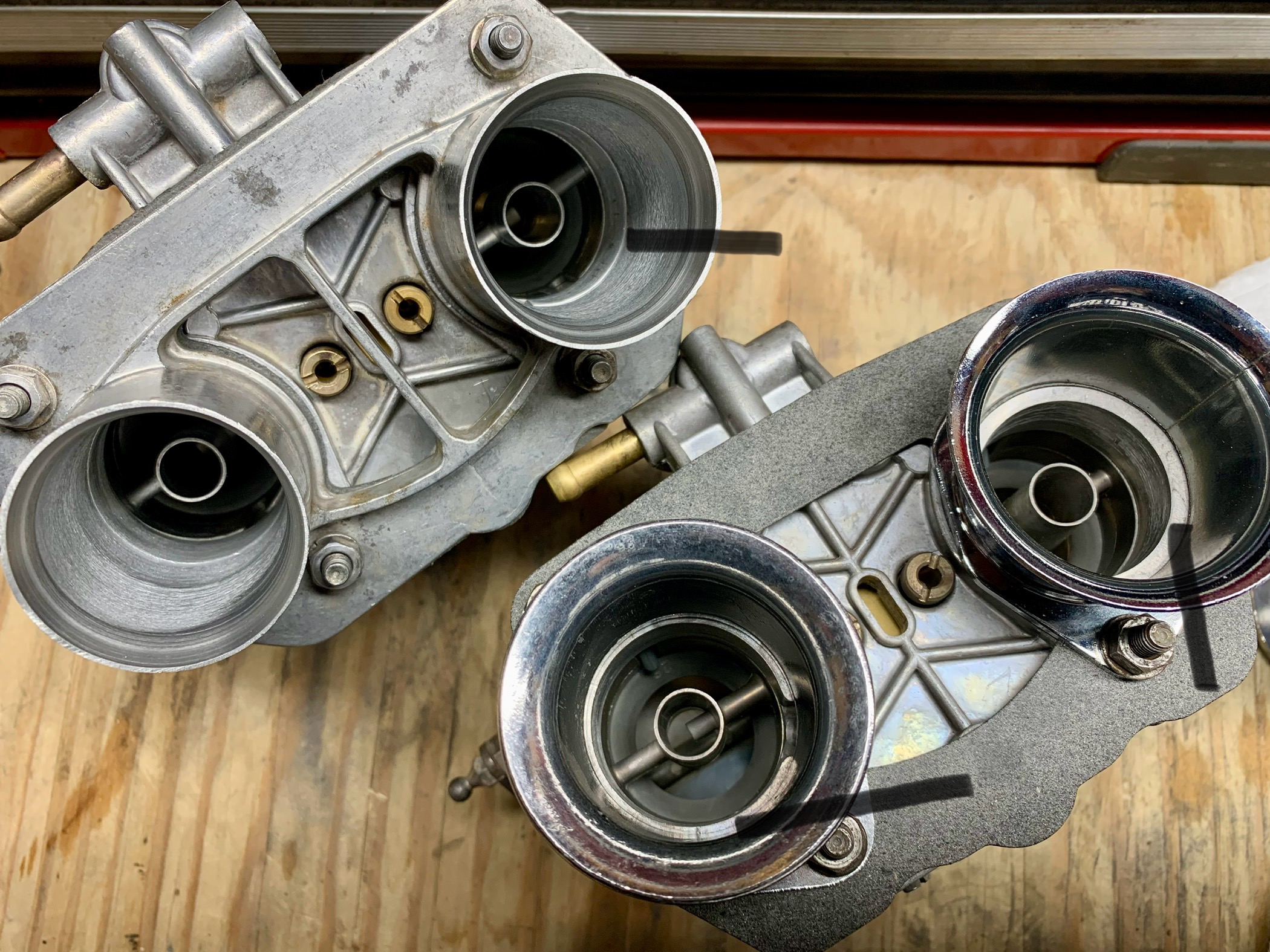

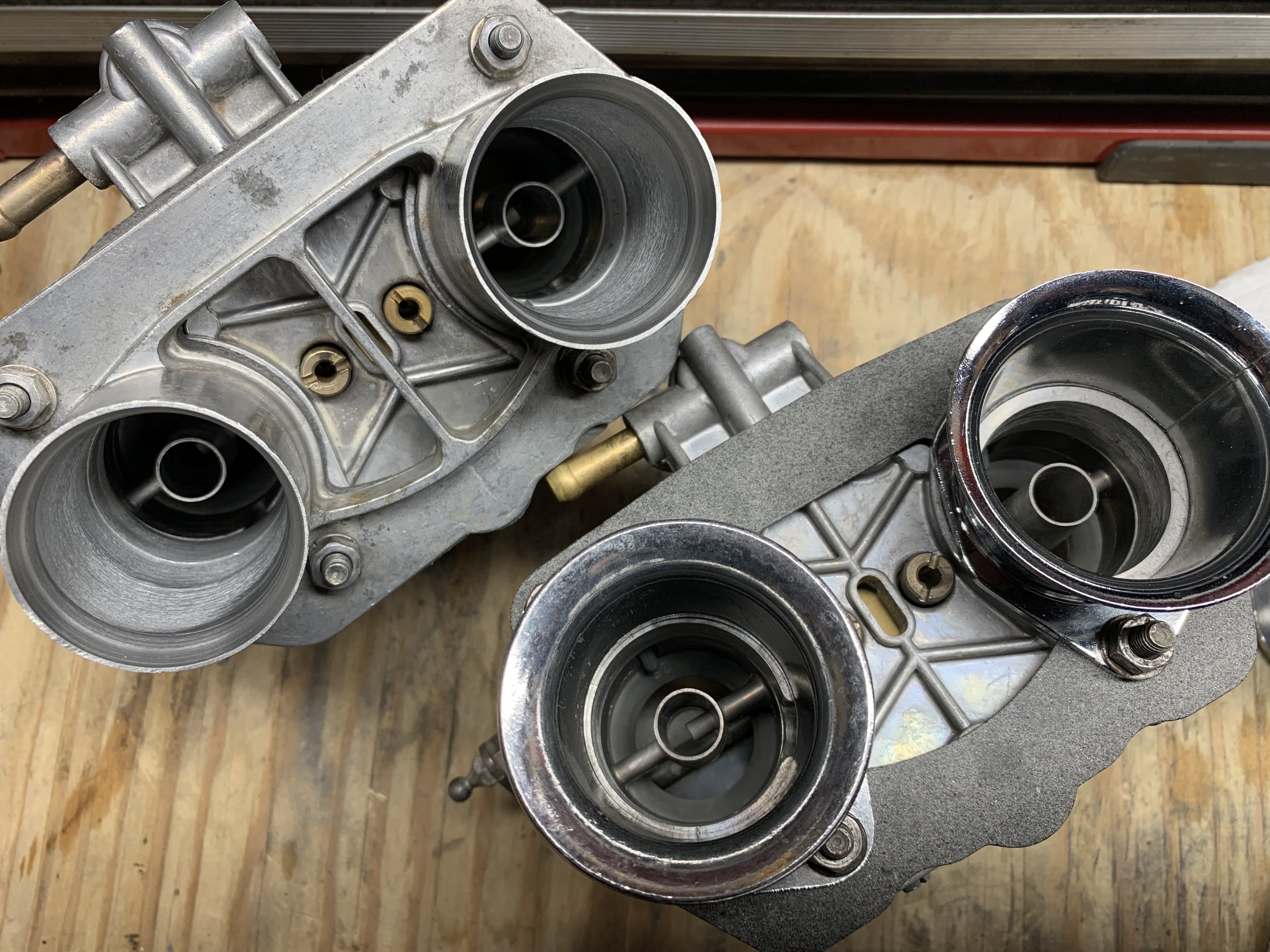

Here's an above view with each

There are at least two different diameters on venturis for IDF carbs, so there might be velocity stacks with different diameters. See if your favorite carb vendor can set you up. (IMG:style_emoticons/default/smile.gif)

QUOTE(Jack Standz @ Nov 7 2025, 01:24 AM) *
Good morning! Thx you Mr. Standz (IMG:style_emoticons/default/lol-2.gif). I think I'm all set with the venturi at least until I see how it runs. The issue is the area well above the venturi. It was the vendor that told me not to worry about the lip created by the wider inside diameter velocity stack (I tried to show in these picture). The stacks seem to be only sold like a one size fits all 40mm -48mm or 36mm - 40mm..... same with the air cleaners now that you mention it lol

QUOTE(neyen14 @ Nov 6 2025, 06:53 PM) *
The flow dynamics of velocity stacks goal is to create a straight column of air induction into the carb throat without interruption. Any deviation of the straight induction usually creates turbulence, and that reduces input flow. For a full on high RPM race engine that disruption might be significant, but for a street engine the reduction of intake air flow would not likely be notable. The design of an air cleaner for the intakes would be of concern, as any restriction there would be of more relevant for race engines with greater intake air flow requirements, less so for a lower RPM street engine. (IMG:style_emoticons/default/driving.gif)

You don't want to have a ledge/lip at the velocity stack / carb interface. As mentioned above, it disrupts the air flow and kinda negates the benefit of a velocity stack. You should be able to find stacks with the correct ID for a reasonable price.

Thank you for this feedback.... pretty much the way I understand it. Even though I have no plan to race it I'd still like to have it be all around as efficient as possible. I'm gonna continue widening the inside diameter of stacks that came with the carb being that they line up perfectly... the go from there.
