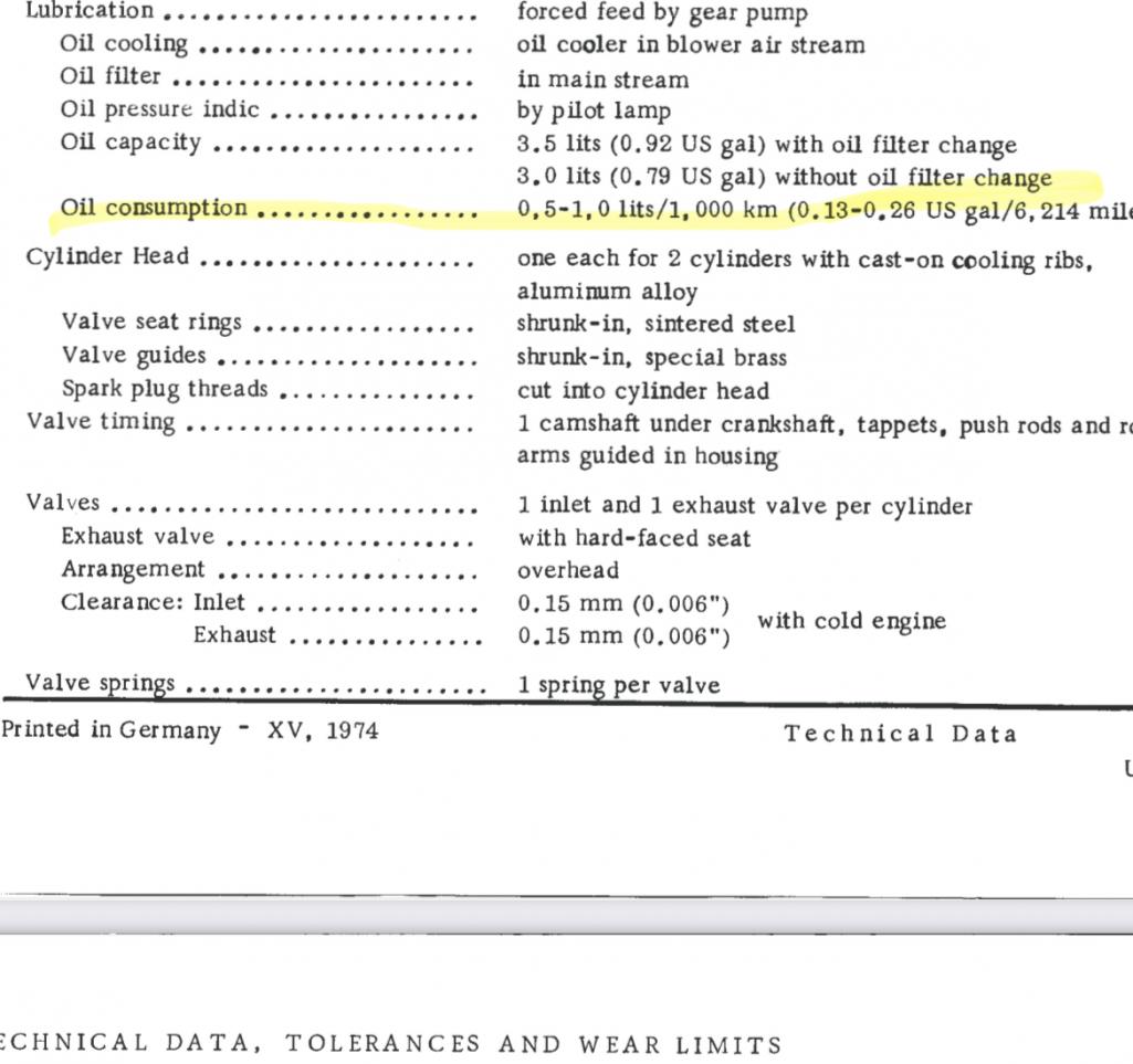

@Superhawk996
ever noticed the typo/misprint in oil consumption amount in that spec posted.
says per 1,000km for the litres. and per 6,210 miles for the us gallons.
they have the litre amount correctly transposed to US gallons.
but they have left a zero off the km conversion.
should be per 10,000km? a km is 0.621 of a mile.

1000 km =621.371 mi decimal in wrong position . . . . 1 liter is 0.26 US gallons (approx 1 quart). . . Monday after a 3 beer lunch? (IMG:style_emoticons/default/confused24.gif)
Hopefully OP has a little more background and/or has access to a leak down gauge.
Note: 1L of oil consumption per 10,000 km isn’t plausible for an air cooled engine design with origins that date back to the 30s.

QUOTE(Superhawk996 @ Nov 26 2025, 08:03 PM) *
right.
something had to be wrong there.
but even my old type 3 squareback never used anything like 1/2 to 1 litre per 1000km.
at most it might have gone through half a litre per 3000miles going back in time between services (oil changes) which i used to do every 3000 miles max. its speedo/odo was still mph but aus had gone metric and oil was sold in metric containers. i reckon i used to do about 1/2 a litre in 4,500 km.
as to the 914, it uses precisely zero oil between changes.
