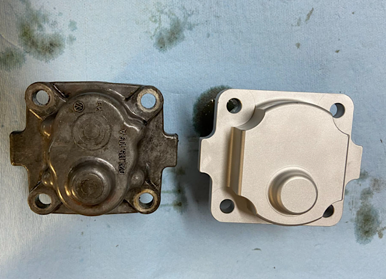

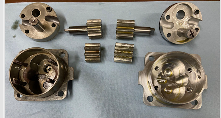

I bought one of those T4 CNC billet pumps back when they were available.
30mm so limited use cases
It does have the proper OD and port match
Idler shaft was not pinned or peened as I prefer to do with any T4 pump. Attached Image
With respect to sizing of T1 pumps it’s a tolerance game - there are some out there that are only 0.001” undersize so it’s a sorting game to find the best parts. I don’t have a reliable source for “good” parts. Your info on the modified T3 pump is interesting. Have never seen that service listed on the website but good to know.
