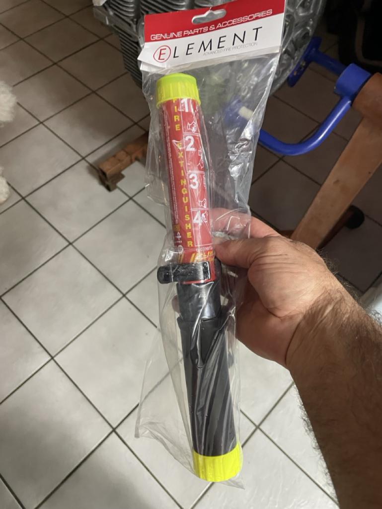

I went with the Element extinguisher. They are are very small footprint, can mount anywhere. Also put out any type of fire without leaving a mess at all. From what they advertise, it last 3 times longer than a typical pull and squeeze type. Even comes with the mounting clip. I measured it and it will fit beautifully under either seat.

QUOTE(Chad911sc @ Nov 29 2025, 02:12 PM) *
Thanks. Just read about it and ordered one. They owe you a commission!
