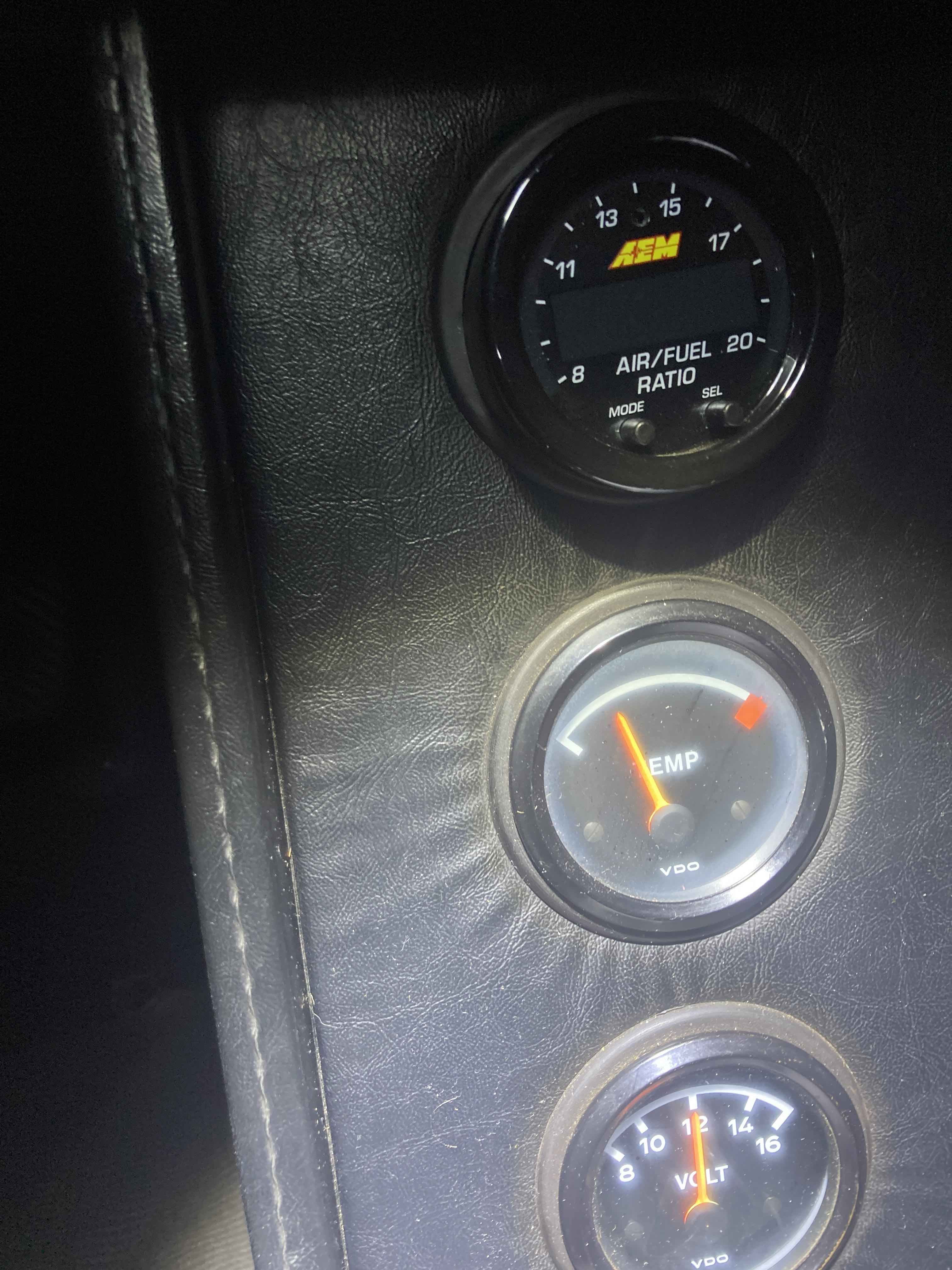

I need to address what I think might be a high oil temp problem .

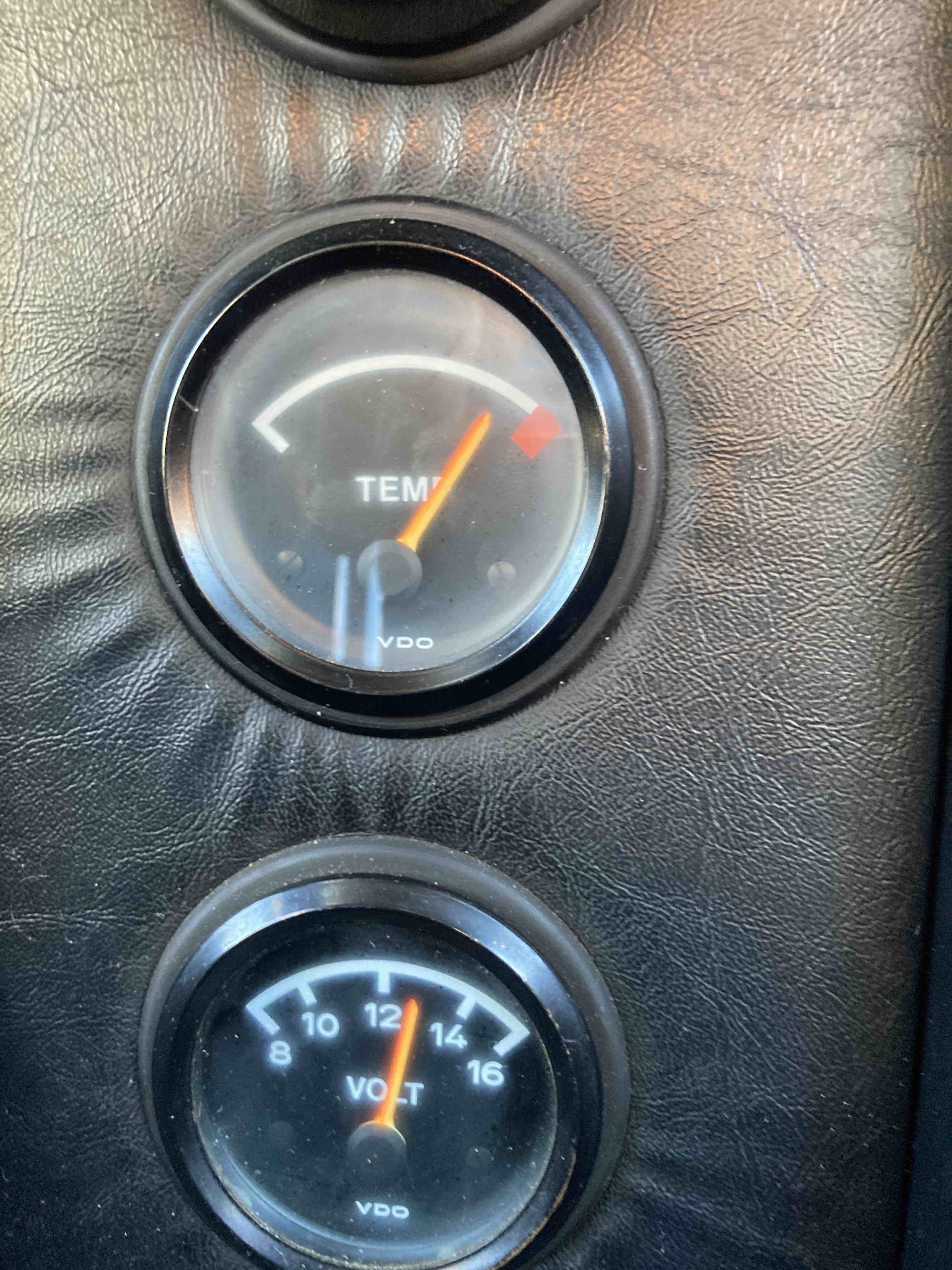

After driving around town for 30 minutes the photo shows my oil temperature oil gauge and a actual thermometer reading using a turkey fryer thermometer.
The needle on my console gauge gets very close to the red high mark and sometimes just about to cross into the red .
At this point the turkey thermometer reads ~216 F degrees .

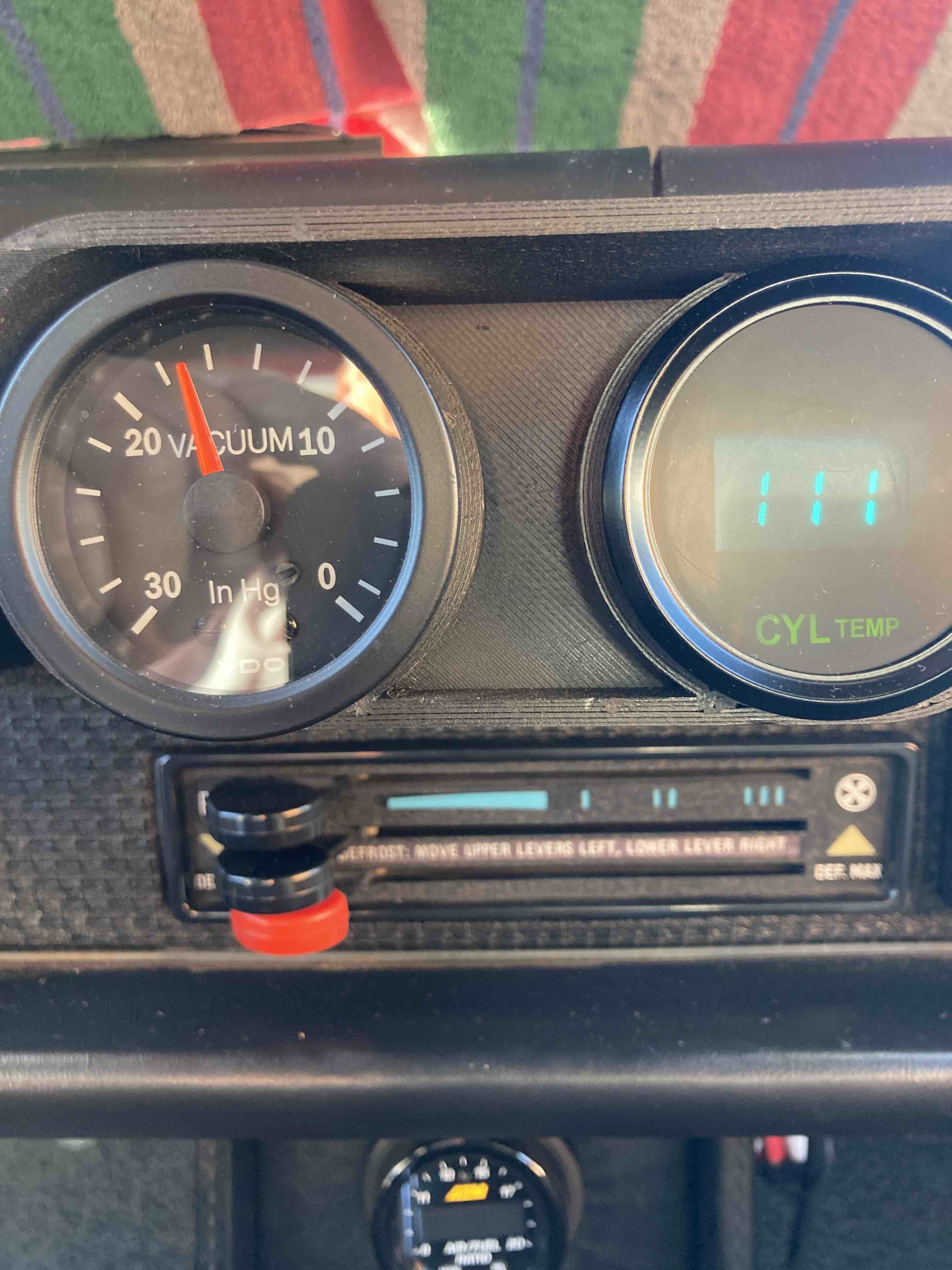

My Dakota Digital head cylinder temperature reads 111C (231F) .
It is almost 80F here today in sunny So Cal. but this seems too high for me . What would be a normal reading for the oil temp gauge?

The edge of the red zone is supposed to be about 300F.
You say you’re running 216F so there is a disconnect somewhere if you’re getting to the red zone in 30 minutes of street driving.
Get your smog test but you should get this figured out before extended driving.
See top right graphic for approx temperatures with 200c sender.
Does gauge work properly (ie all the way to the left when cold)?
Have you verified wiring? The wire from the sender should not have any DC voltage on it. Should be high resistance when cold and rapidly decreasing resistance as oil warms up.
What size oil pump are you running? Do you know your oil pressure?

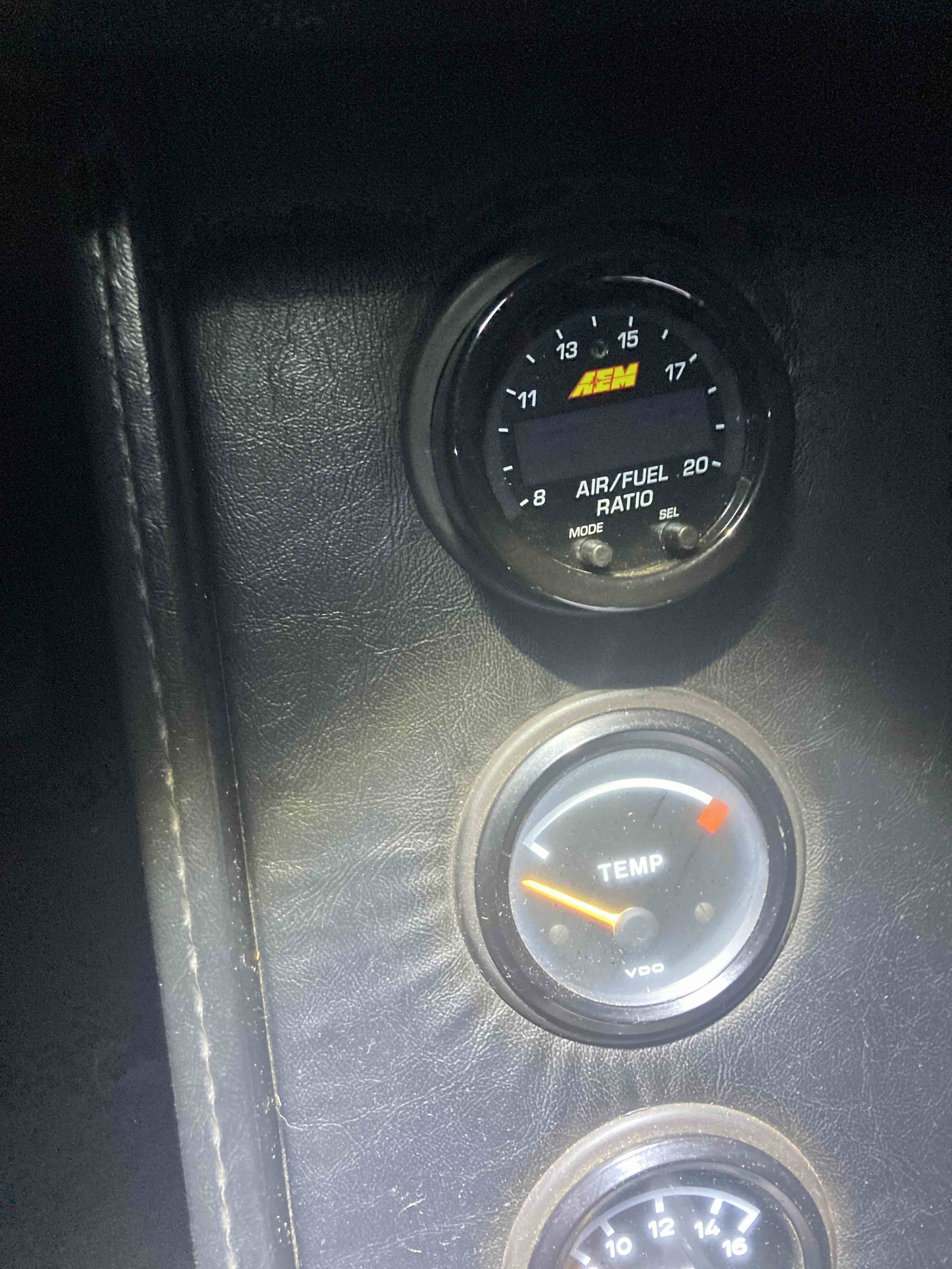

Hers a photo of the gauge without power on it and one with power (the car has been off and in the garage for almost two hours now .

When the engine is cold (as in overnight cold) it should be just like you’ve shown below
So on a surface level - we know the gauge seems to have full travel.
When it’s cold and you first turn the key - the gauge shouldn’t be moving significantly. Ie should still look like photo below.
There’s so many variables here and some that are unknown (like oil pump size), etc. it may take a while to work through them.
