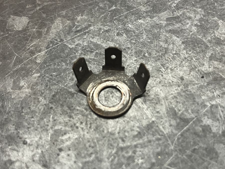

Would like some help… Three sets twin white wires 74 2.0 D-Jet harness I believe are the ground wires.Does anyone have a picture of how this works TIA Dennis

They connect to a trispade terminal which mounts to the upper engine case, rearmost case bolt.
