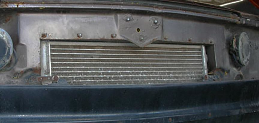

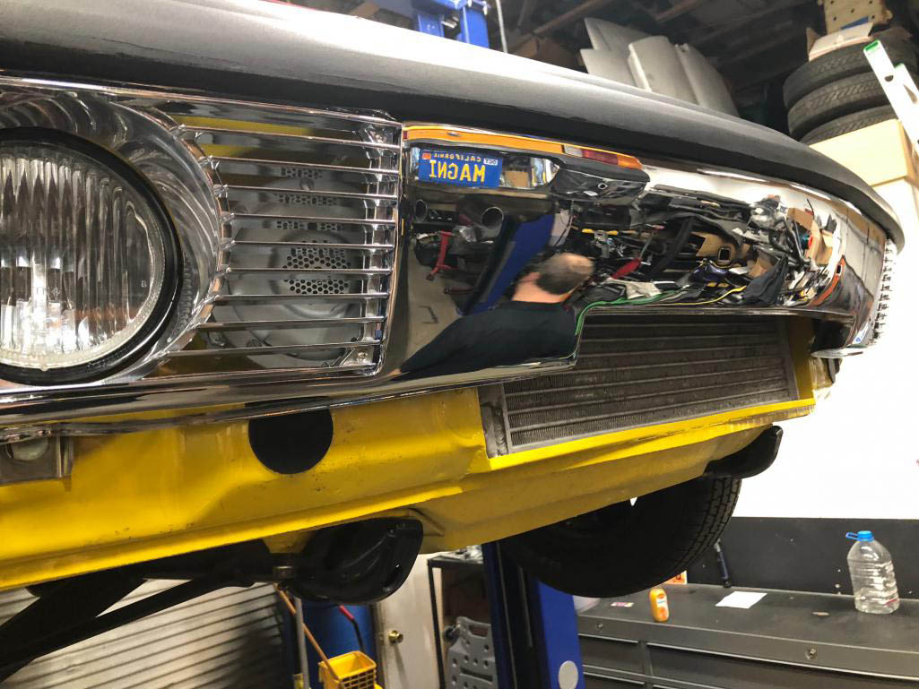

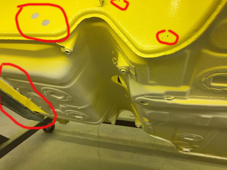

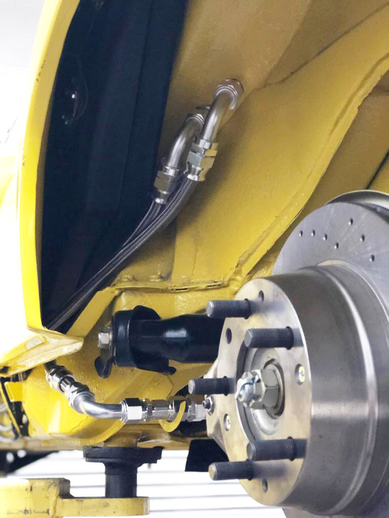

OK, my 6 number 41, when I got it, had this type of oil cooling up front. PMB kept that system just cleaned it all up. Trotman Thermostat, AN fittings with braded SS lines, cutout on the Floor like the GT and 916 cars had (note the red drawings) The bumper was opened as shown (the PO had just the air flowing through the fog light grills and that was enough air to keep it cool. It had a 69s 2.5 short stroke engine that was in there in the 70s, That Engen was reunited back to the 911s That it came down the line with.) I got my 6 Eng. case that it came down the line with and 2 Porsche guys ended Up very happy. I went with chrome front bumper and flared glass valance.

@pete-stevers pete-stevers
The braded lines run from the back drivers side along the drivers side, come up under the left wheel well, fastened to body and then with 90 degree AN fittings go into the frunk to Oil cooler and come back to tank in reverse way. See the red circles. If you do not want to use Bens GT lines, this is the way Trotman did it back in the day. If my set up was not in my car when I got it , I would of gone with hard lines. The two holes circled together are for the 90s. the small holes are for the bracket. Back in 07 Ben was not making the hard lines and they cost a fortune. I may have some pictures of the lines as they where but you should get a good idea how this kind of set up works.
You can get all that info from PMB as far as the size. There is more that one way to do this.
Best Bob B

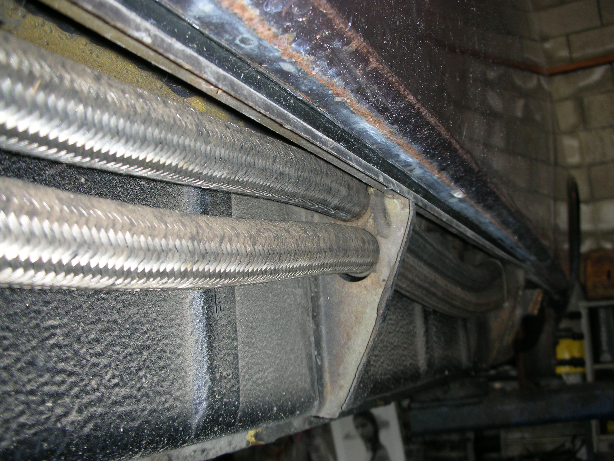

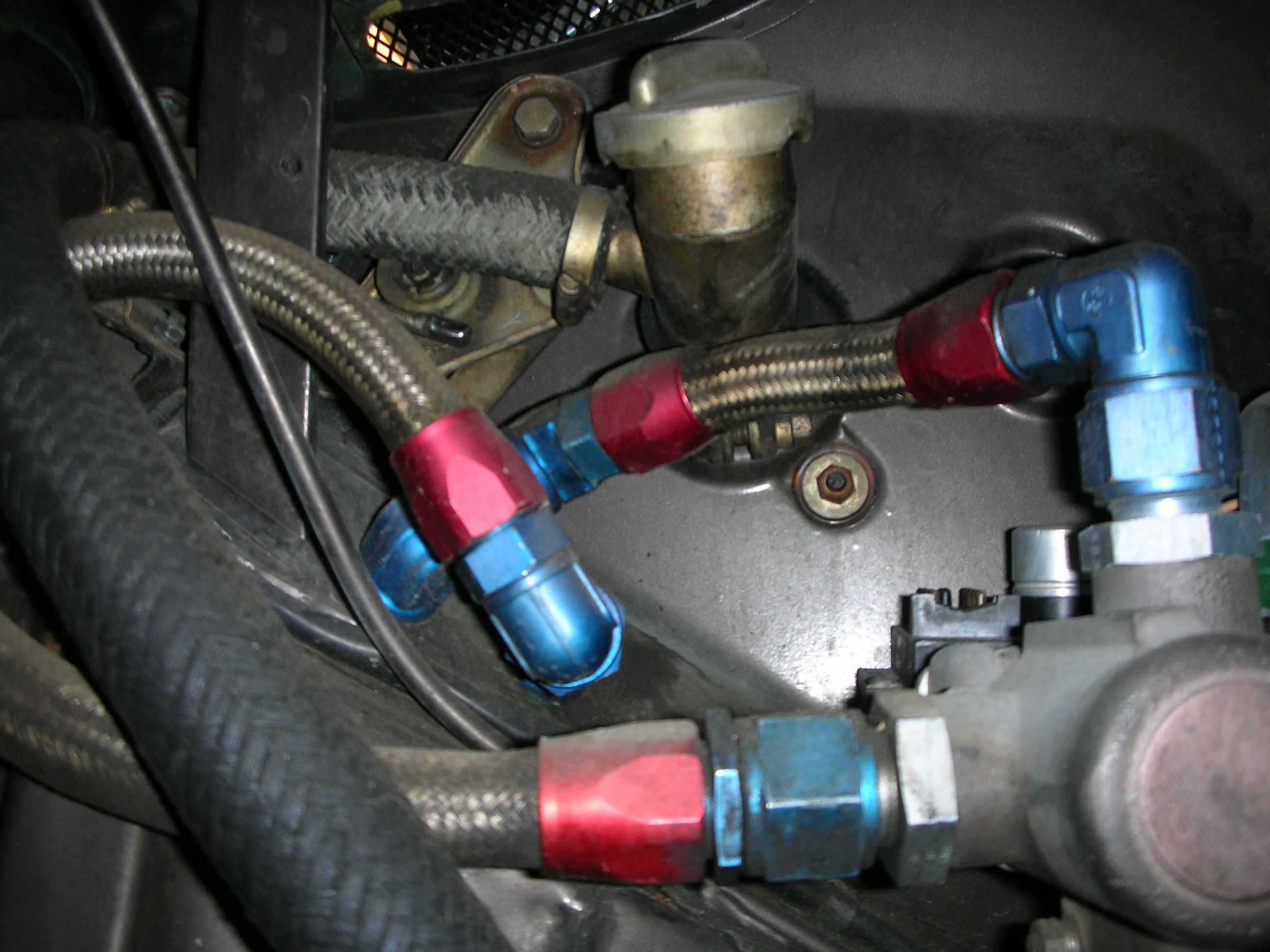

Member No.: 7,414

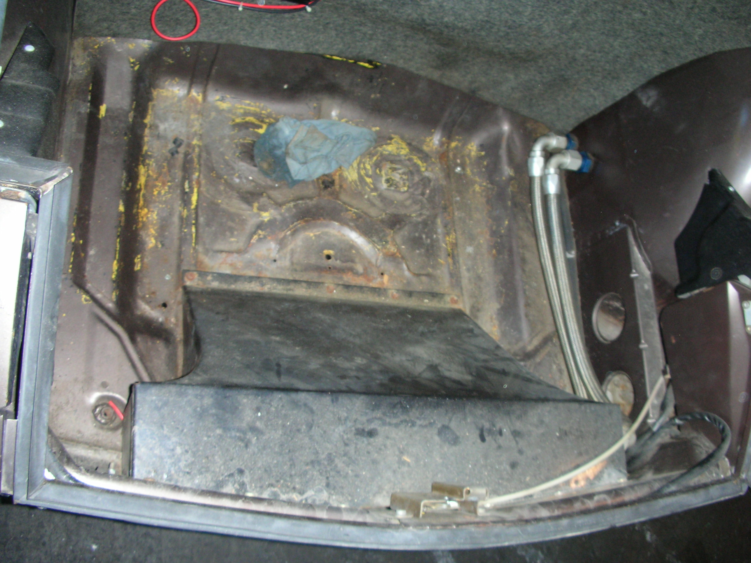

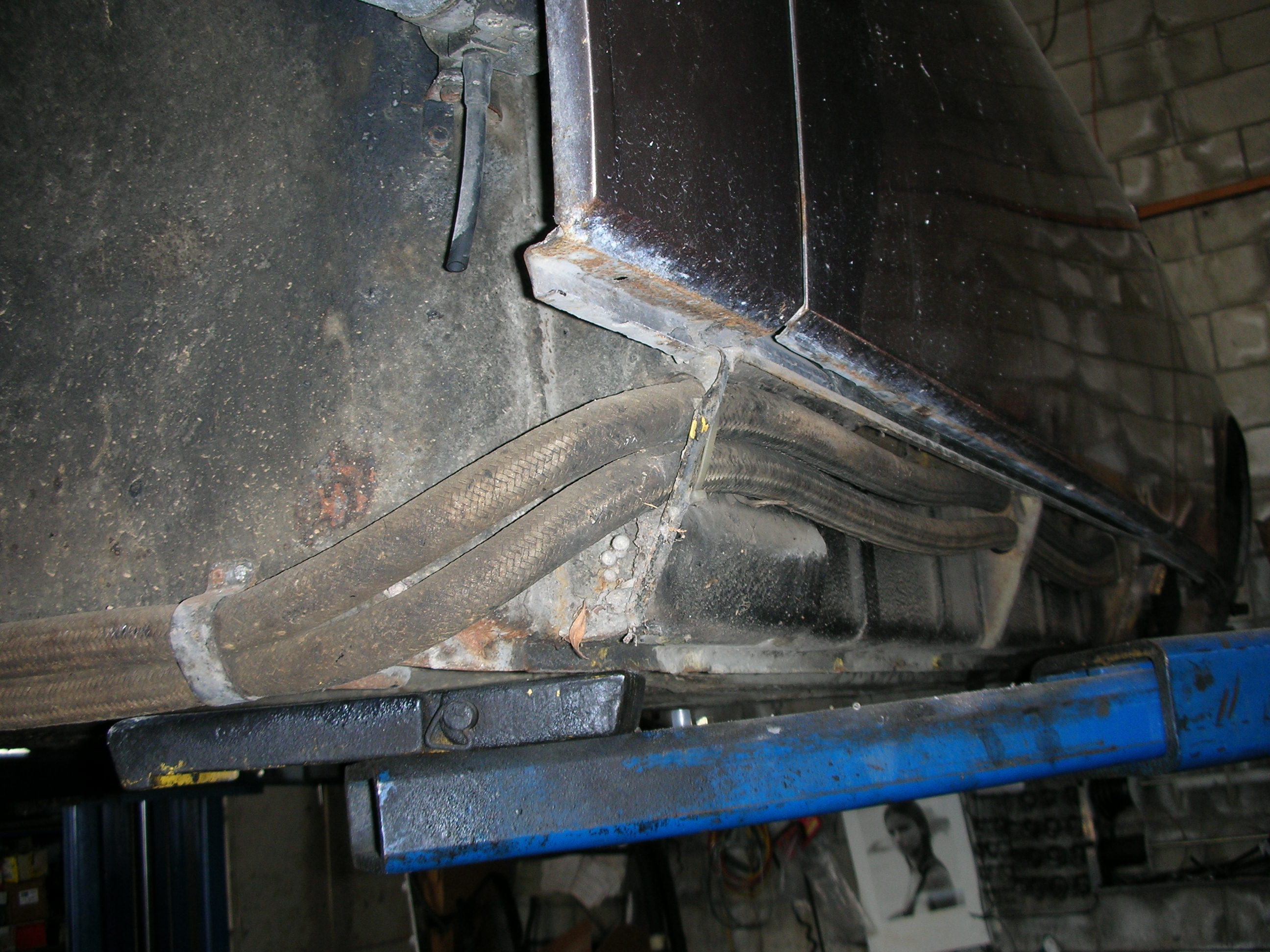

I found some 2007 pictures
Best Bob B
