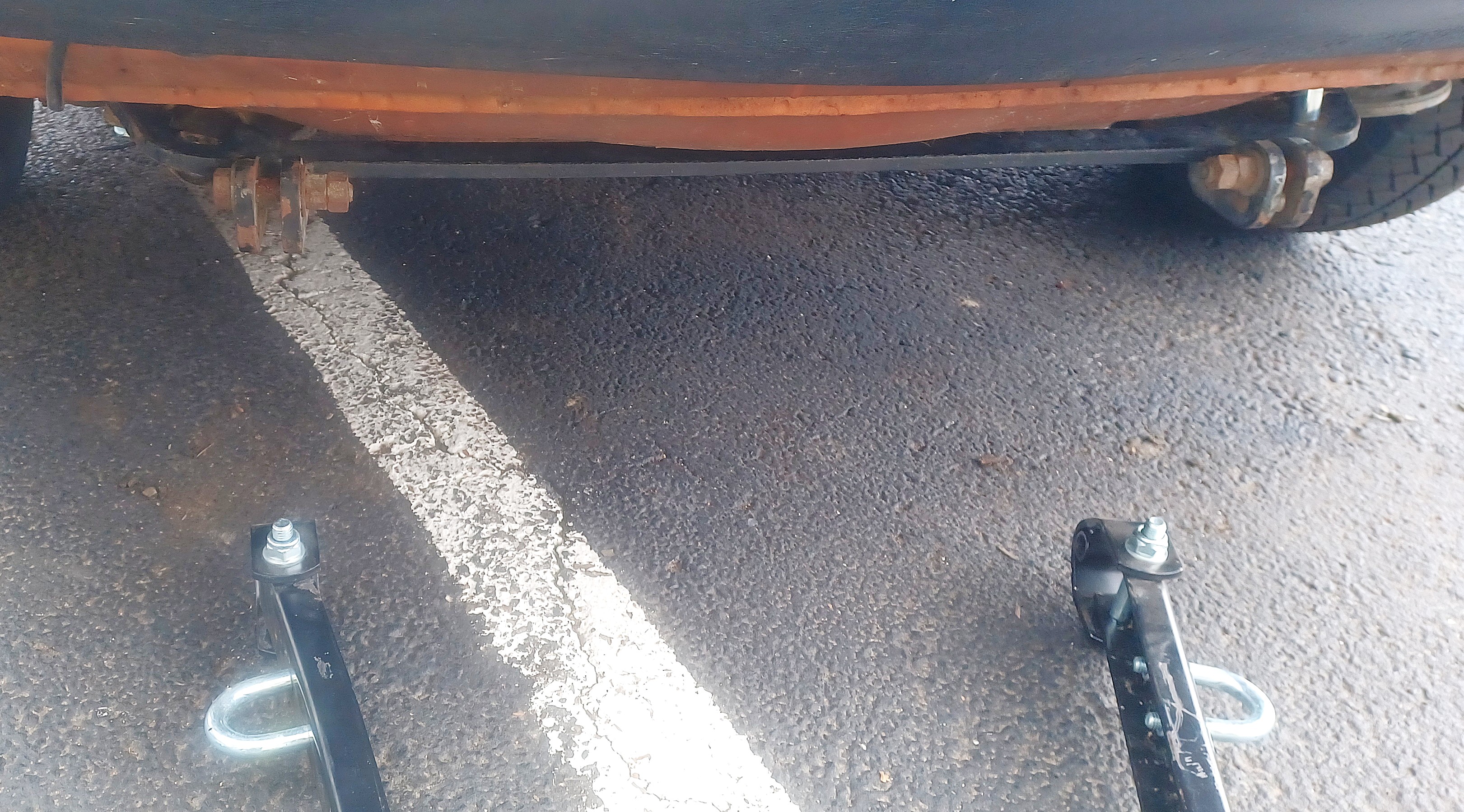

Installed the tow bar bracket I have and bought a HF tow bar.
They don't line up. (IMG:style_emoticons/default/WTF.gif)
Do I have the wrong bracket or the wrong tow bar or ????
Did HF change the ends on their Universal Tow Bar?
I'm desperate for answers, ideas, etc. as I need to move the car today / ASAP! Thanks!
