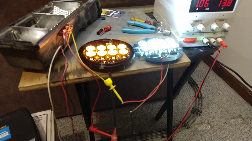

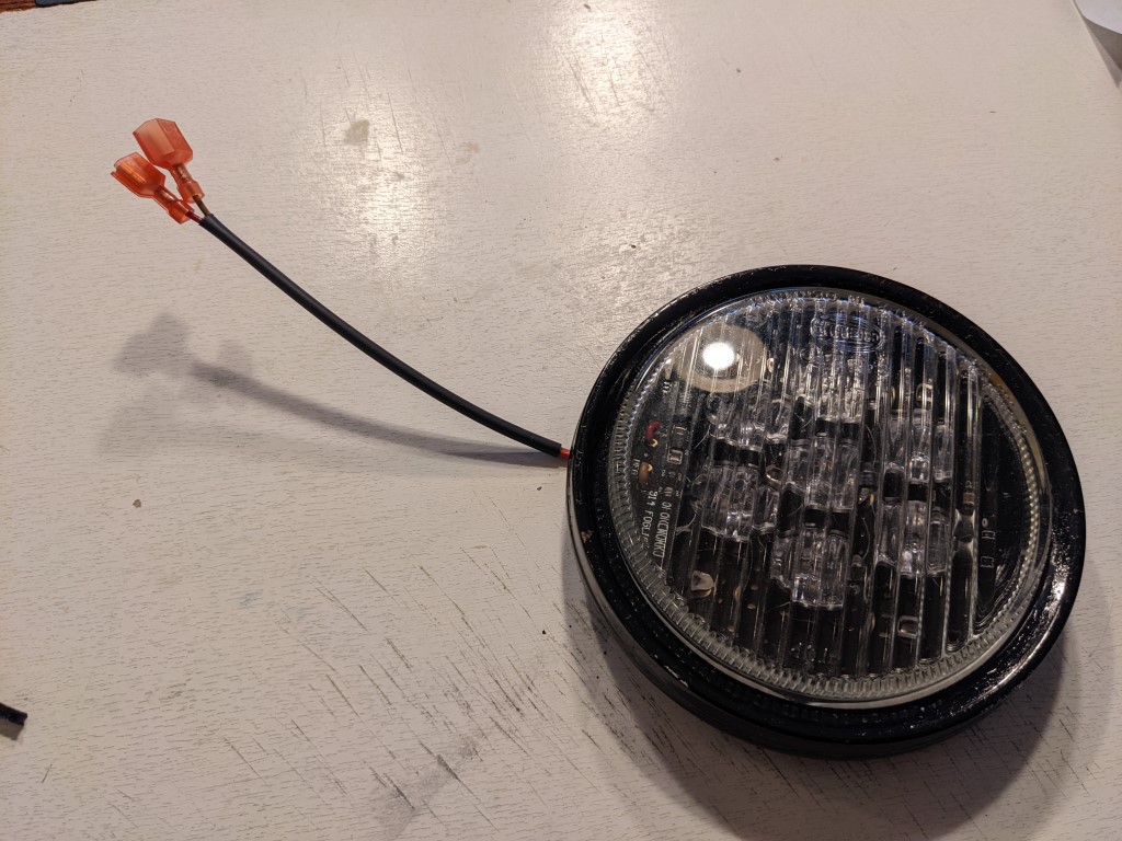

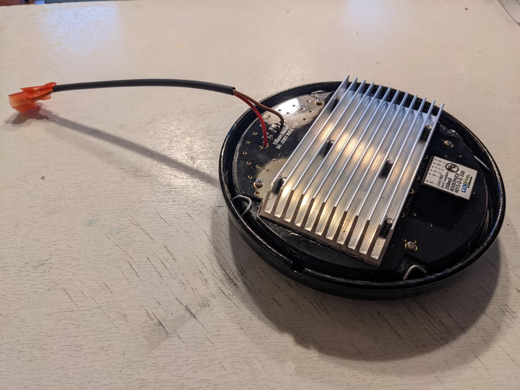

QUOTE(TINKERGINEERING @ Dec 31 2025, 11:36 PM) *
I need to figure out the wiring trickery if I go LED on these.
My foglights connect up to the OEM wiring. No changes necessary. They are about 2x as bright as OEM bulbs and burn 8W each compared to 35W for the OEM.

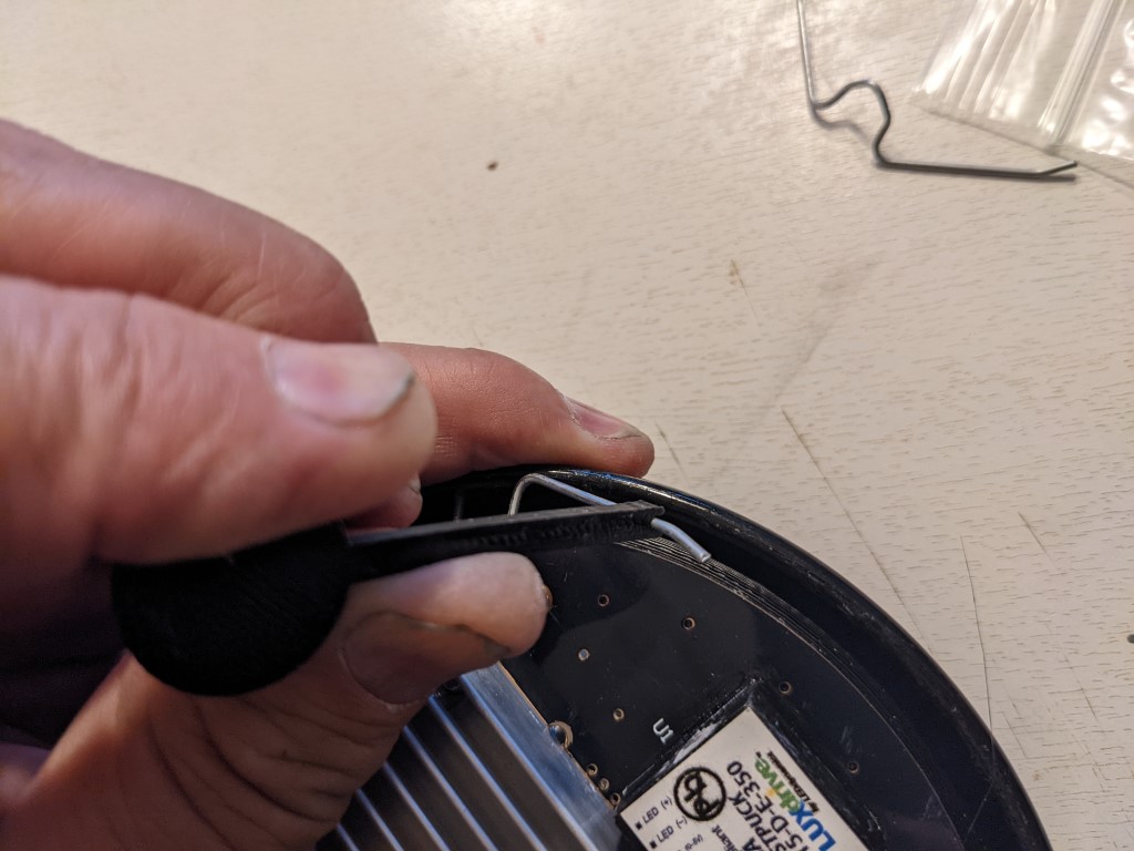

The boards replace the bulb, socket, and reflector and attach to the original lens and bezel using the OEM clips.

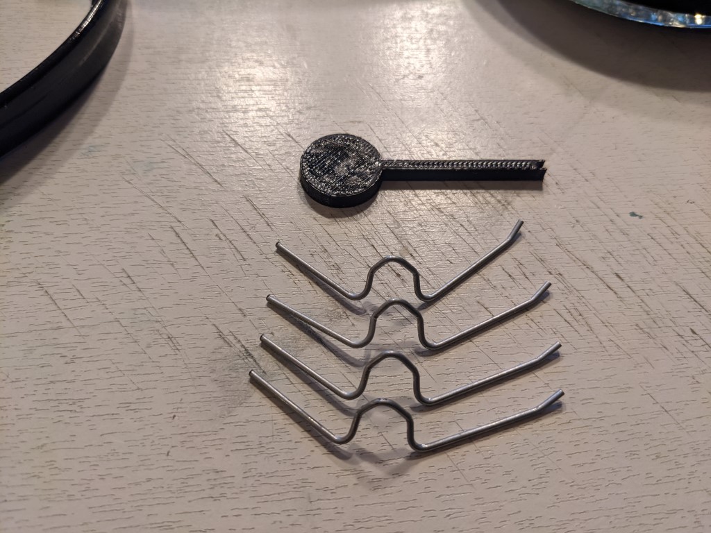

I provide a little tool to assist in installing the spring clips.
