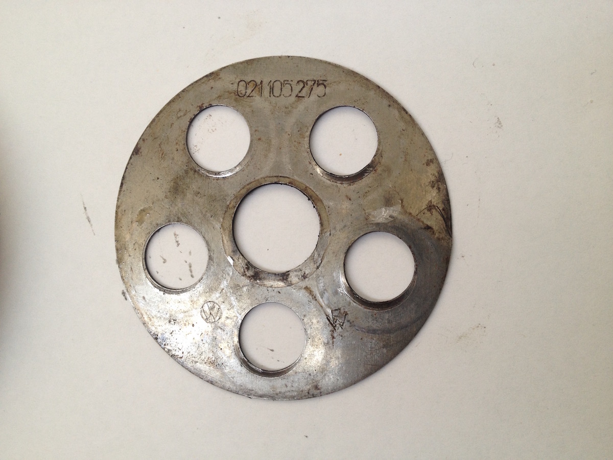

@JeffBowlsby - check your flywheel washer while you have it all out.
if its got the VW insignia on it 99% means its a production line item.
and flywheel has never been off.
spare parts washers only had the parts manufacturer emblem on them.
that the strange little mark to the right.
