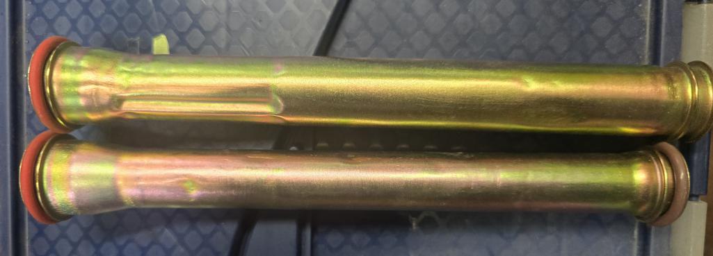

The last few times I bought them they were through EMPI
very light gauge metal and I would consider junk. One even had a pin hole in them
Where is a good place to source quality one?
