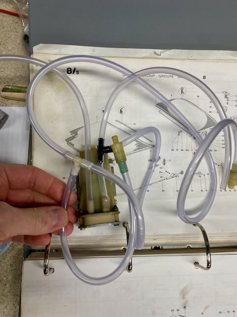

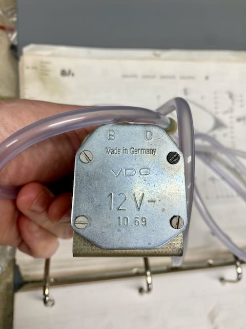

As mentioned the original pumps have date markings on the bottom plate. This is an original pump which a also disassembled and cleaned by removing the 4 cover screws.
This is a very simple gear pump so if the motor runs your pump should work fine.
Here is an image of all the original check valves and fittings with new hose.
Again the new hose will be very tight on the pump nipples and no clamps required.
I find that heating the hose end slightly with a head gun and a little shot of silicon spray will allow them to easily slip on, once cooled it will be tight and not leak.
Lastly make sure you have the connections correct at the washer reservoir, they are easily reversed.
Only one nipple has the pick-up tube running to the bottom, this has to go to the suction side of the pump, the other is the return for the pressure circuit. If the are reversed you're pumping air not water.

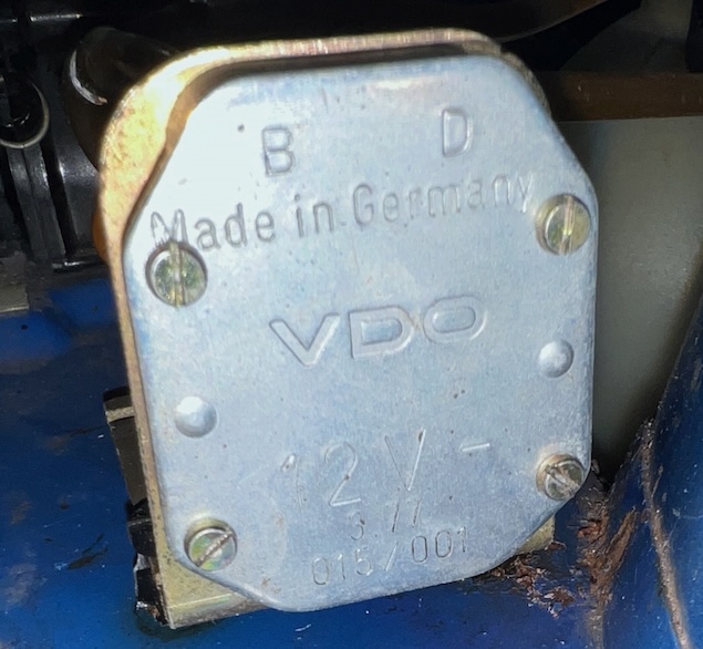

Well after all that it still doesn't squirt. I hear it spinning away, but no result. I ran it several long bursts thinking it might need to prime it self, but nothing. I pulled the hoses and put my finger on the I don't feel any suction or pressure. I assume it should be strong enough to feel something.
Maybe this was a wasted effort, as the date code on ours appears to be 3 77. So vintage, but not original to the car anyway.
