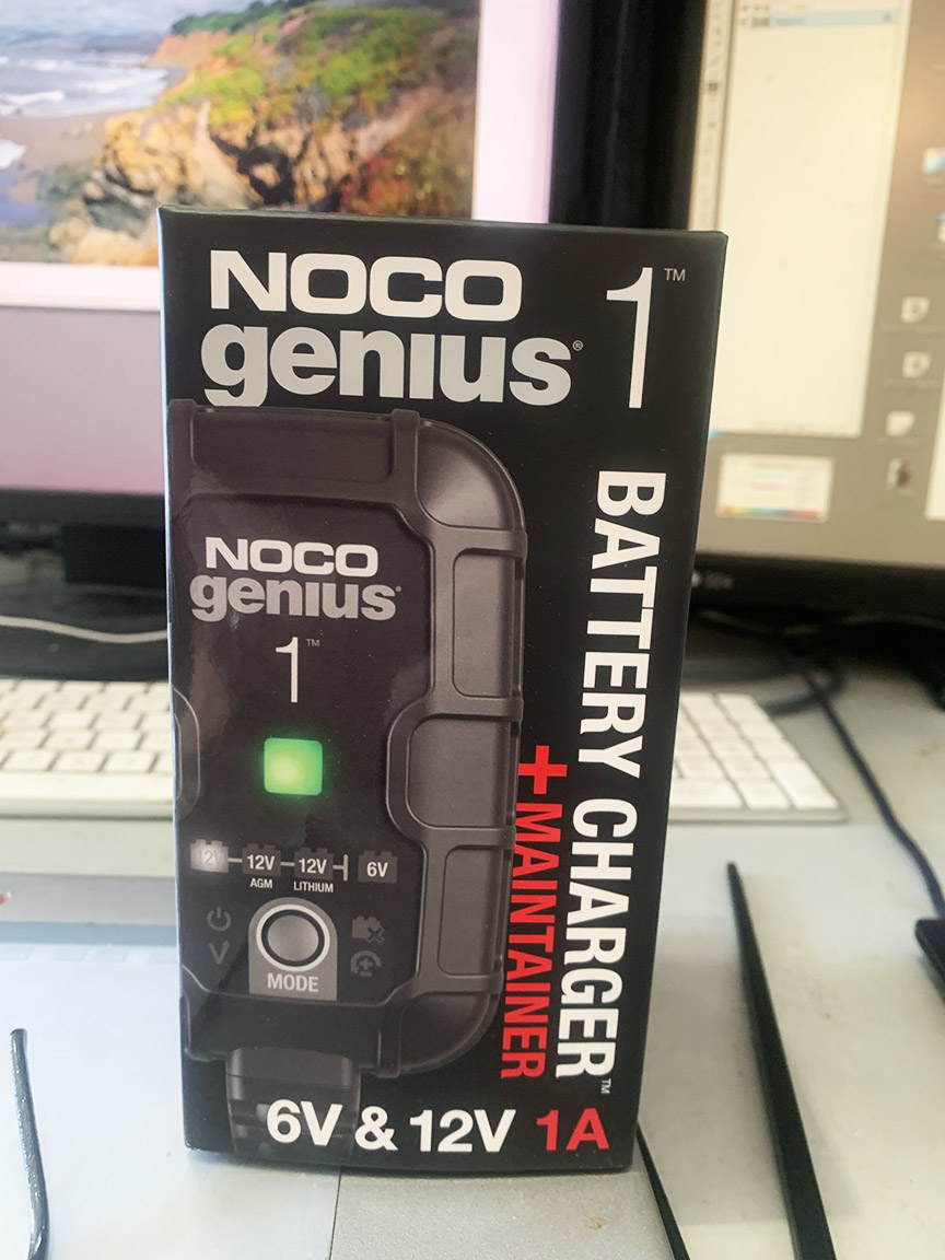

This is what Mark used to get his low batt to work
From Mark:
This is the charger that renewed the optima agm battery . It’s particularly suited to an agm type. Bout $32 from Amazon
