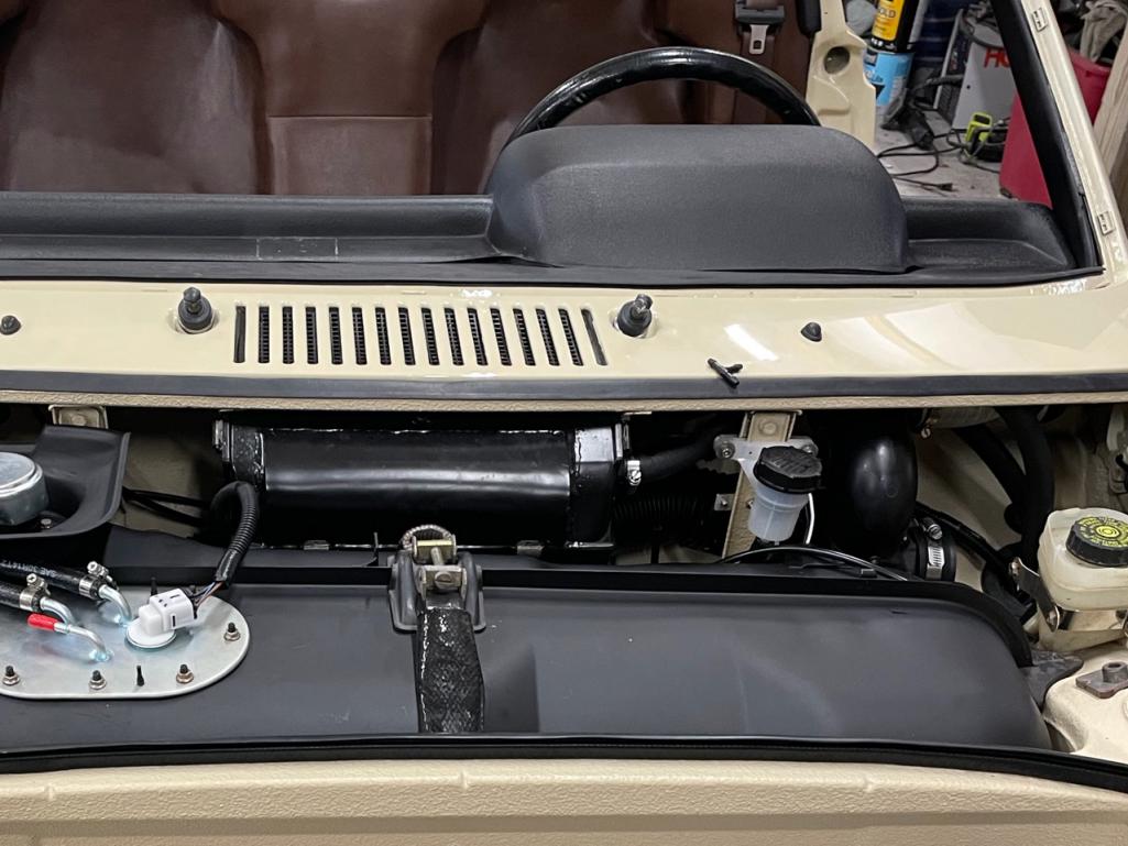

How about just mounting to the brace on the cowl (fare right). When I move my tank to the front you can see where I mounted it to ihe front roll bar.Attached Image

Hmm, the stock tank bulges toward the passenger compartment and really takes up space. I don't think I can make that work. The solution is to get the GT tank! (IMG:style_emoticons/default/biggrin.gif)

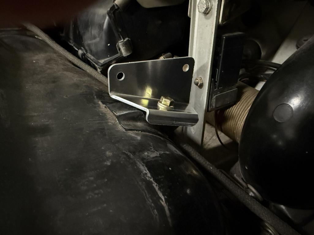

I ended up making a bracket that bolts on to the evap canister mount on the tank. It's got an anti-rotation flange on it which should keep it all in place. Pics later!

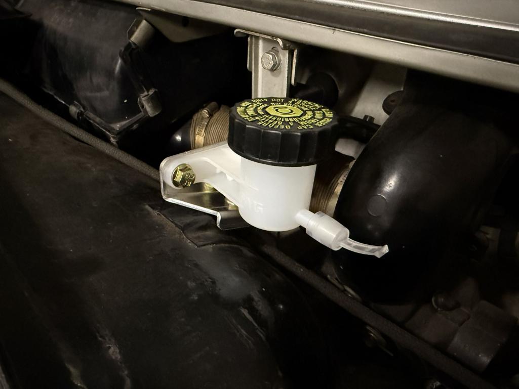

Sorry for the delay. I blame @tygaboy for plugging SendCutSend. They are just too darn easy and fairly inexpensive to have parts made!
For anyone that wants to mount their reservoir like this, I had extra brackets cut. PM me if you need one!
The bracket:
Reservoir mounted:

A "transparent" mod!
Looks "factory"
Ninja approved! (IMG:style_emoticons/default/ninja.gif)

That there is a nice, tidy solution! Good job.
