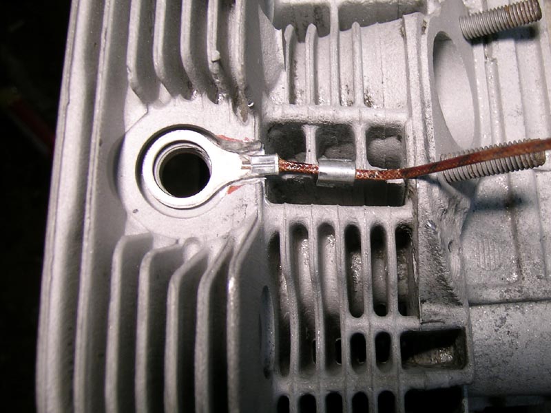

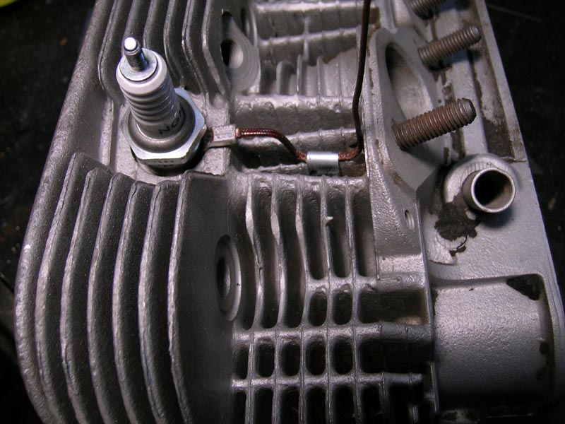

Experts say.....Mount the CHT thermocouple under the #3 spark plug. NOT the stock location that is drilled/taped. Most heads will need a little relief about the spark plug hole for the sensor to sit flat and not turn and twist during install/removal..lots of pic on this in world search

QUOTE(rfinegan @ Feb 6 2026, 08:46 AM) *
A little off the subject,
But. Having the CHT thermocouple under the plug is a PITA . Mine is all twisted up from changing the plugs.
So contrary to what the "Experts" say, next time I am putting the thermocouple under the Djet CHT sensor.
No one will really convince me that there will be a large temp difference between the two locations, they are only inches apart.

barefoot
post May 19 2026, 09:00 AM
Posts: 1,514
Joined: 19-March 13
From: Charleston SC
Member No.: 15,673
QUOTE(Olympic 914 @ May 18 2026, 06:36 PM) *
A slight mod to the head to clear the area where the TC lead starts & a clip to hold the TC in place works well. I can change plugs easily.
