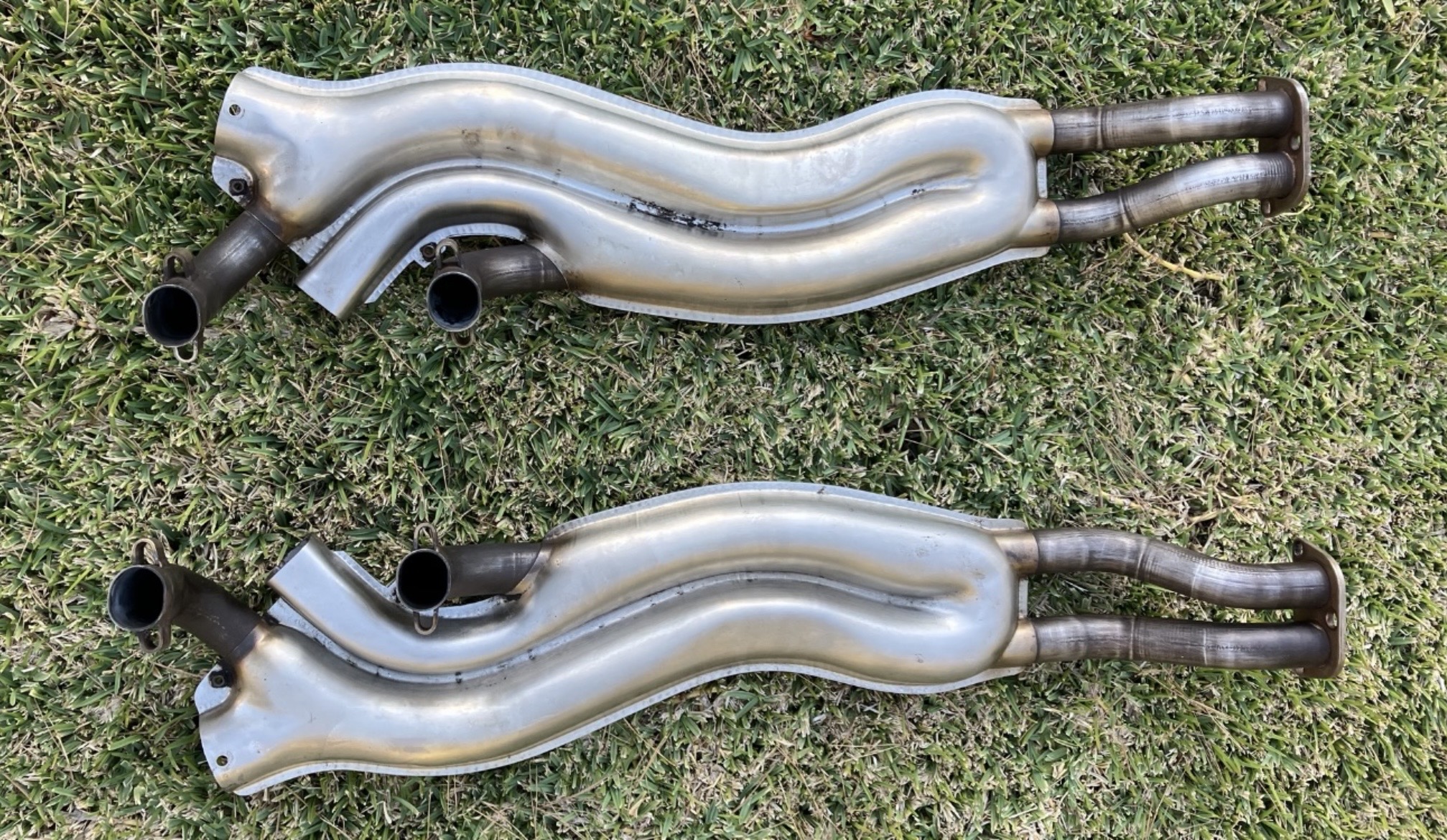

You’re local. I have a set of SS heat exchangers tight and ready for $450.00

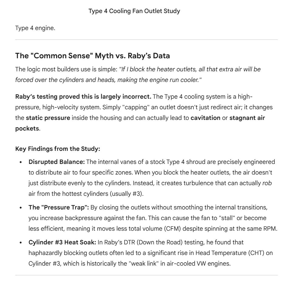

Contrairy to the general belief, closing those outlets on the fan housing would actually decrease the volume of air to the engine because you would change the shroud's internal airflow and efficiency.
This is a comment I read from Jake Raby a while back and is based on a test he did.
I will try to find his quote on the topic...
EDIT: Here is what AI provided.

QUOTE(Montreal914 @ Feb 9 2026, 09:41 AM) *
Thanks! I had suspected that this could be an issue. I wonder if Raby addressed how one could smooth the flow out in the fan housing to address this. Further research required!!! I had already capped the longitudinal ducts with spray can caps. Great idea!
