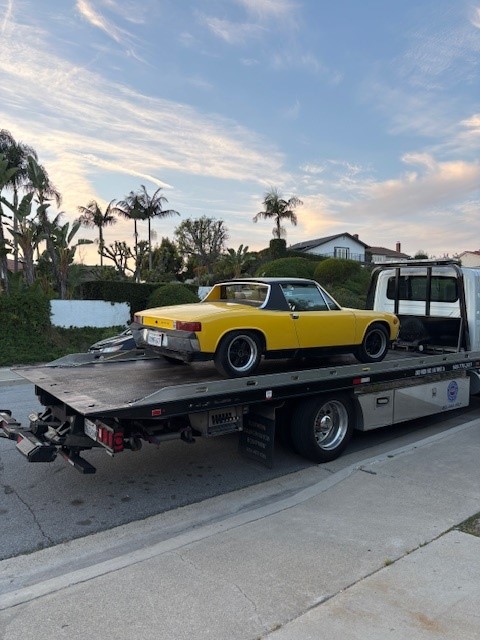

I was just telling my son that I knew the clutch cable was going to snap!
On my way home on Friday, it snapped going into 3rd gear! AAA to the rescue!
I have 2 cables on the way so I can have a spare in the car with all the connections.
Of course, this is not the first time this has happened to me and you would think I would have learned the first time....
Has anyone actually changed theirs on the side of the road before???
