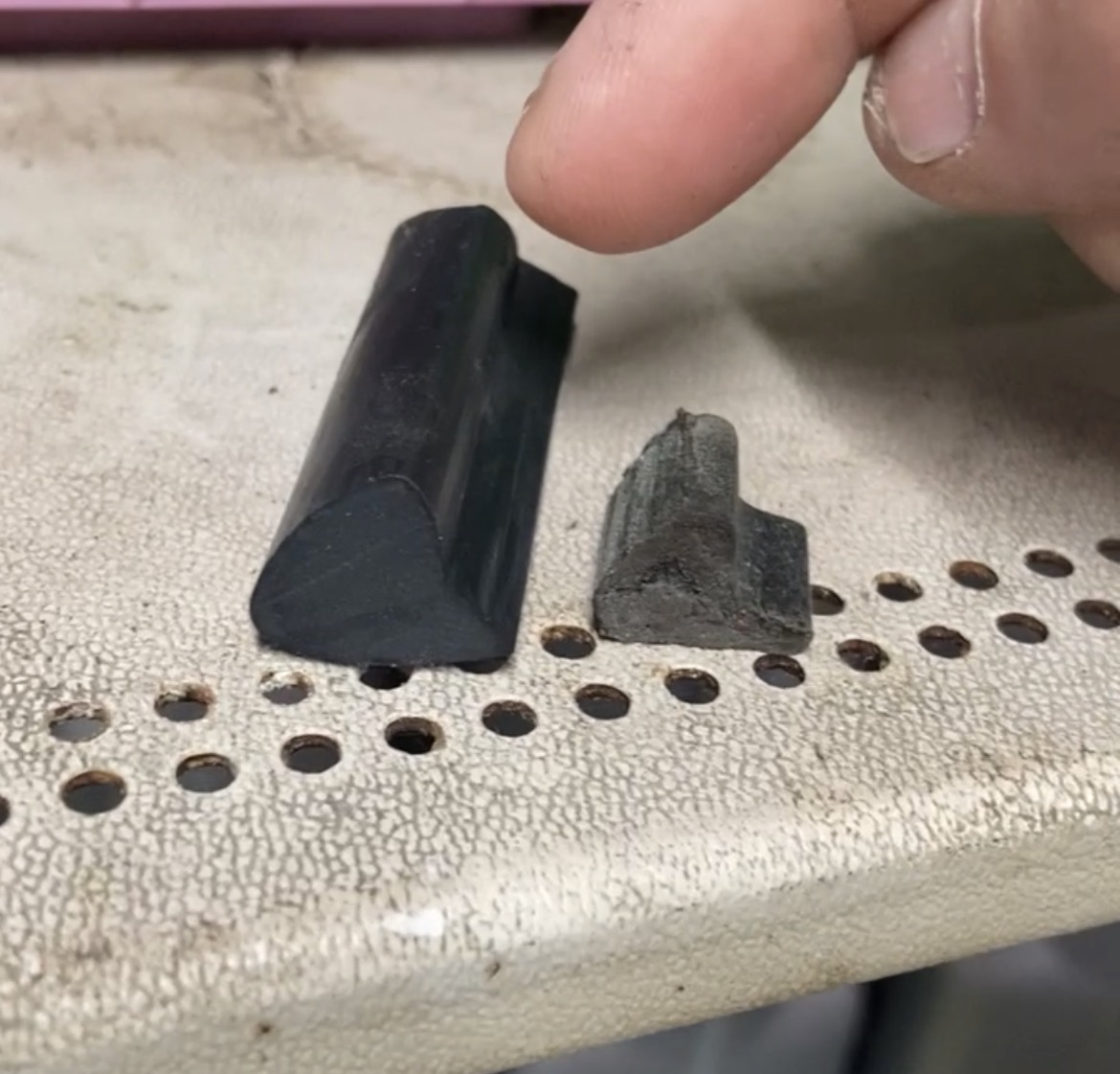

Yup been there done that.
In my case it was a combination of modification to 914Rubber parts and reuse of the lower seal. Had to remove some of the suffers in the new seals where they were too stuff vs the OEM stuffers.
Modify what you have accordingly to make it work or seek better seals (hard to find). I can probably dig out some pictures but the reality is that each car is a bit different and what worked on mine may not be the fix for yours.
Window to seal fits can be tweaked to a degree by adjusting the window frames - adjustment at bottom of doors. Similarly there is some adjustment in the targa latches that may alleviate your hard to latch issues.
With rework I was able to get pretty decent fit but not as good as original was.
Here’s an example of 914Rubber suffer on left - hard rubber and way too long vs OEM stuffer (compressible neoprene - closed cell foam). The hard rubber stuffers keep the window glass from settling into the seal properly.

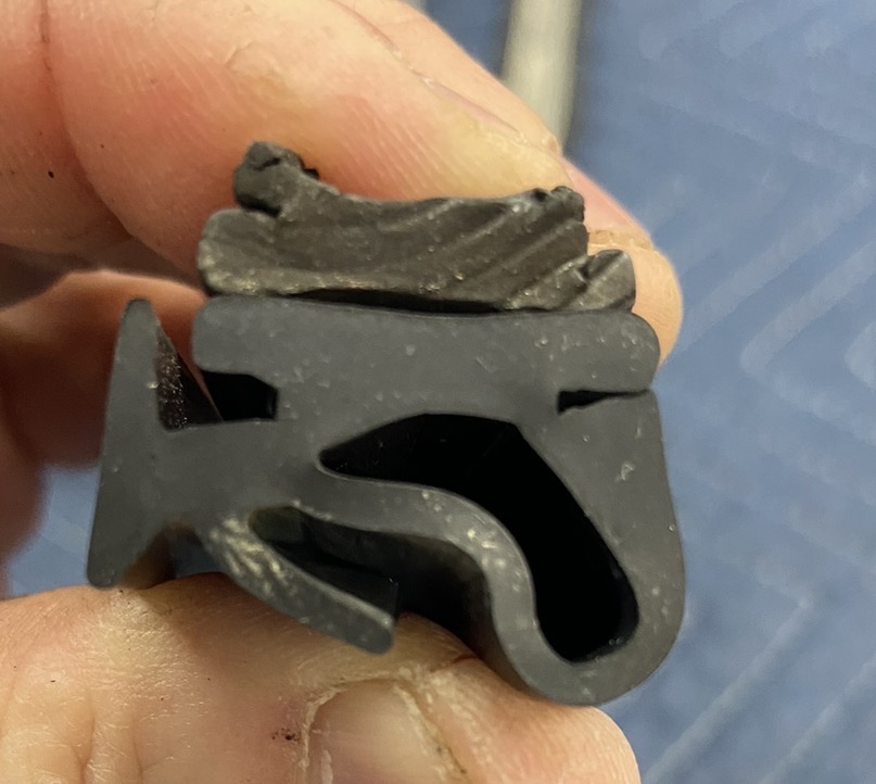

This was picture of where the lower targa seal was too stiff & too thick. Pushed the targa top up and back - didn’t allow the targa top to nest into the upper seal properly.
I tired to rework the lower seal to soften it up and thin it out (combination of cutting out rubber and using small belt sander) - I never really got it to what I wanted and luckily my OEM lower was only torn by the center block - so I reverted back to that and the fit was improved though I did have to still adjust my targa latches.

The broader problem though is the need for OEM quality lower targa, window seals, etc. based on my experience, it was the lower that really exacerbated the fit problem.
Here is a comparison of the lower vs OEM (on right). Notice how much taller the “box” section is. The OEM is also softer durometer.
measured height of the “box” OEM
Measured height of the reproduction “box”
For OP & SB914; take out lower seal - if targa fits better you know where to focus your energy
