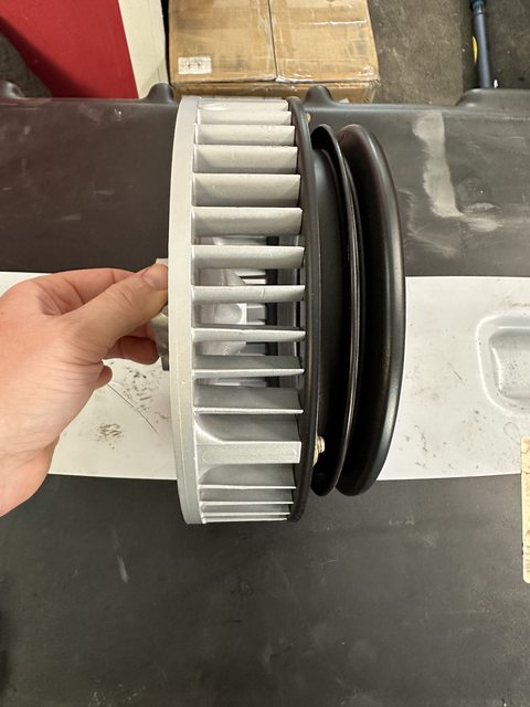

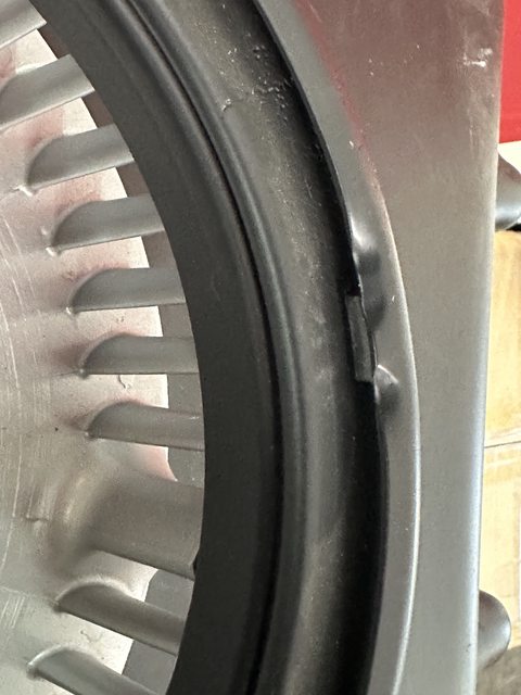

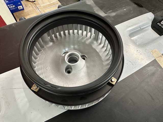

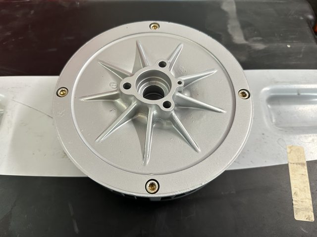

Does anyone happen know how the cooling fans were balanced from the factory?
I took mine apart to refinish (Cerakote!) and very stupidly did not make any index marks for the front "ring" and back fan. I noticed on reassembly that there is a weight crimped under the ring lip, presumably for balance. I'm wondering if these pieces were balanced independently (unlikely) or as a unit...
(IMG:http://www.914world.com/bbs2/uploads_offsite/i.imgur.com-19557-1771437363.1.jpeg)
(IMG:http://www.914world.com/bbs2/uploads_offsite/i.imgur.com-19557-1771437363.2.jpeg)
(IMG:http://www.914world.com/bbs2/uploads_offsite/i.imgur.com-19557-1771437363.3.jpeg)
(IMG:http://www.914world.com/bbs2/uploads_offsite/i.imgur.com-19557-1771437363.4.jpeg)
Any ideas from 914world on how I may find the right orientation / re-balance? My local machine shop said no dice as far as fitting it on any of their machines (ID of the fan shroud bore is too small).

I'd bet the assembly was balanced, have you sent the crank for balancing?

It’s a very good idea to balance everything in your motor that rotates. Flywheel, crankshaft, rods, pistons/rings/pins, etc. That means get that fan balanced. Have seen pictures of an exploded fan and it’s not something you’ll enjoy. Dynamic balance all of it and if your shop can’t or won’t do it, send to someone who can (DPR?).

If you took the fan apart and didn’t assemble it the exact same way then you have to rebalance the fan, I would include the hub, crank and the rest of the rotating assembly.

In addition to balance the ring has to be centered on the fan or it will rub the shroud.
Test fit it and see if it clears. If not loosen the bolts and teap the ring until you have equal clearance on all sides

changing the relationship between the hub (fan) and the pulley will affect the balance. It's possible everything will be fine, but it's a gamble. Yes, the clearance must be equal
