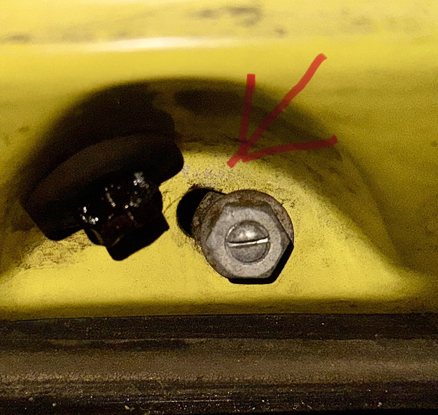

I would want to see a picture of the bottom of the rail to make sure that the adjuster is in the correct position. I hope I can verbally explain. You should have the Aluminum channel with the adjuster screwed into it with the round part that makes the window top go in and out on the outside. Of the screwed tab.
So when you adjust the In-N-Out the round part of the screwed part will push the top of the window out. If you have it on the wrong side, typically you will see what you’re looking at. Good luck.

Hi, where it bolts at the bottom, you have the in and out adjustment and a lock nut.
If you loosen that nut the hole at the bottom is a slot. It should have a little movement fore and aft.

The adjuster bolt at the bottom of the rail is in the correct position and is very loose.
I just installed these windows and have left the adjusters loose on purpose but there doesn't seem to be enough play to get the triangle window to come anywhere close to fitting.
