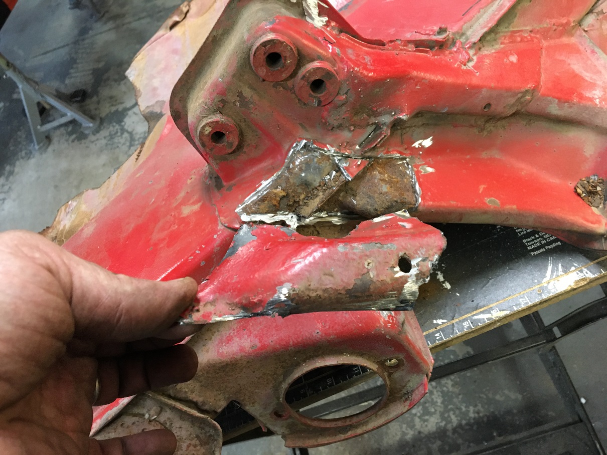

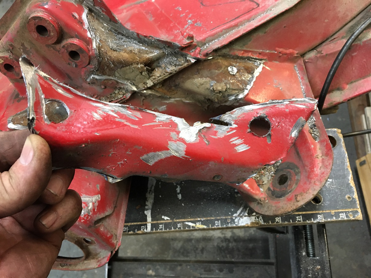

Hi Chris, These are not for the trailing arms themselves. These plates are tying the inner rear suspension console to the outer one. They need to be shaped (a lot) to properly fit.
Here you can see how I removed mine. There are two per side as there are two "beams" for lack of better description. The braces are bridging the two consoles over the flange joint from the longitudinal two halves.
Here is the longer one:
And the shorter one (the longer one still installed, reverse photo sequence):
I believe the 914Rubber kit is providing the long one in two longitudinal halves.
Hope this helps.
