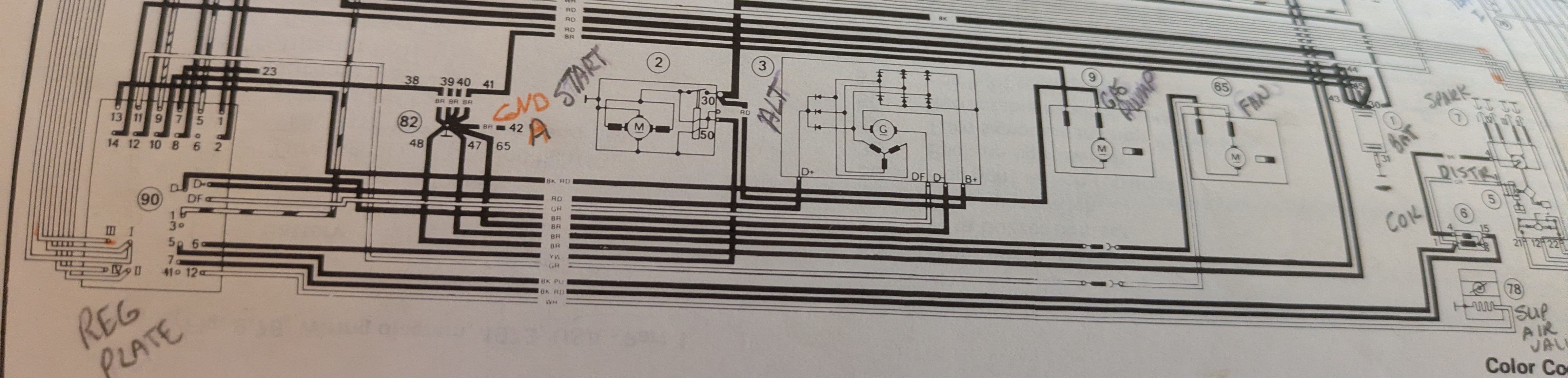

emerygt350
post Apr 18 2026, 08:38 AM
Posts: 3,520
Joined: 20-July 21
From: Upstate, NY
Member No.: 25,740
I am wondering about this point here, that lower right corner of the reg plate.
