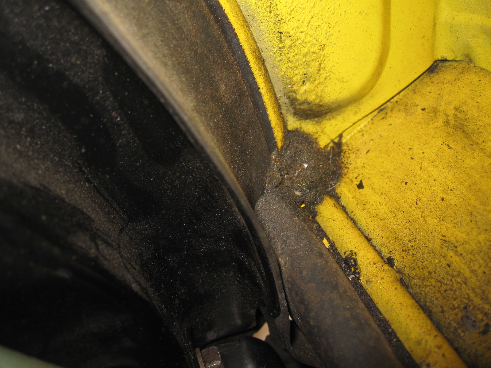

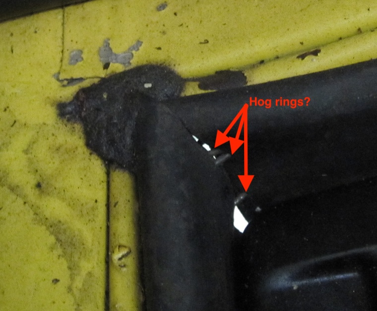

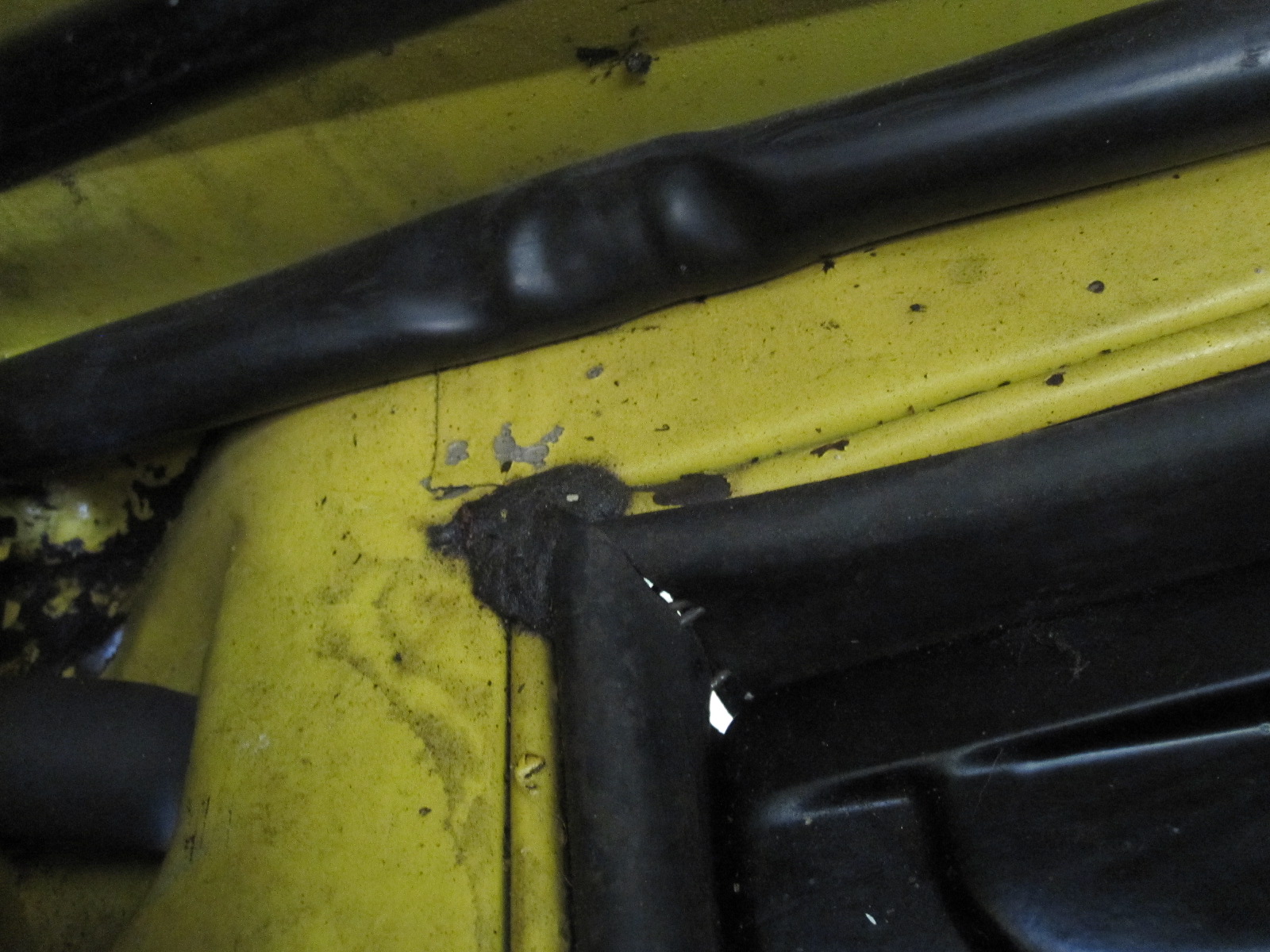

(IMG:style_emoticons/default/agree.gif) Bruce is right about the hog rings, for some reason they are never
replaced.
One more detail that I've seen on original cars. A wad of 'dum dum' to fill
openings at each corner. As pictured.

My car had both the hog-rings and the dum-dum when I pulled the original seals a few weeks back. I wasn't sure if the dum-dum was a DAPO addition or not.
I bought the hog-rings and was planning on putting them back on there before the motor goes back in.

QUOTE(rgalla9146 @ Apr 20 2026, 07:58 AM) *
@Bruce is right about the hog rings, for some reason they are never replaced.
One more detail that I've seen on original cars. A wad of 'dum dum' to fill openings at each corner. As pictured.
Can you offer more insight on the hog rings and dum dum? Do these have part numbers?
I will need to obtain them. Our engine bay was stripped clean, so I have no frame of reference.
Another case where just browsing the forum paid off with some insights I didn't know I needed. Glad @robkammer started this thread.

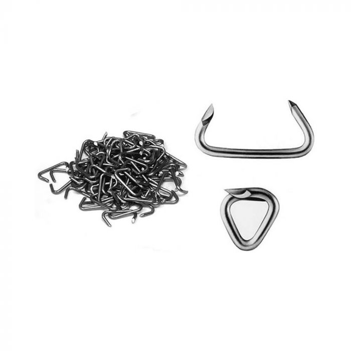

QUOTE(DennisV @ Apr 20 2026, 01:06 PM) *
I would be shocked if there was a part number for the hog rings, these are just metal clips with sharp points to grab stuff, often used in upholstery work.

QUOTE(TRP @ Apr 20 2026, 01:15 PM) *
Ted
Is this where they are installed? You just buy a Hog Ring Plier Kit and squeeze 3 rings across the joining rubber seam?

QUOTE(DennisV @ Apr 20 2026, 01:56 PM) *
Ted
Yup! The goal is to just keep the ends / joints from pulling away from the tins. The placement / number of rings doesn't appear to have been standardized. My car had two on one side and on on the other. I went to the jungle website and purchased this set.
