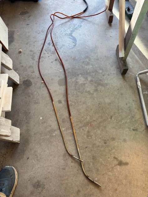

Getting into the job, I found the old fuel lines still in the car so I immediately replaced those with SS version (fairly easy to replace with the tank out and several interior components). I was surprised that they were not changed when the 6 was installed!
