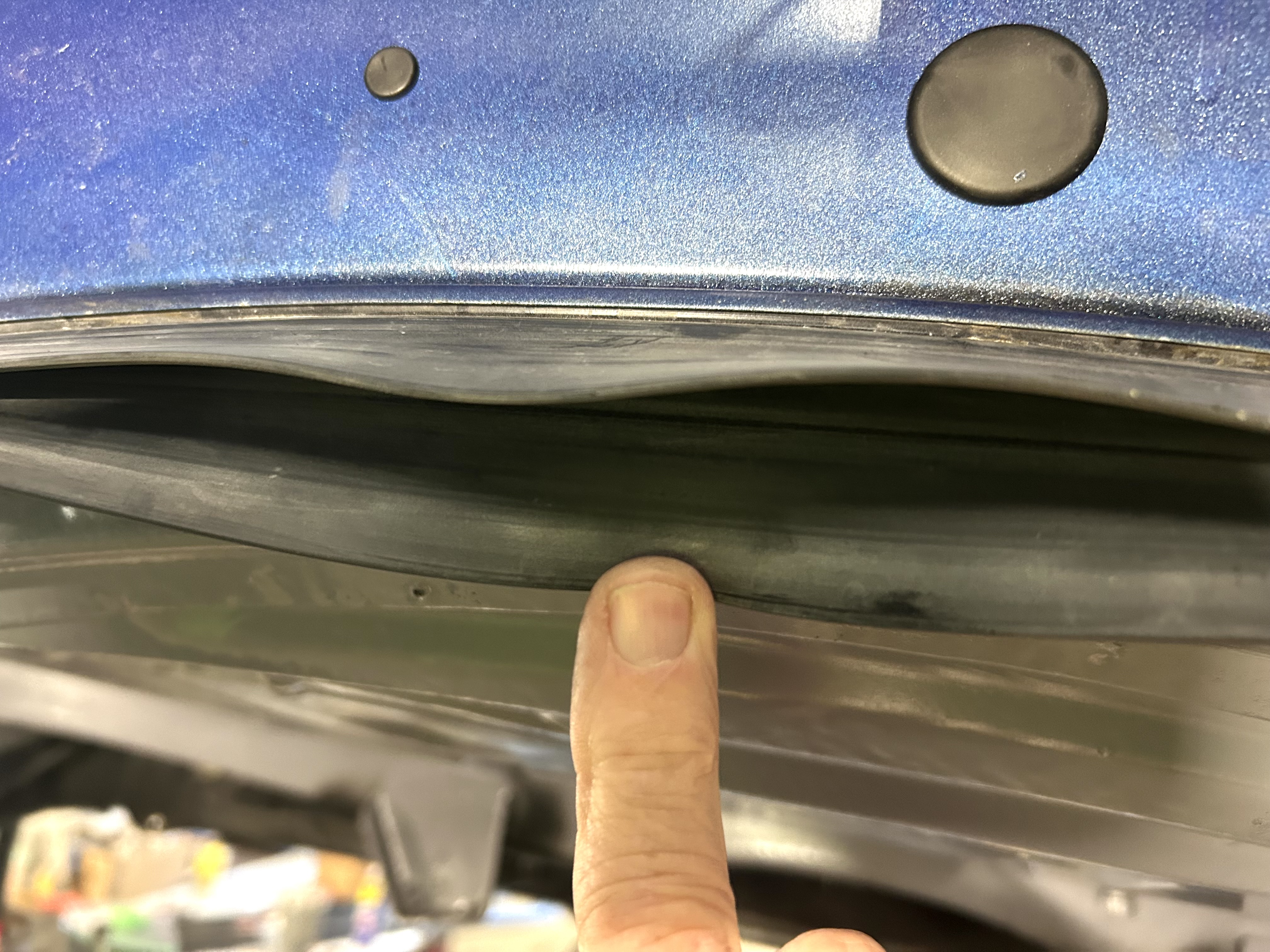

> Need help Engine Compartment Rubber, Rear piece is it facing correct?

Does the rubber flap go towards the front of the car not quite sure what it would look like in my mind if I flipped it that way. I really couldn’t find any good pictures showing it clearly.Attached Image

I believe the rear rubber seal should extend down, not forward. The rear seal has two "flaps", and I believe those flaps fit over the rear sheet metal on the engine, one in front and one behind. At least, that's how I did it in my car.
I am sure you are right! Many Thanks

So there’s multiple ways for it to sit in the track? How do you get it facing down (IMG:style_emoticons/default/confused24.gif)

Yep thats correct, I used a NOS T2 bus one I bought in my country ,side rubbers came from Pelican back then , make sure you work the seal in the groove and don't cut it too short , you can cut it back but not make it longer !!,cheers.

Always fun to have to do a job a second time. At least it was just on the backpiece.Attached Image
