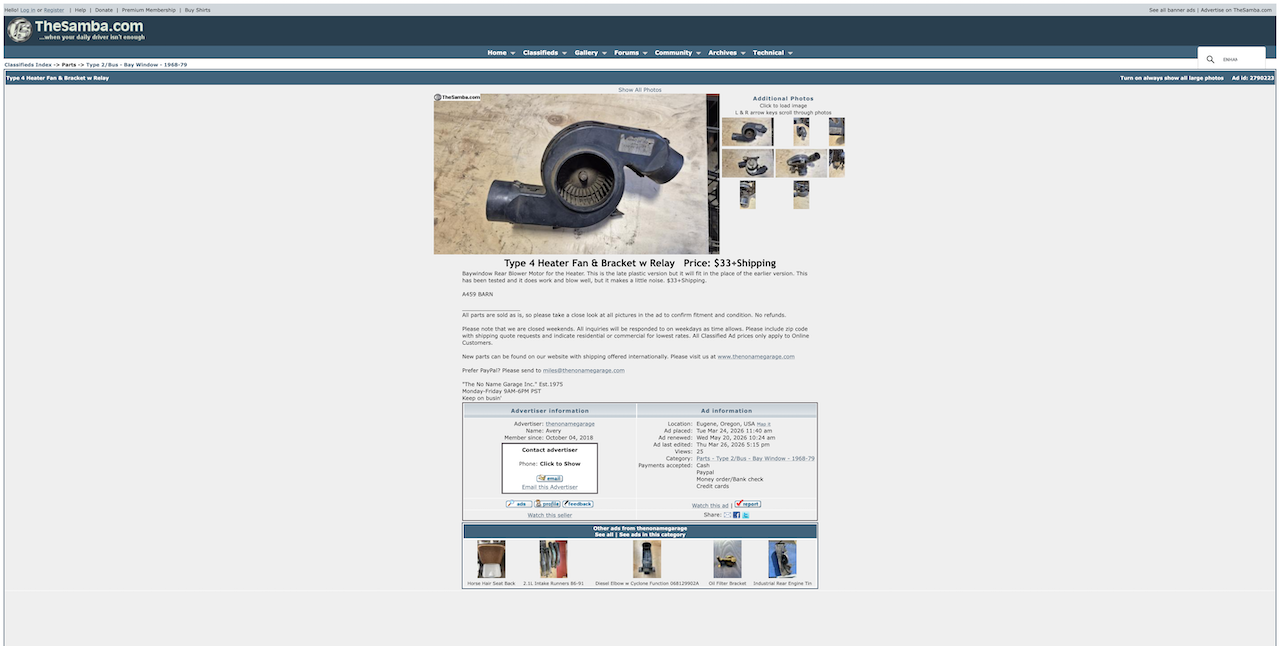

I might be able to just pull the motor out of this and toss it in the original housing.

A option for you
