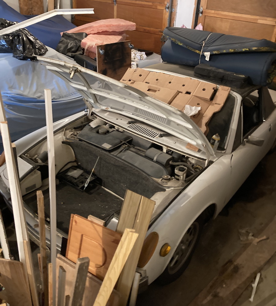

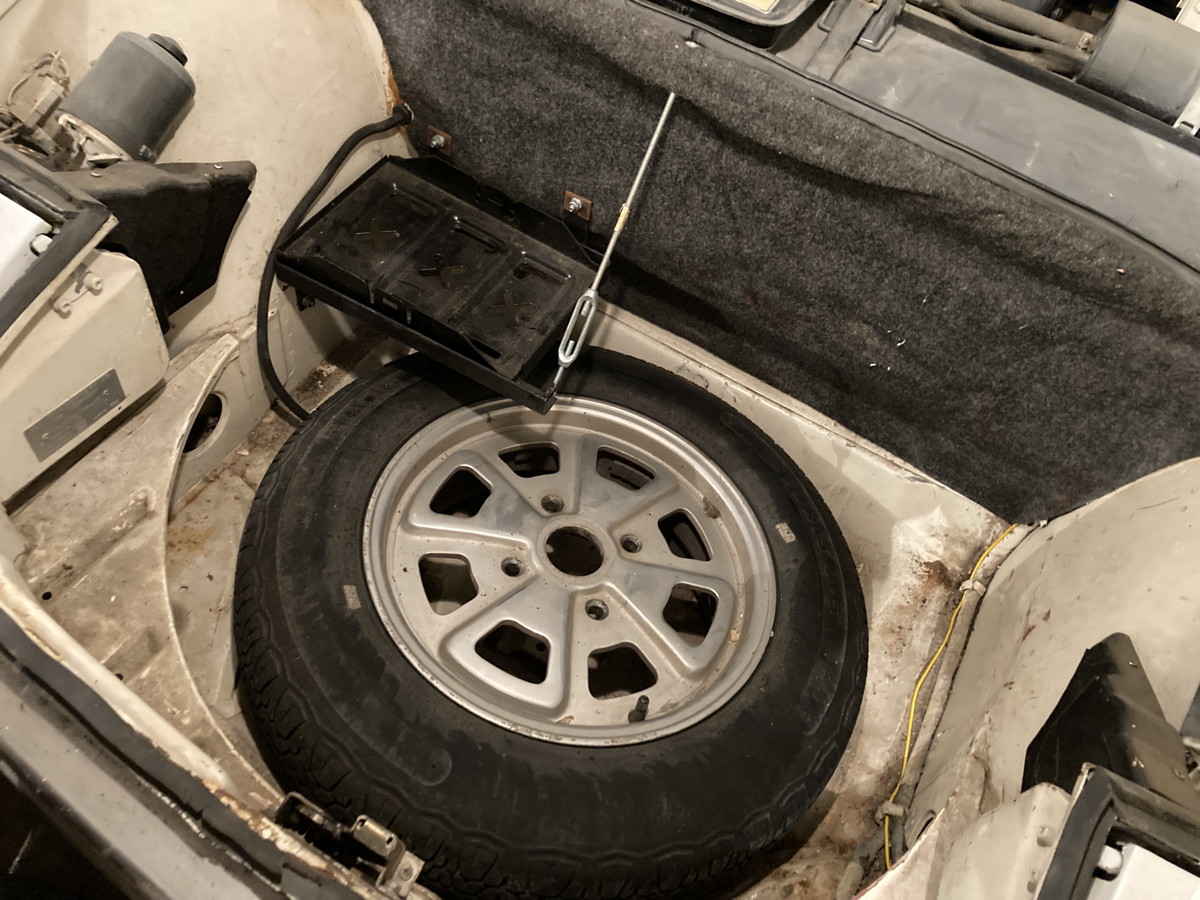

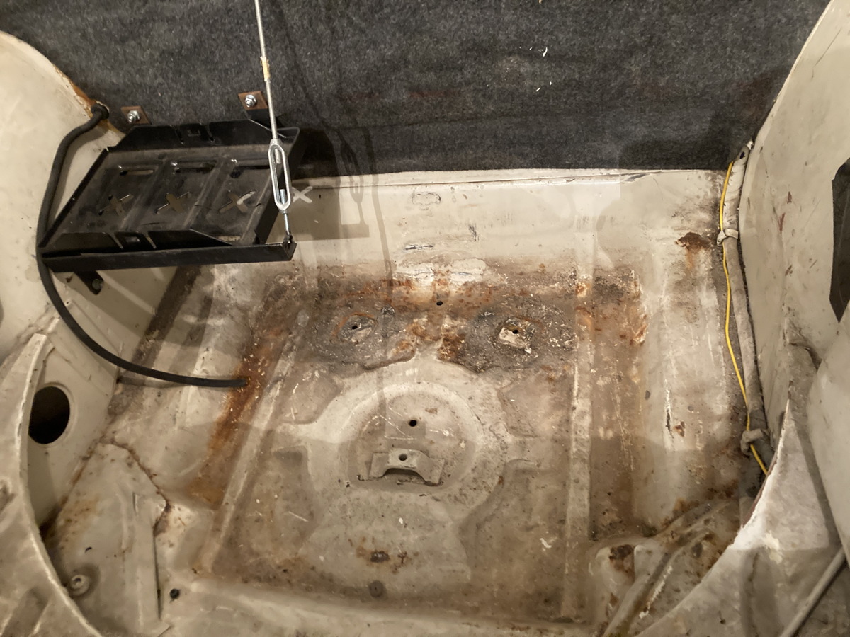

As promised, here are some pictures.

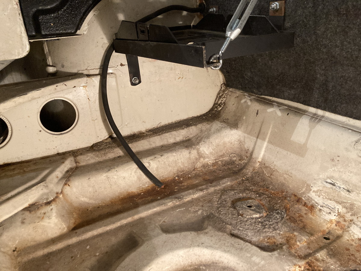

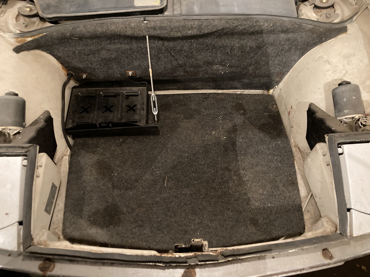

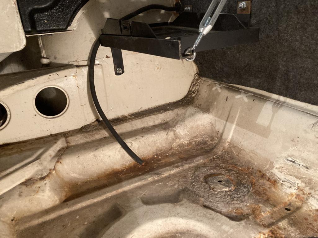

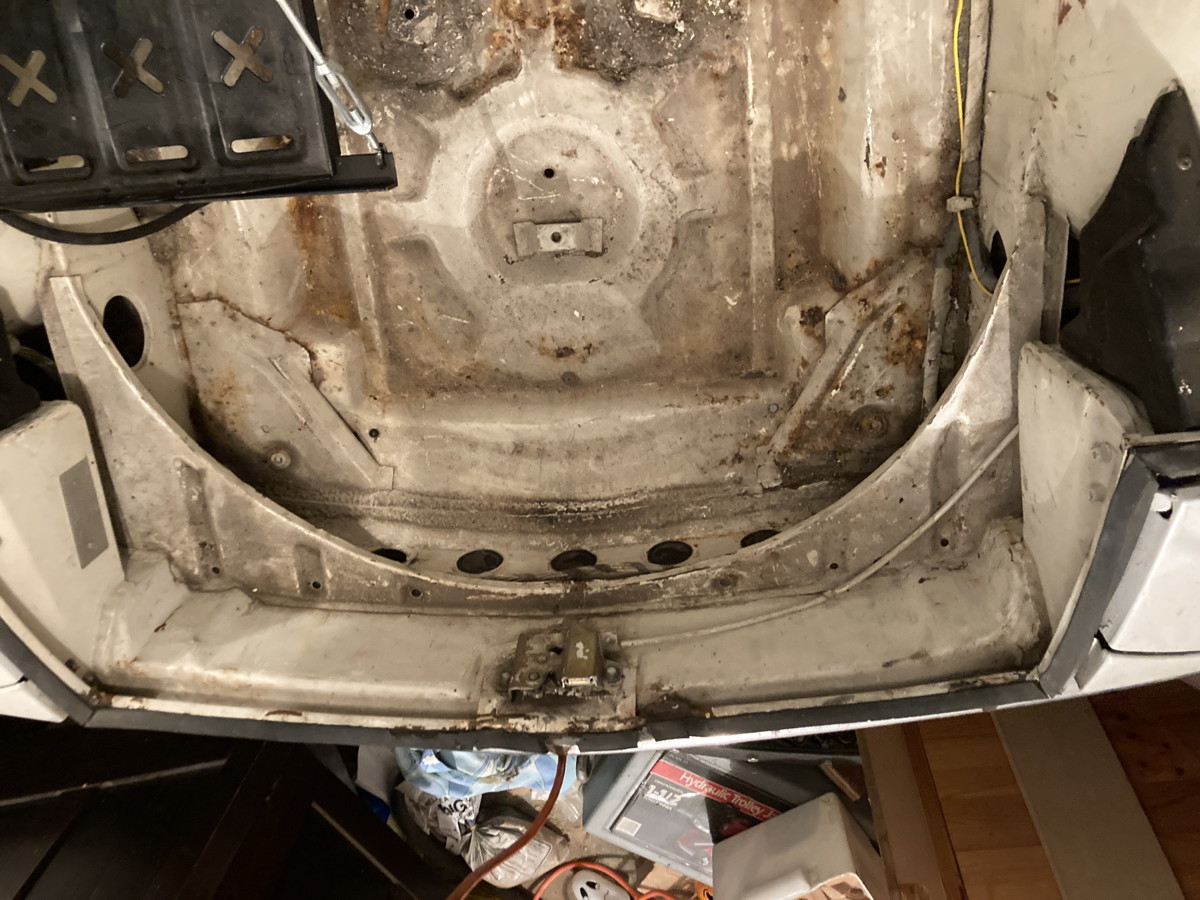

First, so you understand the absolute mess that I have in my garage right now. Three cars in a two car garage, and junk piled everywhere. Leftovers from woodworking projects, and miscellaneous furniture left over from moving two elderly family members from their homes to seniors homes. The entire garage is a tripping hazard, and my first job is to get rid of the junk.
I managed to wiggle myself to the front of the car and took some pics of the frunk. These show the battery bracket that I installed for the possible relocation of the battery.

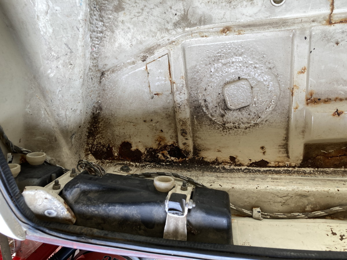

Some closeups of the inside corners. I'm hoping the rust is mostly surface rust.

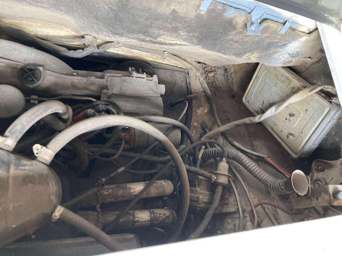

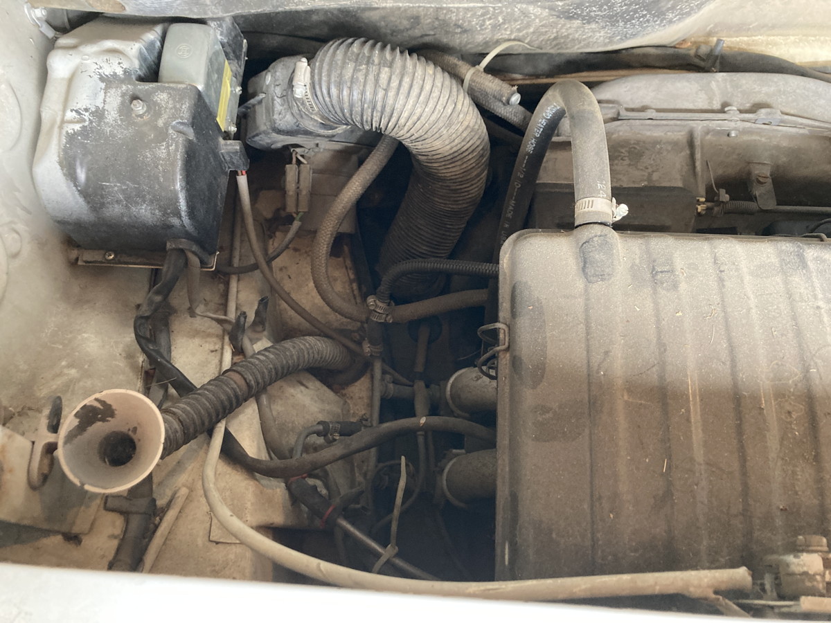

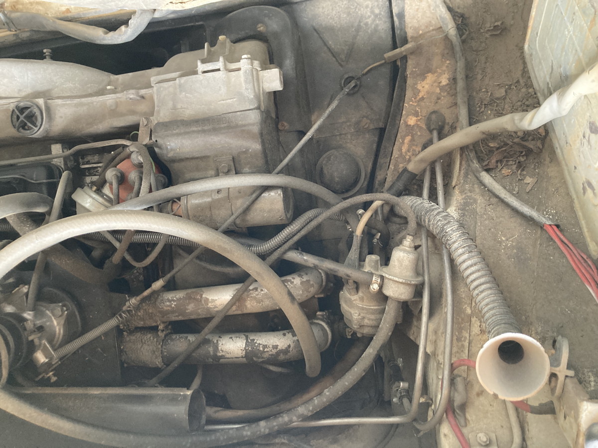

Engine bay pics
Note battery mount has been removed.

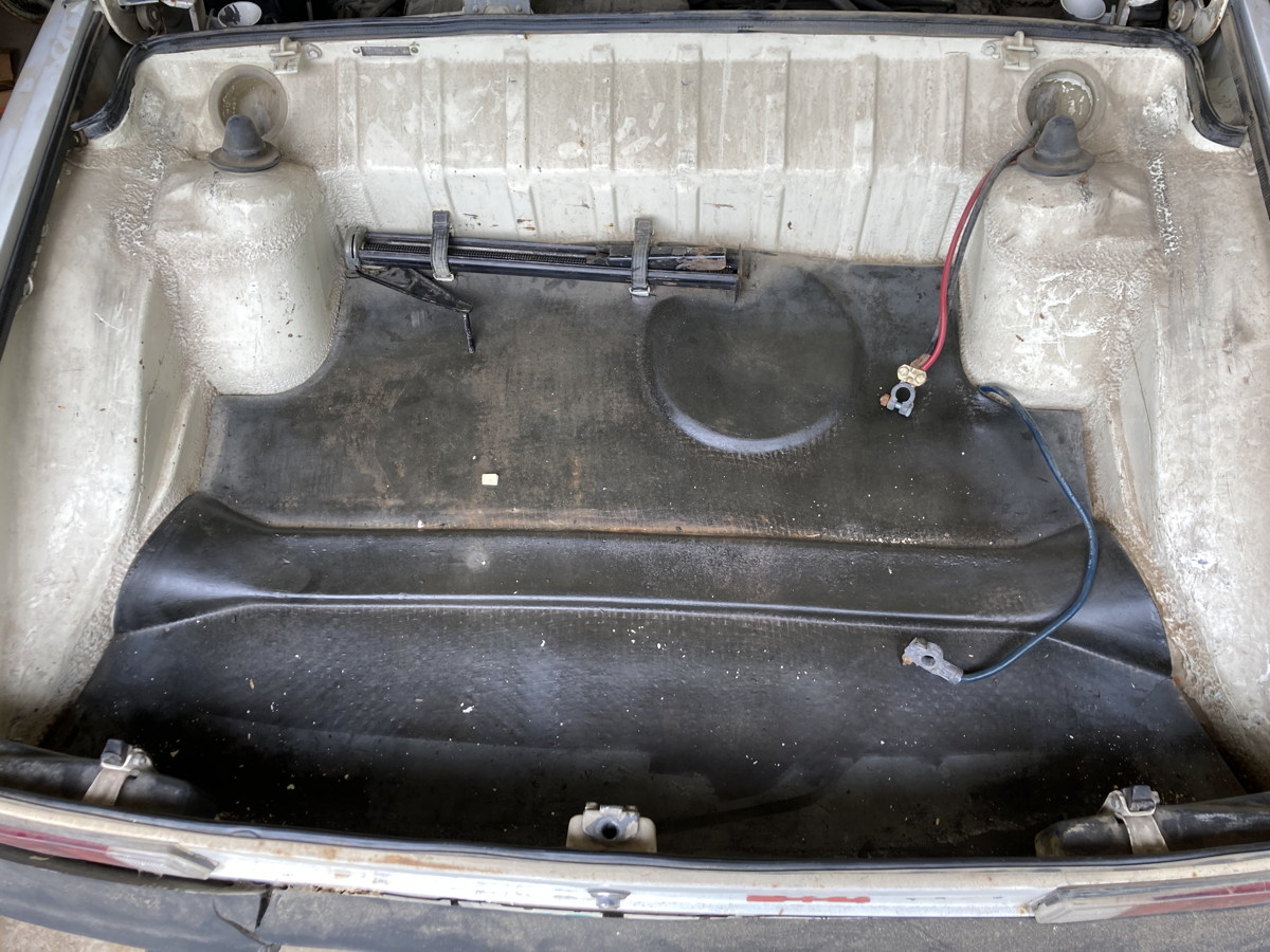

Rusty_Rivets
post May 28 2026, 02:12 AM
Posts: 8
Joined: 8-May 26
From: Western Canada
Member No.: 29,392

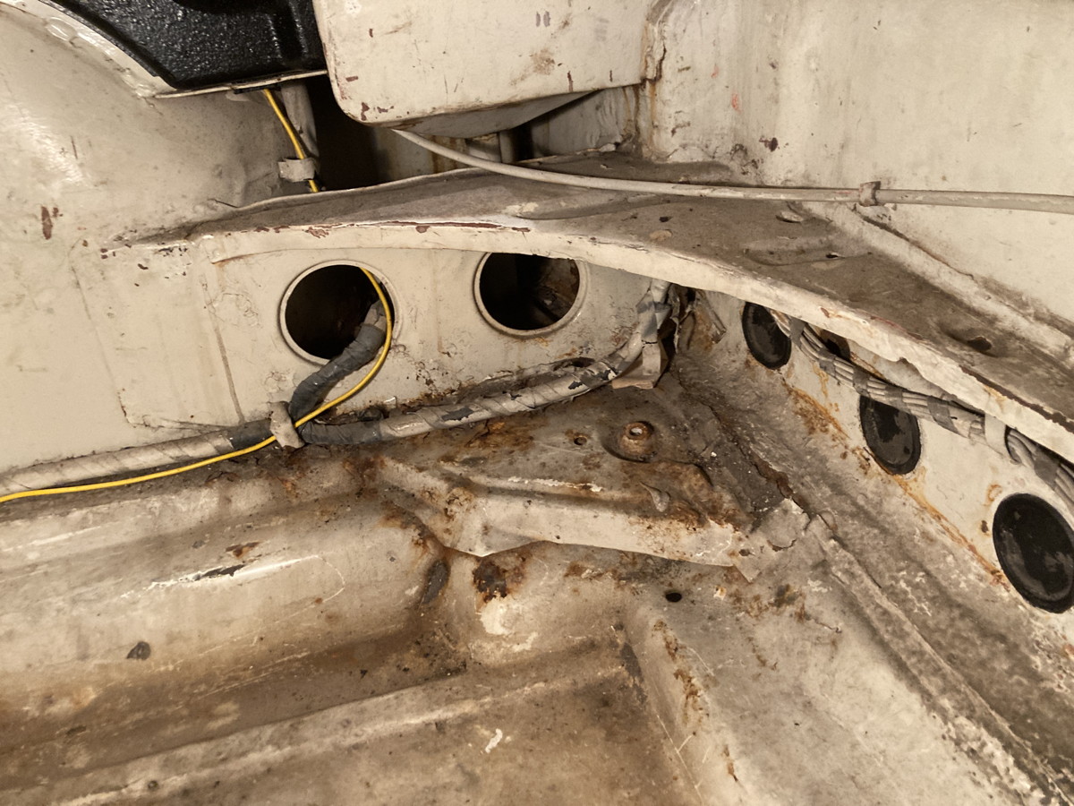

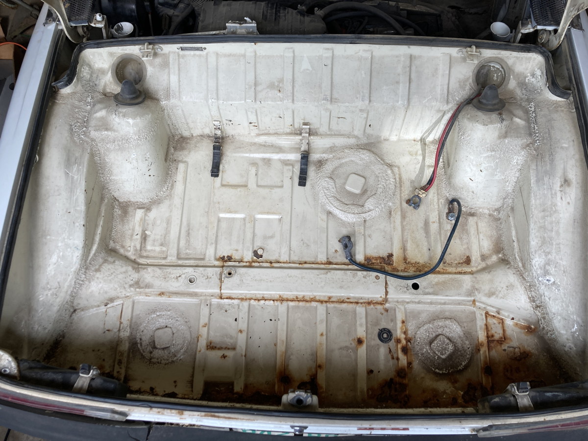

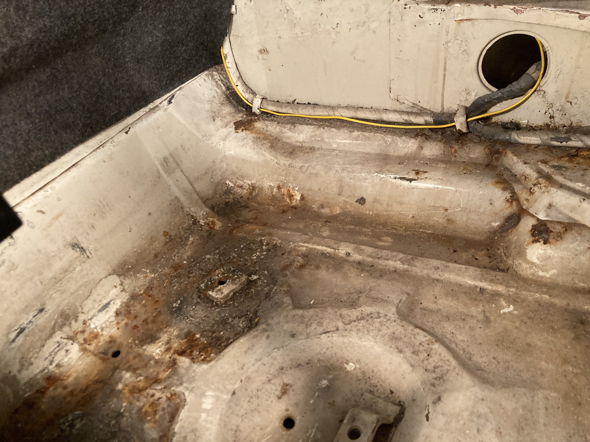

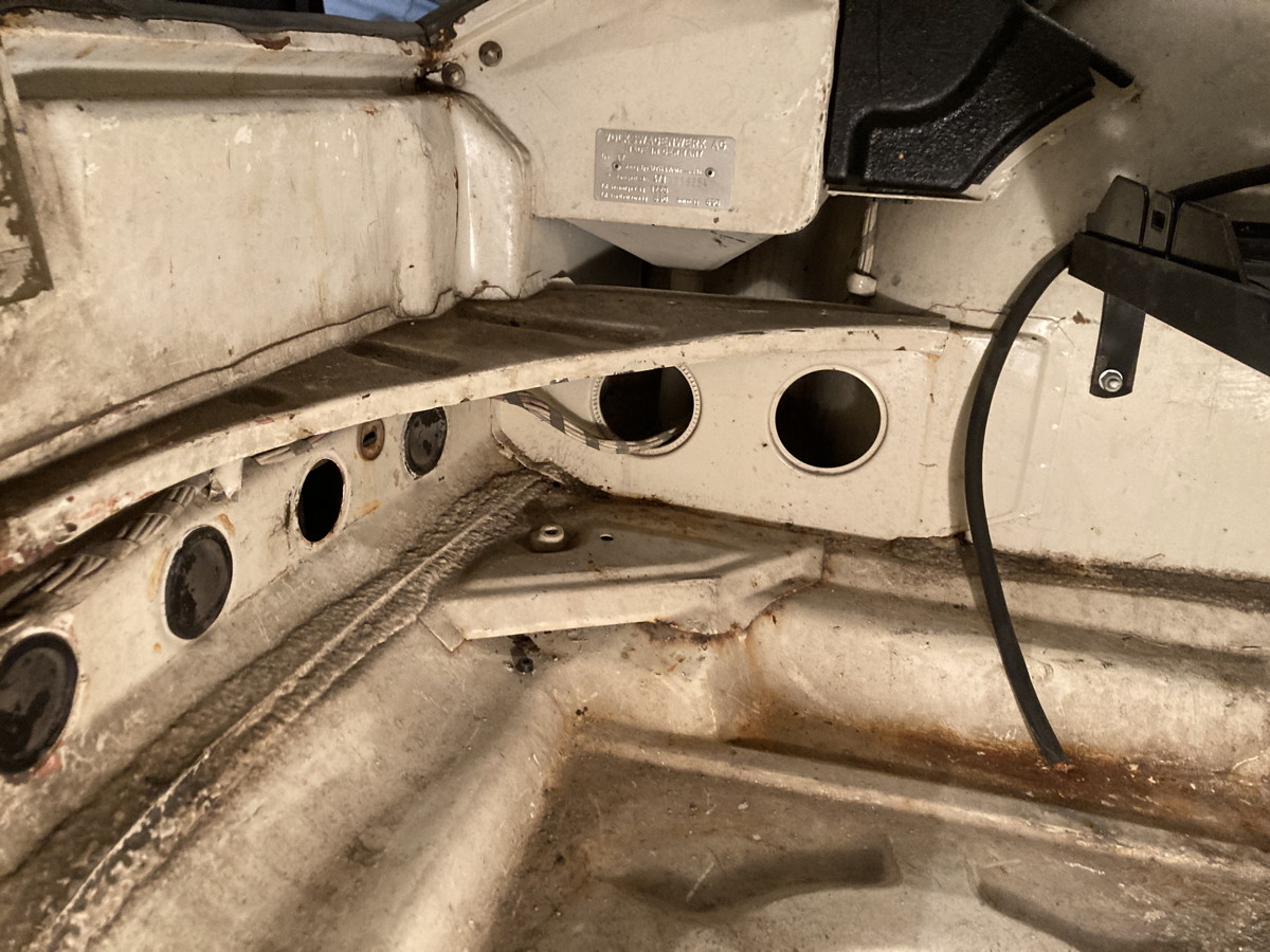

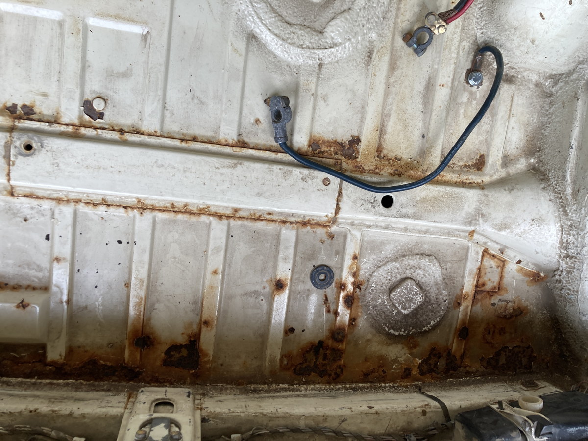

Pics of the trunk with the carpet removed.
The under padding is still in good shape, though a bit brittle. I had to be careful taking it out.
You can see where the PO extended the battery positive cable and where he grounded the negative. I have no idea whether it's a good ground point or not.
The rear left and right corners showing some rust.
In the next few days, I'll try to get the rocker panels off, so I can see what the longs look like.
Root_Werks
post May 28 2026, 10:00 AM
Village Idiot
Posts: 8,990
Joined: 25-May 04
From: About 15NM from Canada
Member No.: 2,105
Only rust I'm seeing is the rear trunk and it isn't that bad. One panel would make that good as new (looks like anyway).
With battery tech being what it is, would ditch the remove battery locations and put the factory battery tray back. There's no need to worry about acid anymore.
So far, looking pretty solid. Wonder what the longs look like after you mentioned door issues.

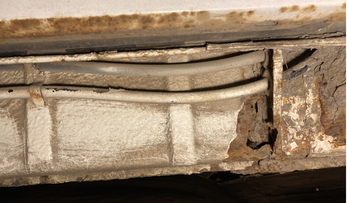

Rusty_Rivets
post May 28 2026, 11:58 PM
Posts: 8
Joined: 8-May 26
Member No.: 29,392
I had a few minutes this evening, was able to get the driver's side rocker off, and took some quick pics. Definitely rusted through in a few places. Probed it a bit with a screwdriver, but need a more thorough examination. All I got were side pics. I'll need to raise the car in order to get decent pics from underneath.

The driver side long will give you a small preview of the damage on the passenger side. The passenger side always has more damage because rain water washes over the battery and the acidic water washes over the right side long and inner and outer suspension consoles. It's a 914 story that's been told hundreds of times. Your statement about the door gaps changing just verifies that the entire right side of the car (and maybe/probably the left) is failing. It's a really big repair. Not just a good amount of money in replacement sheet metal but hundreds of hours of metalwork. Read up about engine shelf repair and inner and outer suspension console repair/replacement. You will also need space to store the engine and trans and space to work around the car. Do you have space to store your other cars outside the garage for the next year or three.
There are dozens of threads showing the repairs needed. One that's easy for me to remember is digging into hell - http://www.914world.com/bbs2/index.php?sho...gging+into+hell
So my suggestion, before you jack up the car, pull the engine and trans and spread the car throughout your garage is to take some time to read through some of the many ruststoration threads and decide if this is a project you want in your life.
