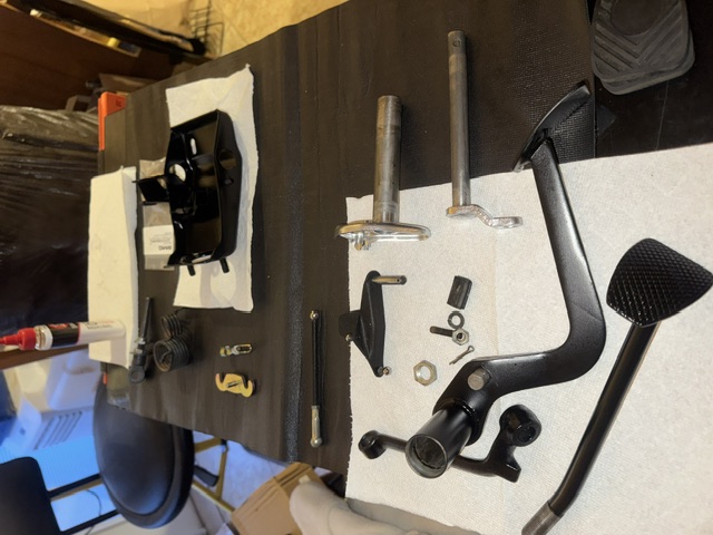

Okay friends, now we've got another item of concern on my 73. The throttle cable was tight. So I pulled the board to reveal the cluster. The throttle "cam?" I guess that's what you call it. Or linkage...
Anyways, it was bent into the center tunnel. It doesn't have that tight, crisp feel. Instead, it's really wobbly. Maybe I should get in touch with Bruce Stone...Attached Image

Typically this means the plastic bushes are shot.
The common solution is to rebuild the cluster with Bronze bushes.
The bigger question is perhaps why they are shot, age? just plain worn out or
leakage (brake MC) which will soften & destroy the OG bushes.
Your pic looks pretty dry? But you have to pull it to really tell

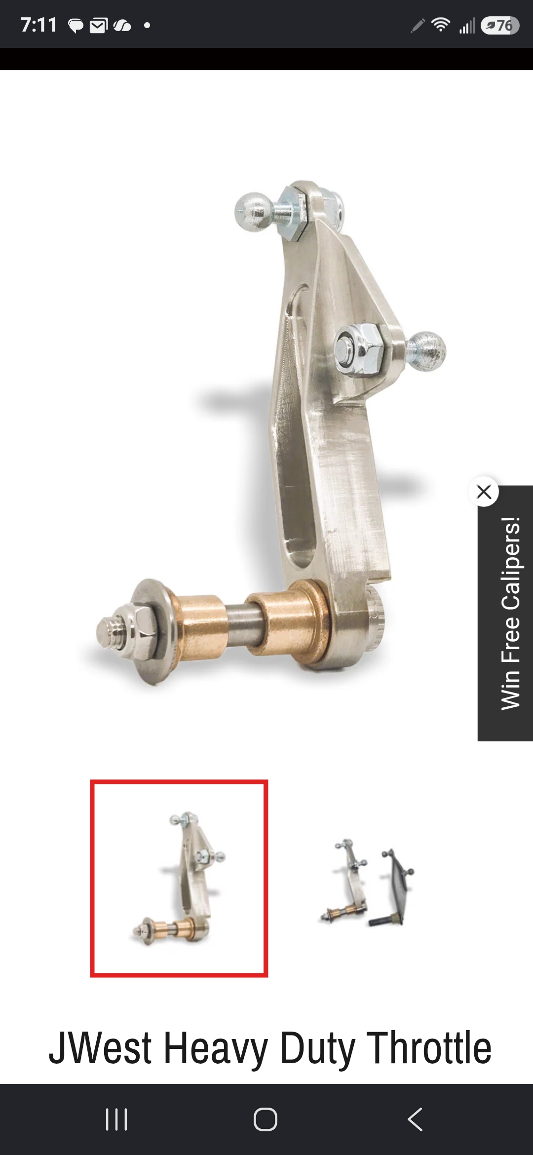

I have this issue currently on mine and the bushings are all new bronze. My bracket, pivot for the cable is/was bent. I have rebent it a handful of times and it just slowly keeps going back to where it wants to be, bent.
If you experience this again I would say to replace that piece with new or maybe go with JWests piece thats way more heavy duty. My pedal is hooked up to fresh webers with some new return springs and it just bends back after like 2 drives, gets frustrating because the cable then weirdly interferes with the clutch cable and that whole connection point.

Stock is ~100 new
Jwest ~150 and you dont need to ever worry about bending it.
Stock number I believe is: 901-423-250-02

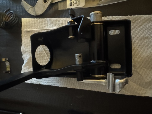

You could try to bend it back. Also make sure that you still have bearing sleeves in the pedal box.
[/quote]
.Bending the lever back usually cracks the braze joint to the shaft.
I have a box of broken ones.
Early 911s had a puddle weld. They dont break.
As Rich said the bending can result from loose bushings. It can also be causes by a rubber gas pedal that allows non linear movement.
At a minimum replace the bushing and weld the accelerator arm to the shaft. New ones are available but expensive. I dont have any i can spare because of the high failure rate.

Good to know. What do you charge to rebuild them? Also what do you think about the heavy-duty throttle pedal lever?

I charge $300 with a,good core. Yours looks good over all. The early throttle levers are bullet proof. I need to round up all the broken ones and get them welded.
[/quote]
[/quote]
What's the difference between early and late throttle levers? What is mine? I meant is the heavy-duty lever from PMB performance worth it?
[/quote]
[/quote]
Yours is late. Only difference is the wekded pin vs brazed. PMB carrues the J West kever. Nice ouece but $155 is a lot. I have repaired levers that have a 8mm threaded bolt which gives better strenght. Use a nylock nut to install. $50 shipped.
