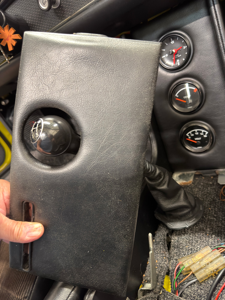

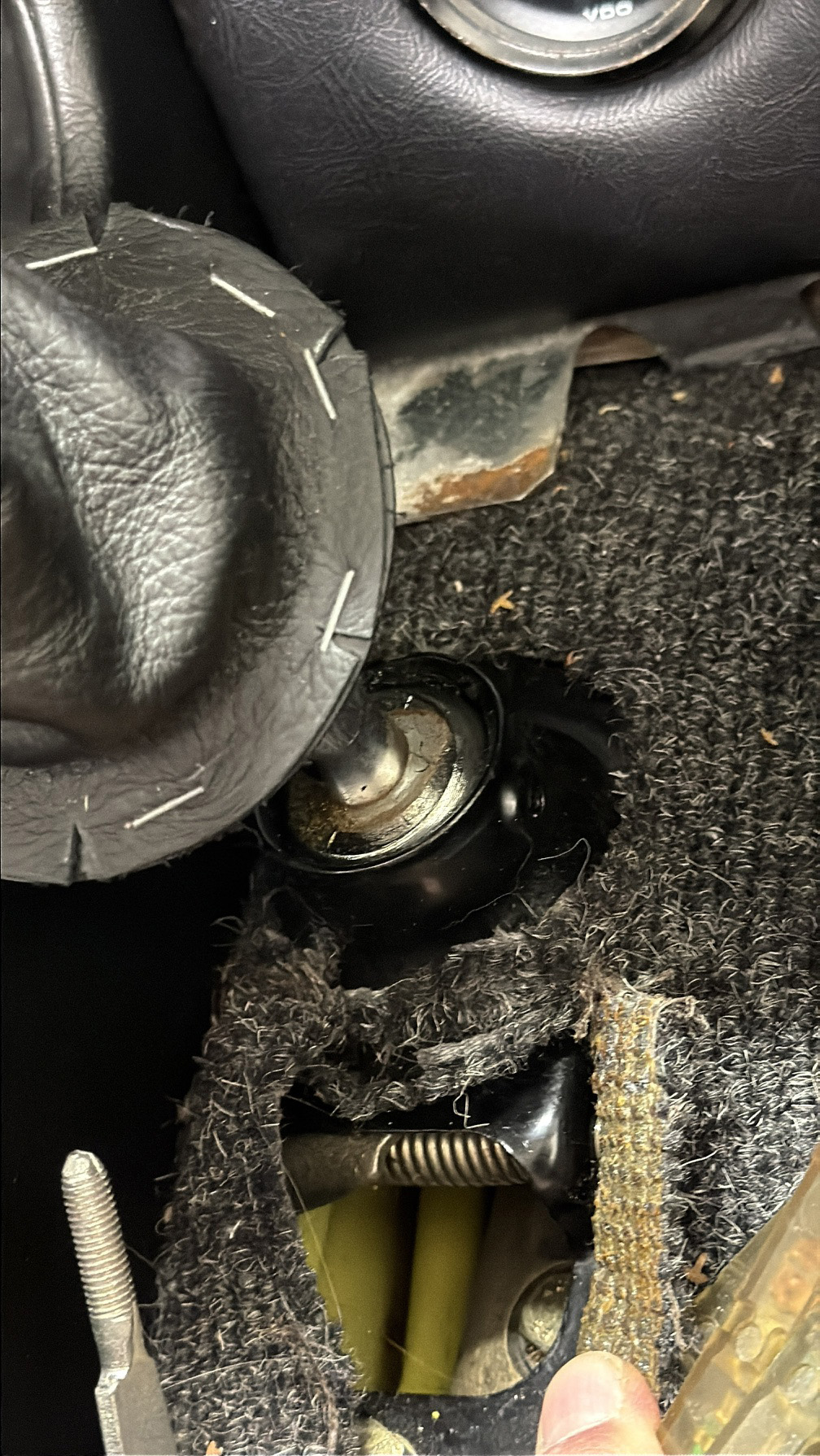

As you can see, the hole in the console lower panel is big enough to go over the shift knob. The 'boot' (what you are calling the 'gaiter') is not attached at the bottom, you can pull it up along the gearshift shaft. It would be necessary to remove the shift knob to take it off entirely.
I am guessing that my carpet is not original as the cuts made to go around the gearshift are not nice and the edges are not sewn. I imagine it would be a good thing to cut away more of the carpet to expose the shifter mechanism if it needs adjusting - haven't needed to do that personally.
