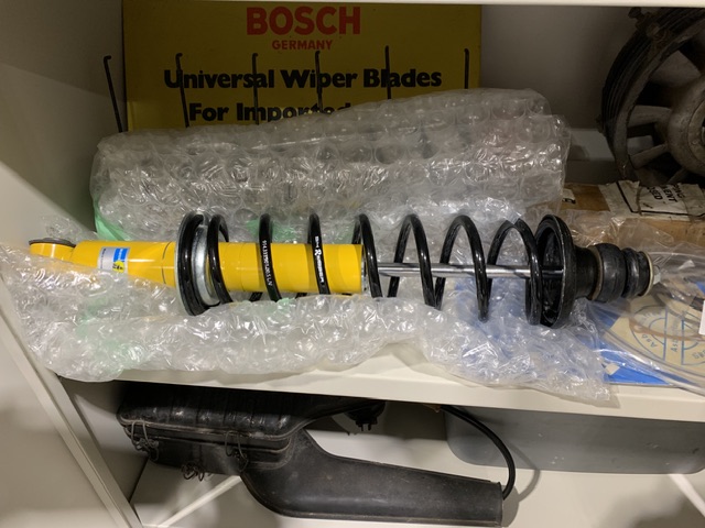

Recently assembled new rear shocks, Bilsteins.
100# springs, new rubber parts, stock and new lower perches.
I assembled them without springs compressed, and tightened the factory nut assembly (#10 PET) until tight. I believe it is threaded on all the way. Then temporarily slid new rubber bits over the top……my questions are:

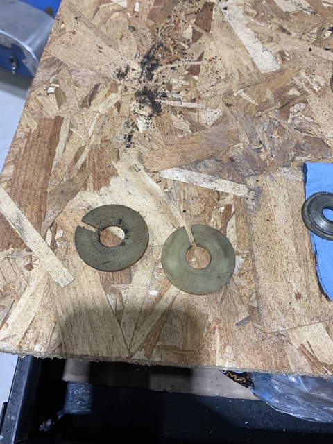

My donor shocks had some plastic washers under the hats, do I reuse them?

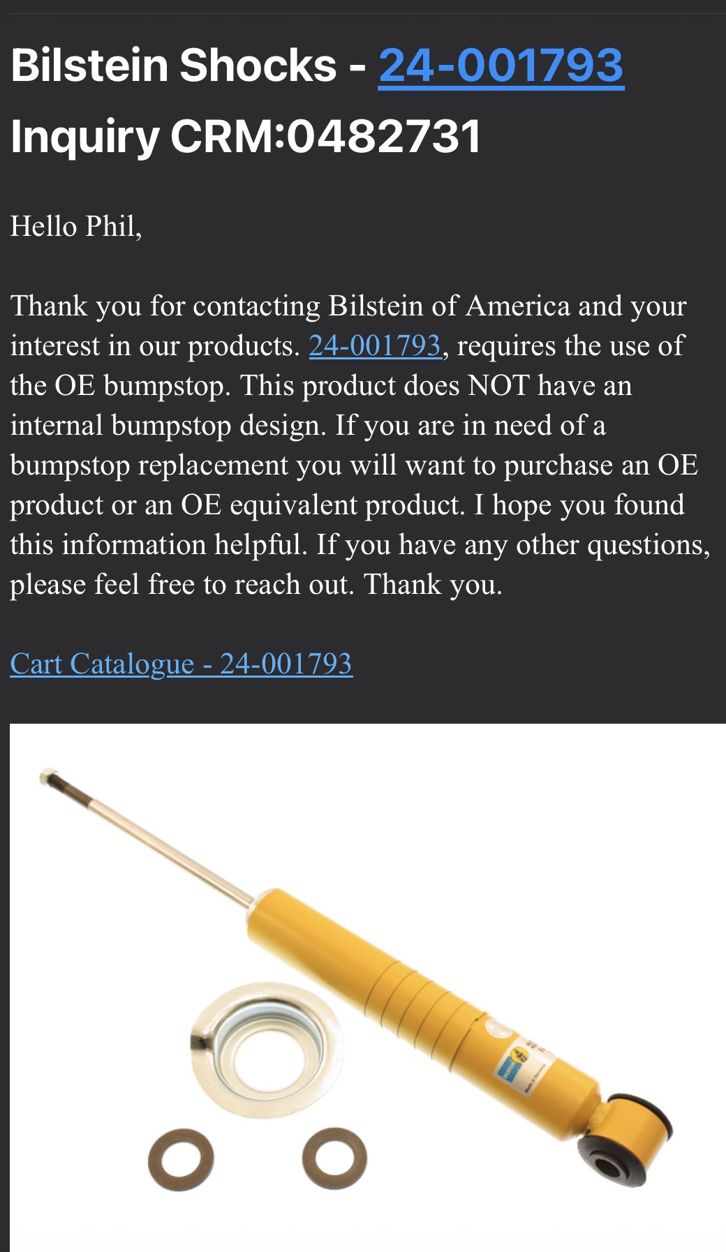

(Edit addition). I’m now confused myself. I went digging in the Bilstein catalog for p/n 24-001793 to get you a solid reference and it references an internal rebound stop but says nothing about a jounce bumper stop. I can tell you when I assembled mine I didn’t use an external jounce bumper but now I’m doubting myself (IMG:style_emoticons/default/unsure.gif)
Install instructions don’t clarify.
I may have to contact Bilstein to see what they say.
Update: Dear Partners, Dear Customers,
Thank you for contacting Bilstein of America.
Your inquiry has been received. Your case number is CAS-xxx
We will answer your enquiry as soon as possible. Due to the high volume of inquiries, it may take us longer than normal to respond

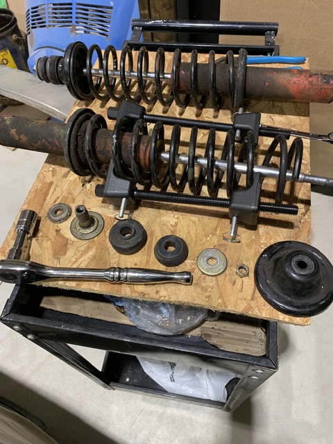

Just did mine, the same configuration. No, the jounce bumpers aren’t needed, nor the two each side additional rubber rings. Same questions also so took a few days as yes the instructions aren’t clear. They seem to be used on just Boge struts.
Also not clear on the bottom movable rings and orientation of the bottom plate ( lip down).
Be sure to do alignment as change will alter stuff - in my case quite a bit! Nose may be up after springs settle so adjust torsion bar screw.

When I replaced my rear shocks with the same Bilsteins, I reused the bump stops and all the hardware etc that were on my old rear shocks. I also installed new rubber isolators in their respective locations. I also placed the circlip on the 5th from the bottom after I inquired about spring perch height to a factory rear shock absorber.
