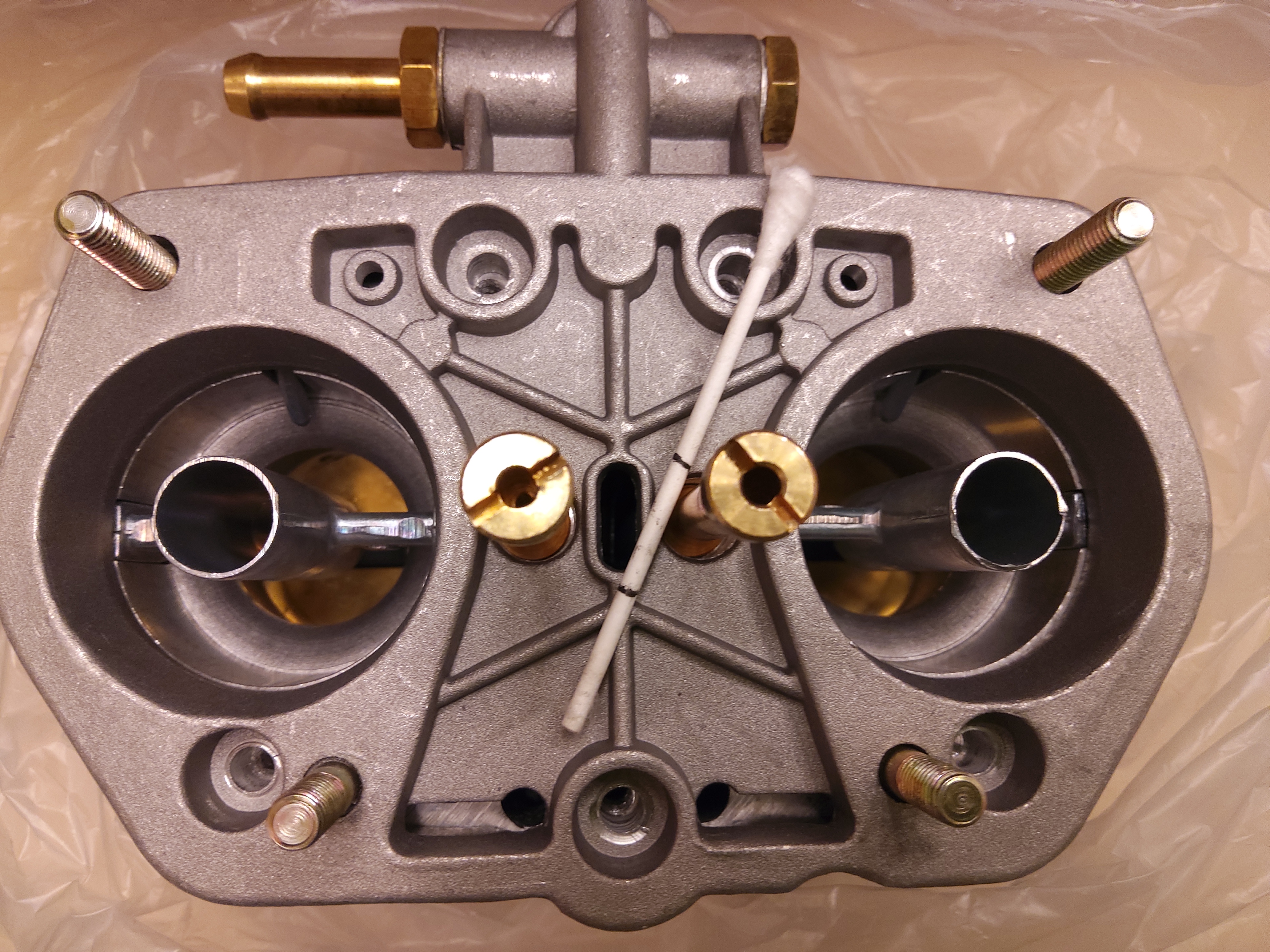

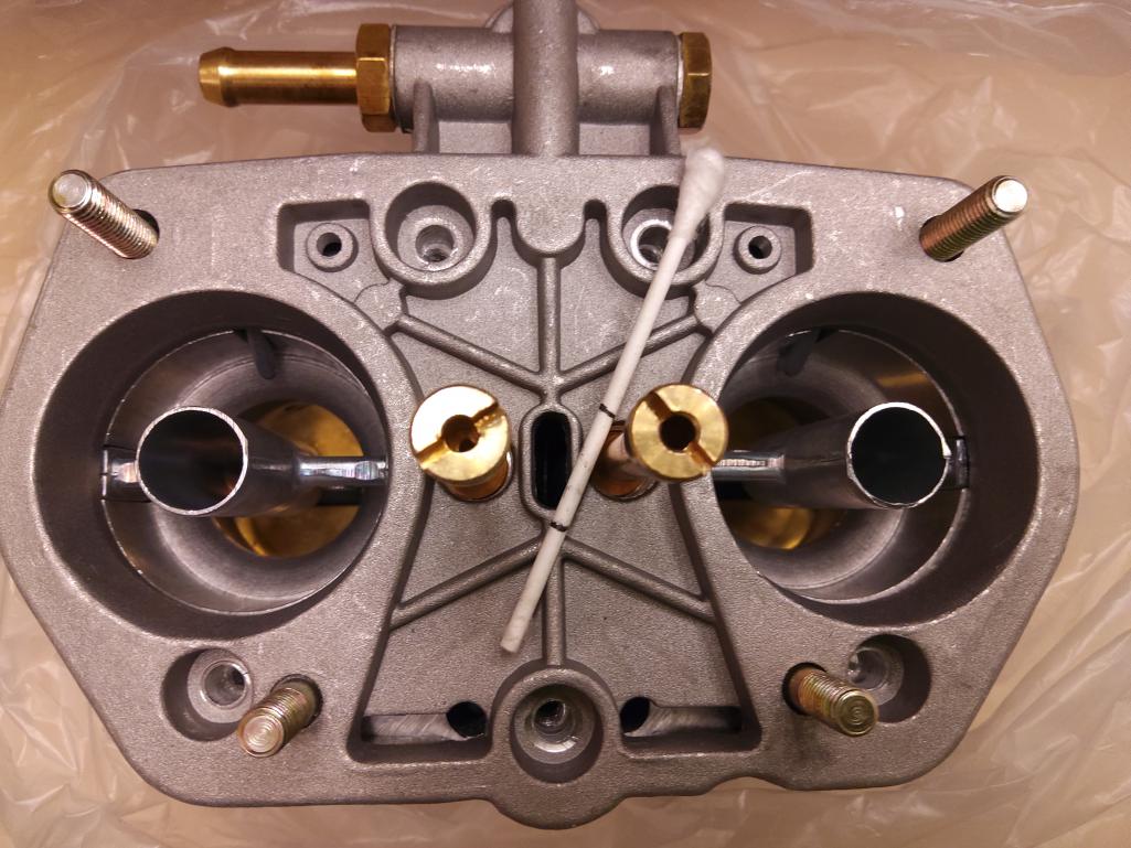

Well, didn't think of mentioning that it could be a crack in the carb. Is it both carbs or just one?
Can definitely feel the frustration. Had a fuel delivery problem a while ago on the '74 after rebuilding and installing a new motor. Went through multiple fuel pressure regulators, multiple fuel pumps, and fuel pressure gauges. A brand new gauge would start out at just under 3 psi and after the motor warmed up it would show -0- psi! This caused lots of parts swapping of FPRs, pumps, plumbing, etc. Turns out it was a crappy gauge.
Also, since you mentioned you rebuilt the carbs, did you make sure the top gasket was the right one? Have seen so many ones that are slightly different. Maybe hold the new one up to the original gasket and see if they are exactly the same.
Also, you can cut a slender piece of paper or thin cardboard that you can insert in the top of the carb to see where your fuel level is in the bowl (or a Q-tip (IMG:style_emoticons/default/smile.gif) ).

Both the Hawks suggestions and Jack's "dip stick" suggestions are spot on.
Some carbs come with a sight glass in the float bowl for level checks.
This is a GOOD feature in my book!
Sometimes it is damn hard to gauge float weight on a solid float.
