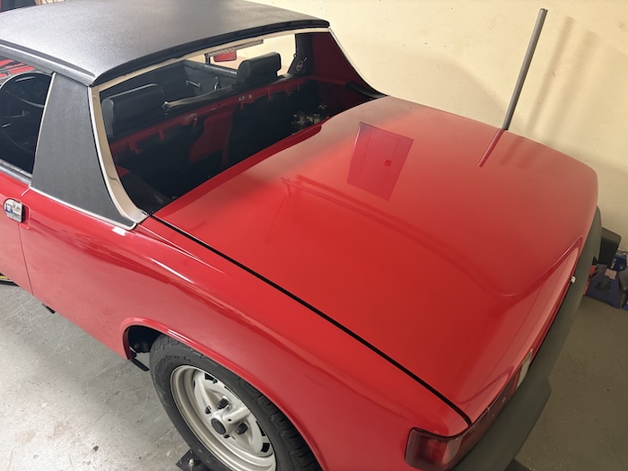

QUOTE(friethmiller @ Jun 26 2026, 04:07 PM) *
I can't believe it but after 1-1/2 years of waiting for my engine components to be machined, I am finally picking up the parts tomorrow (IMG:style_emoticons/default/blink.gif). I will post more after talking to the owner about the issues he found with my case. This is what was holding everything up. Luckily. I have source another case (from my shed) and will be using this one instead. Here's a few pics of the my "other '74" after uncovering it today and wiping off a bit of dust. She needs to ride again! Hoping for Okteenerfest. Stay tuned!
Car looks great . Did this one start out like the Bumblebee ?

QUOTE(Ron914 @ Jun 26 2026, 05:59 PM) *
Yes, it was just as “awesome” as the LE. The hell hole was especially fun. Here are a few pics - just for you (IMG:style_emoticons/default/biggrin.gif)

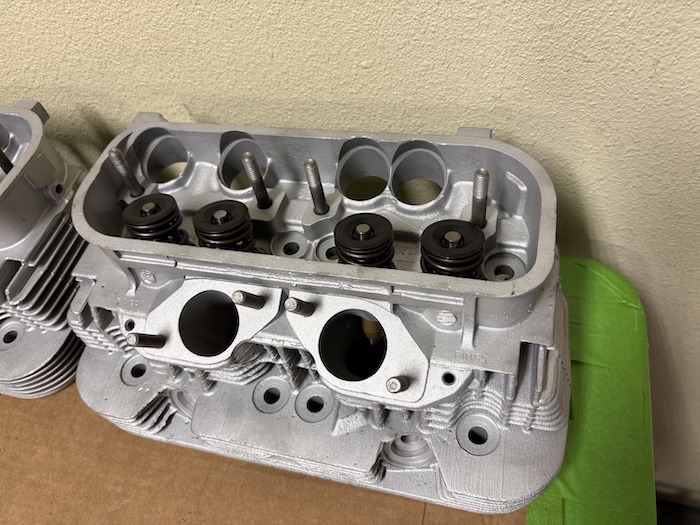

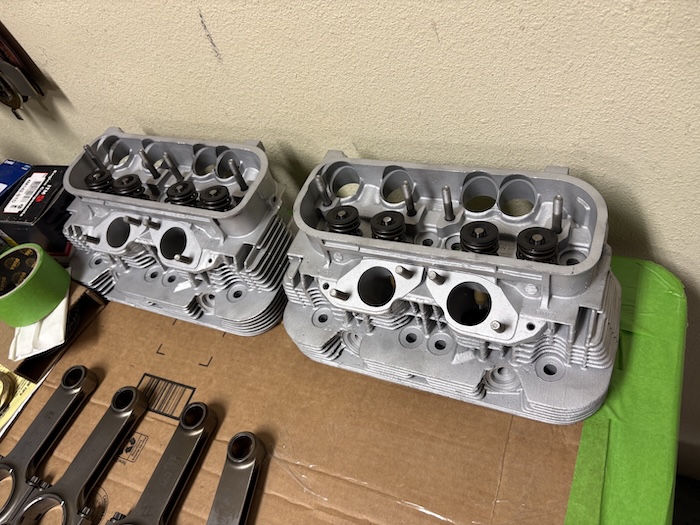

Initial Layout (6/27/2026):
After about 5 hours of driving to go get my engine parts, I got home just after lunchtime today. I started laying things out in an attempt to get things organized. I took a few pictures. As I mentioned earlier, my original EA case will not be used on this build. Instead, I will be using my back-up W-case that I had machined late last year. The problem with the EA case is that 2 of the mains are too tight. So this case probably needs align bore. I'll do this at a later date. Hell, I've got the LE case getting worked on at the moment. The machinist bill is high enough at the moment - thank you. (IMG:style_emoticons/default/blink.gif)

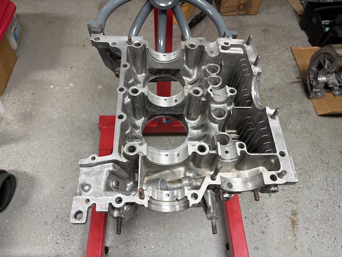

Here's a pic the W-case on the stand. This was align-bored .20, oil-galleys tapped, with the cylinder openings just cleaned-up (no need for decking). Work was done by EMW in 2025.
The dual-spring 1.8L heads were cleaned, inspected, and reassembled. These heads were previously reconditioned [back in 2020] and checked out fine. They are port & polished with 44/38 valves.

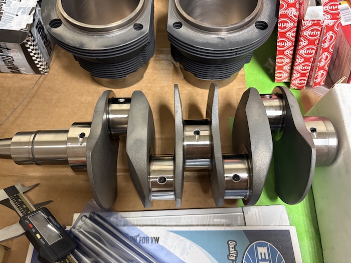

Going with a new 78mm crank. This is why my 2.3L will become a 2.2L.

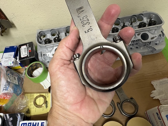

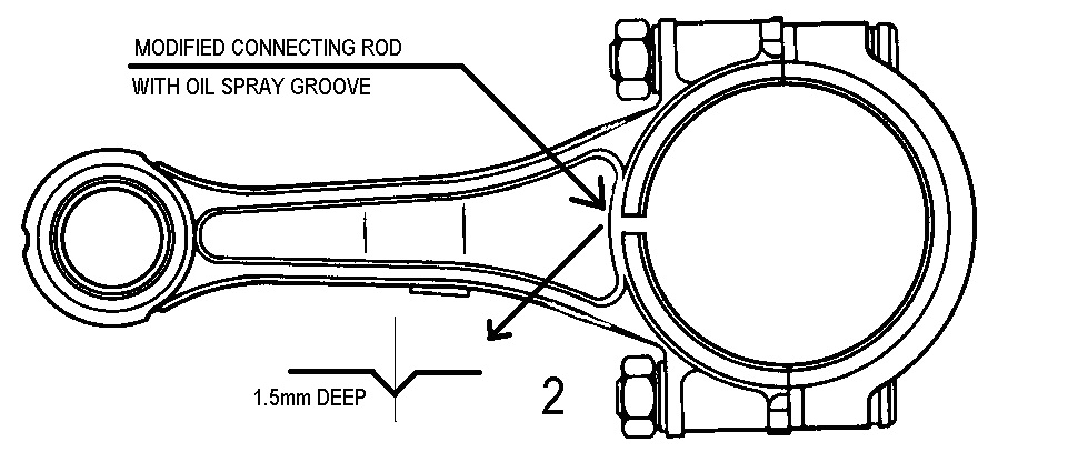

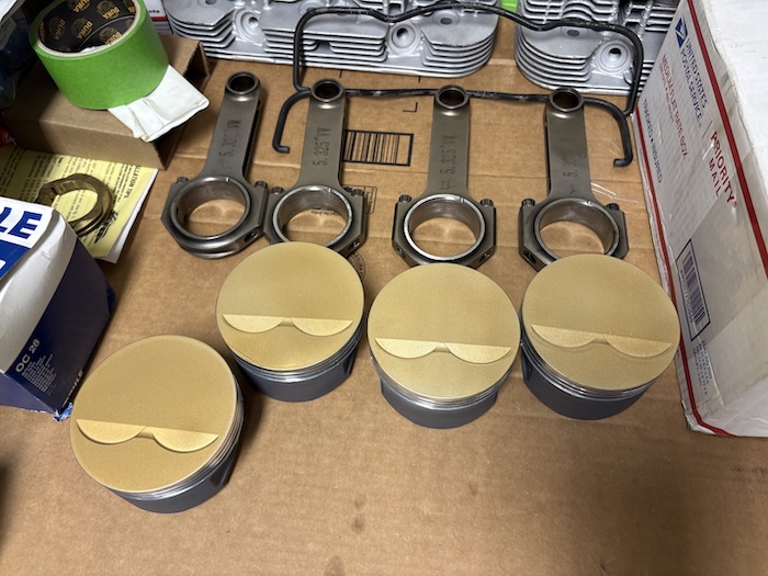

Pistons are new 96mm forged JEs with ceramic coating on the sides and top. Rods checked out fine but were modified for better oiling. Note off-center oil grooves.

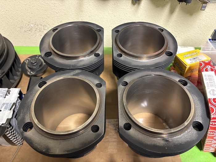

Cylinders are original German 93mm, 1.8L units that were sandblasted, painted with flat black paint, and then bored to 96mm

1. Who’s crank?
2. Is that oiling groove on both sides of the connecting rod?

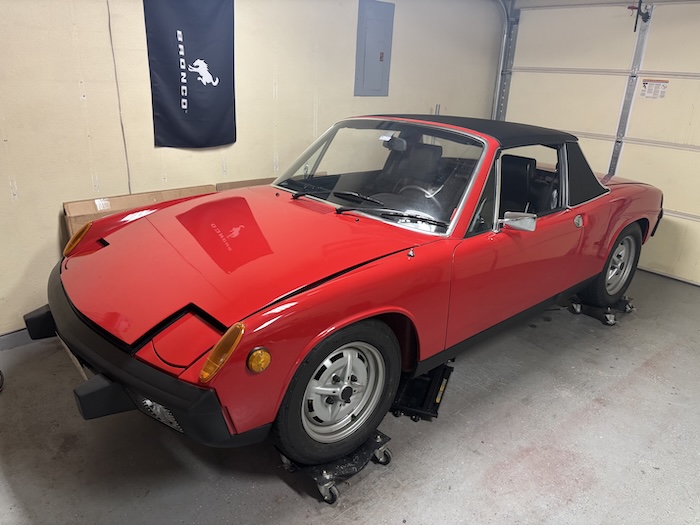

That car looks beatiful! Did you install the braces for the inner suspension ears? I am seeing the anchor point on the firewall.

EDIT: is there a reason why the notch in the connecting rod is offset instead of centered?

1. Who’s crank?

1. I think this is a AA performance forged chromoly crank
2. Yes. The machinist has a lot of experience with VW engines. He said he prefers an offset 'U' groove on both sides of the rod. He mentioned better directed oil spray at the bottom of the piston. I assume the groove would need to be on the top but will verify with him before assembly.
Do yo have the matching lifters for that WebCam camshaft?
Yes, I installed Tangerine Racing's "Rear Suspension Inner Pickup Heim Rod Brace Kit" on this car. Easy upgrade if you have the welder out. (IMG:style_emoticons/default/welder.gif)

So, 2258 with flat tops and the 1.8 heads.
Have you figured compression?
Parts look nice!
Yes. I'm targeting 9.1 - 9.2, depending on deck height. The chambers are 60cc with a 0.9cc valve pocket in the pistons.

QUOTE(friethmiller @ Jun 27 2026, 04:16 PM) *
Curious , why offset as the published description of this mod was centered ?

QUOTE(914werke @ Jun 27 2026, 08:43 PM) *
Rich, I think it’s a matter of cooling the piston vs the wrist pin. Not 100% sure. I’ll get more details on Monday.
