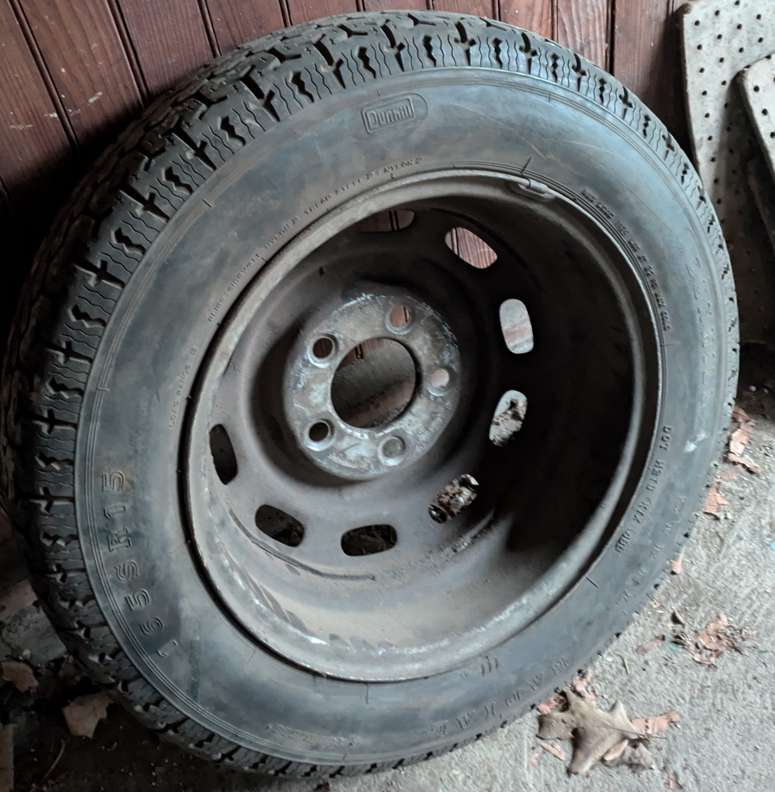

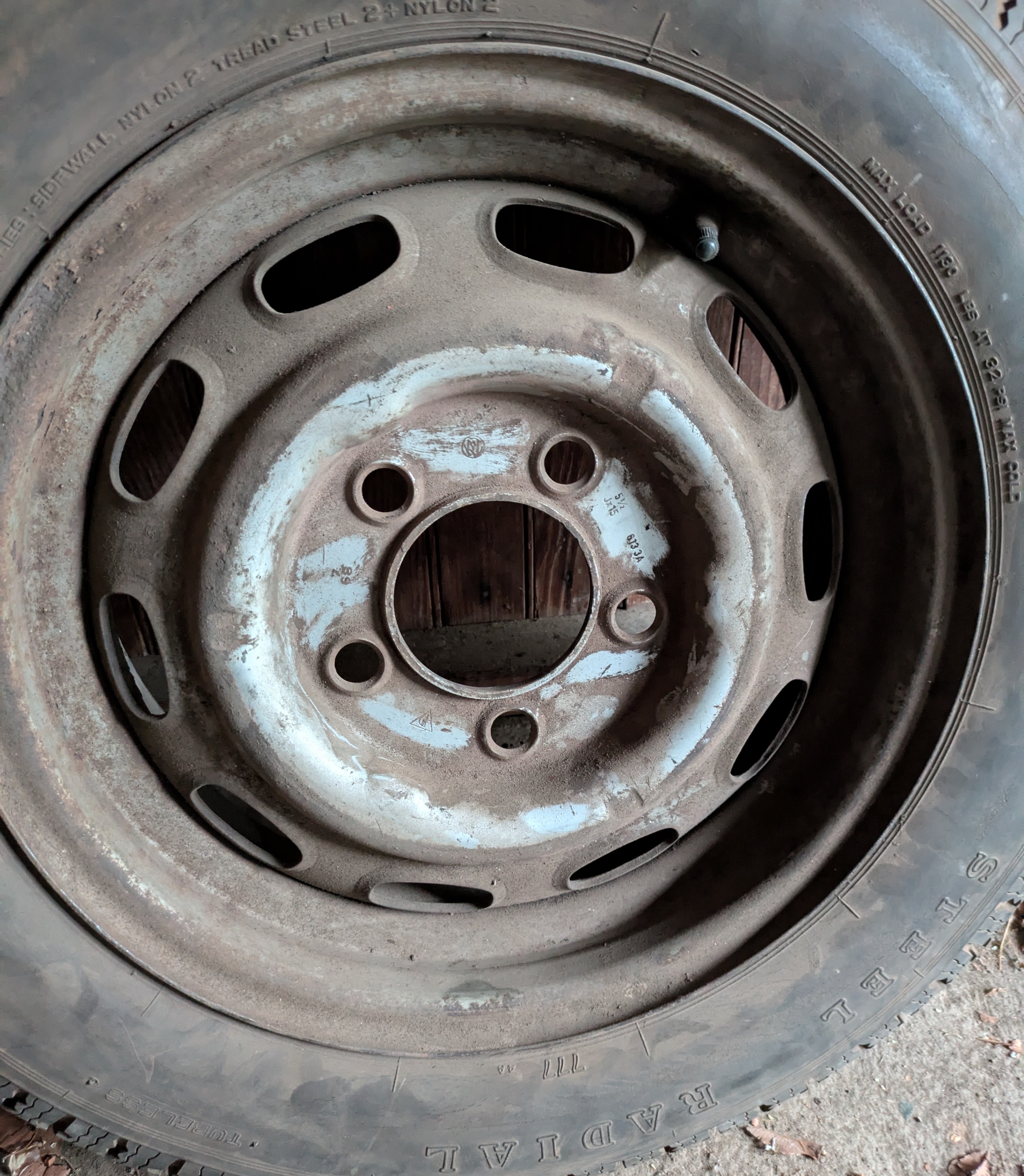

A friend gave me an ancient wheel to use as my spare. Currently it has a 165r15 Dunhill on it. The wheel is stamped 68 as well. Question to the community: is there a spare tire with near 24.9" diameter? Something like a 155/80R15 would match but I don't think they really seem to exist. Is there a way to find something like a space saver that would work on this? Anyone know a size that would work for me? The 185 is a bit big in the trunk too. Trying to use the free wheel.

QUOTE(emerygt350 @ Jun 26 2026, 08:44 PM) *
A friend gave me an ancient wheel to use as my spare. Currently it has a 185rs15 Dunhill on it. The wheel is stamped 68 as well. Question to the community: is there a spare tire with near 24.9" diameter? Something like a 155/80R15 would match but I don't think they really seem to exist. Is there a way to find something like a space saver that would work on this? Anyone know a size that would work for me? The 185 is a bit big in the trunk too. Trying to use the free wheel.
Looks like a 165 to me

Thanks for catching that, yeah 165, corrected the above.
I tried tire rack but did not find anything. Will keep digging.

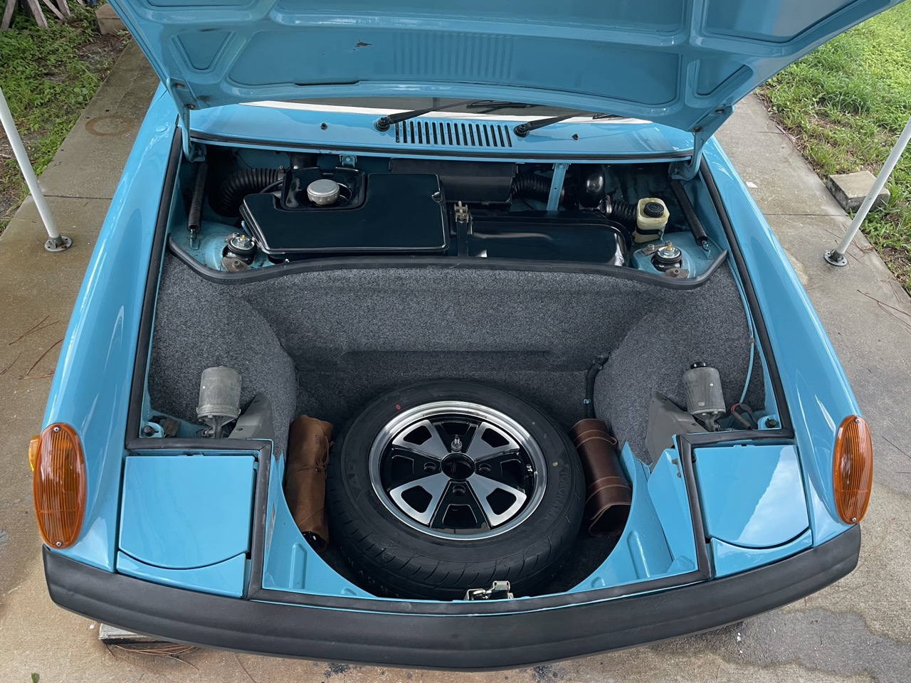

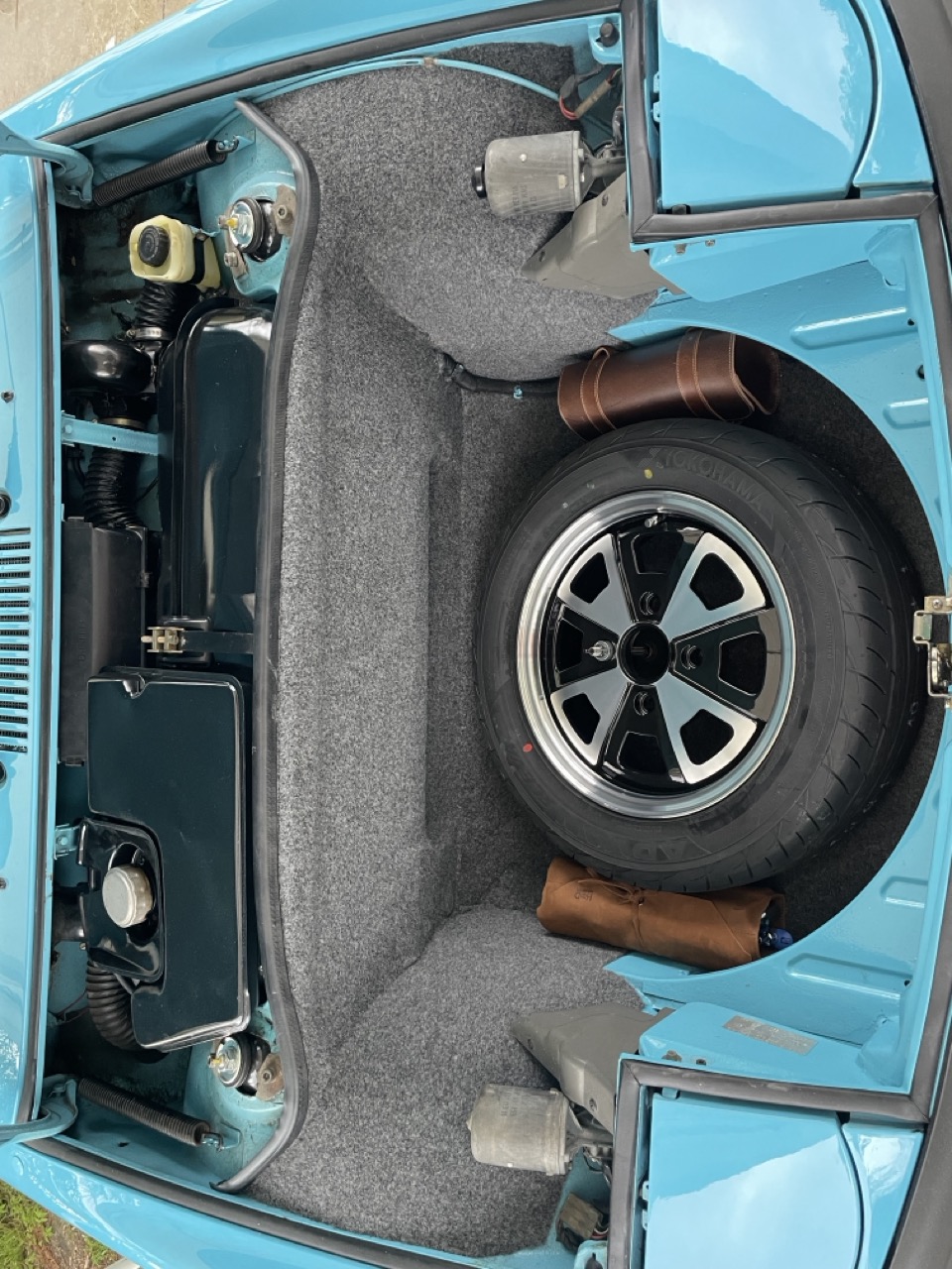

Could just go with the same tire and rim you have on the car….
That way if you change out your flat tire, you’re still stylin’.

That would be nice but it would consume my whole frunk, and I daily this car. Groceries etc .. and I need to fit my rig in there for gigs.
Your pictures reminded me that I don't really know what the frunk is supposed to look like with a spare. Does the carpet/board piece go under? I guess I haven't noticed a hole for the fastener in mine.

QUOTE(emerygt350 @ Jun 28 2026, 09:58 AM) *
"Does the carpet/board piece go under?" No, it sits on top of spare tire.

The board goes over the tire
