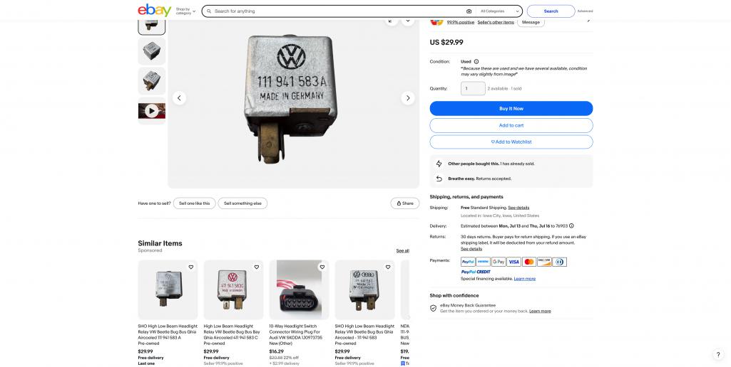

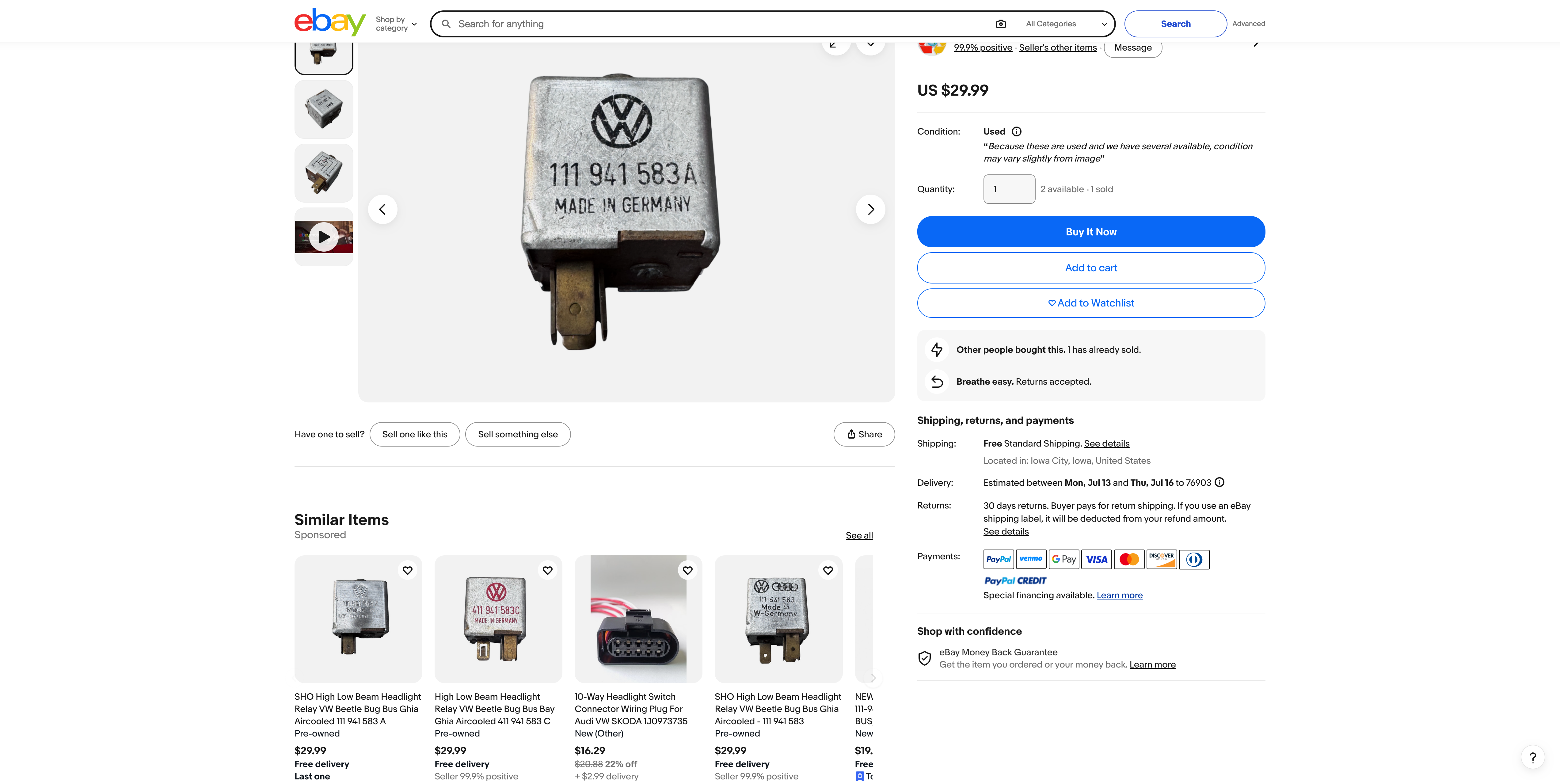

EBAY

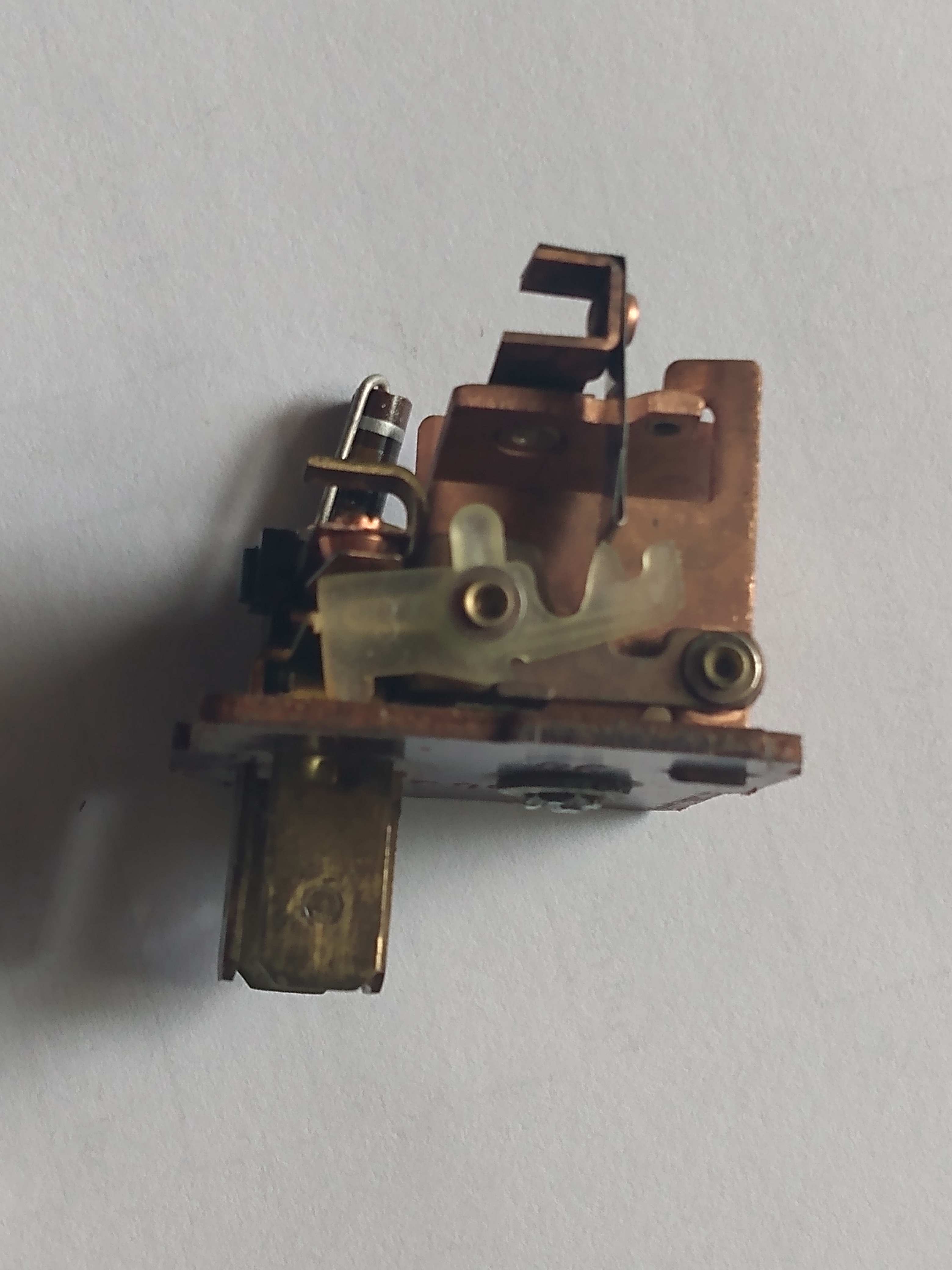

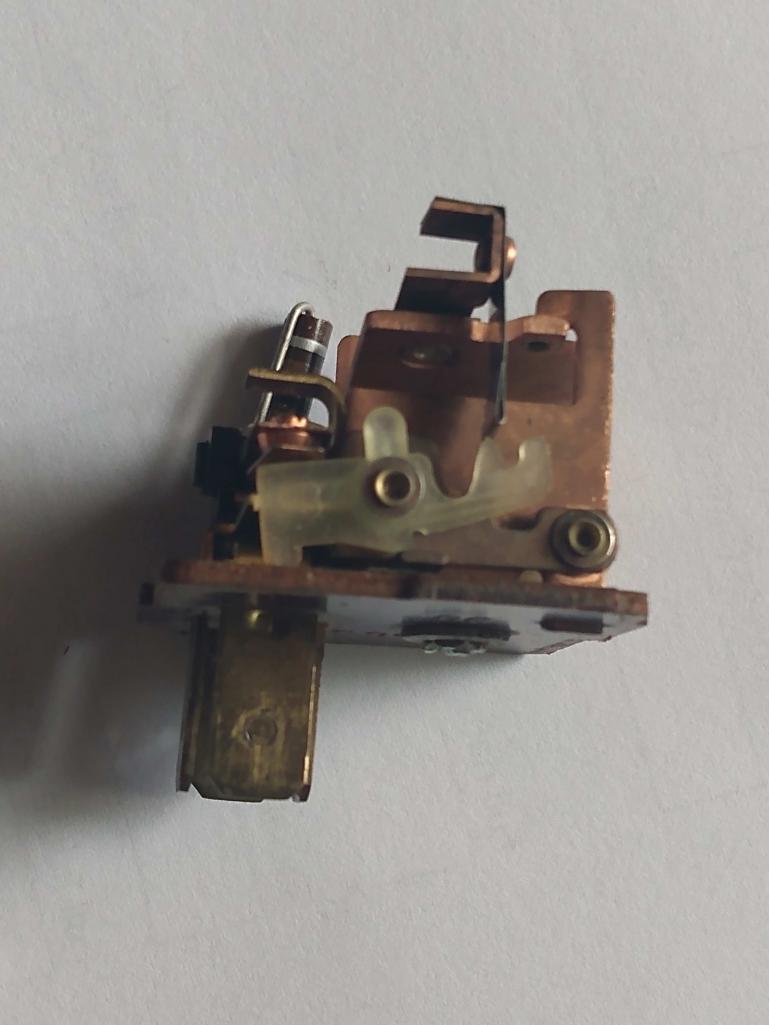

Is this what you are looking for? Also called a latching relay?
Attached ImageAttached Image
fixer34
post Jul 10 2026, 03:13 PM
Posts: 1,459
Joined: 16-September 14
From: Chicago area
Member No.: 17,908
If yours has the metal 'can', carefully bend back the tabs over the phenolic board and lift it off. See if there is a latch mechanism similar to the above picture.
If it looks the same, I'll send you the one I have to try.
Maybe also try manually moving the relay arm and cleaning the contacts on yours.

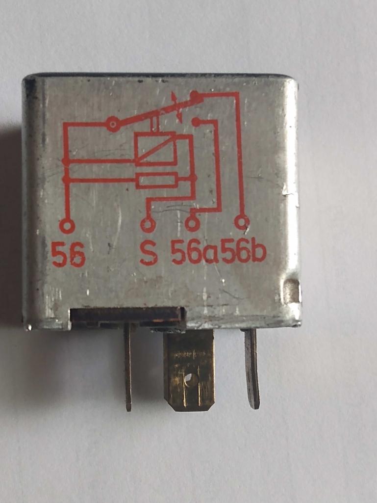

@Jezibel The relay that you are asking about is the hi/low beam relay.
It has nothing to do with the headlights not retracting.
Assuming the headlights go up when you turn them on but not down when off the problem is most likely the headlight switch.
