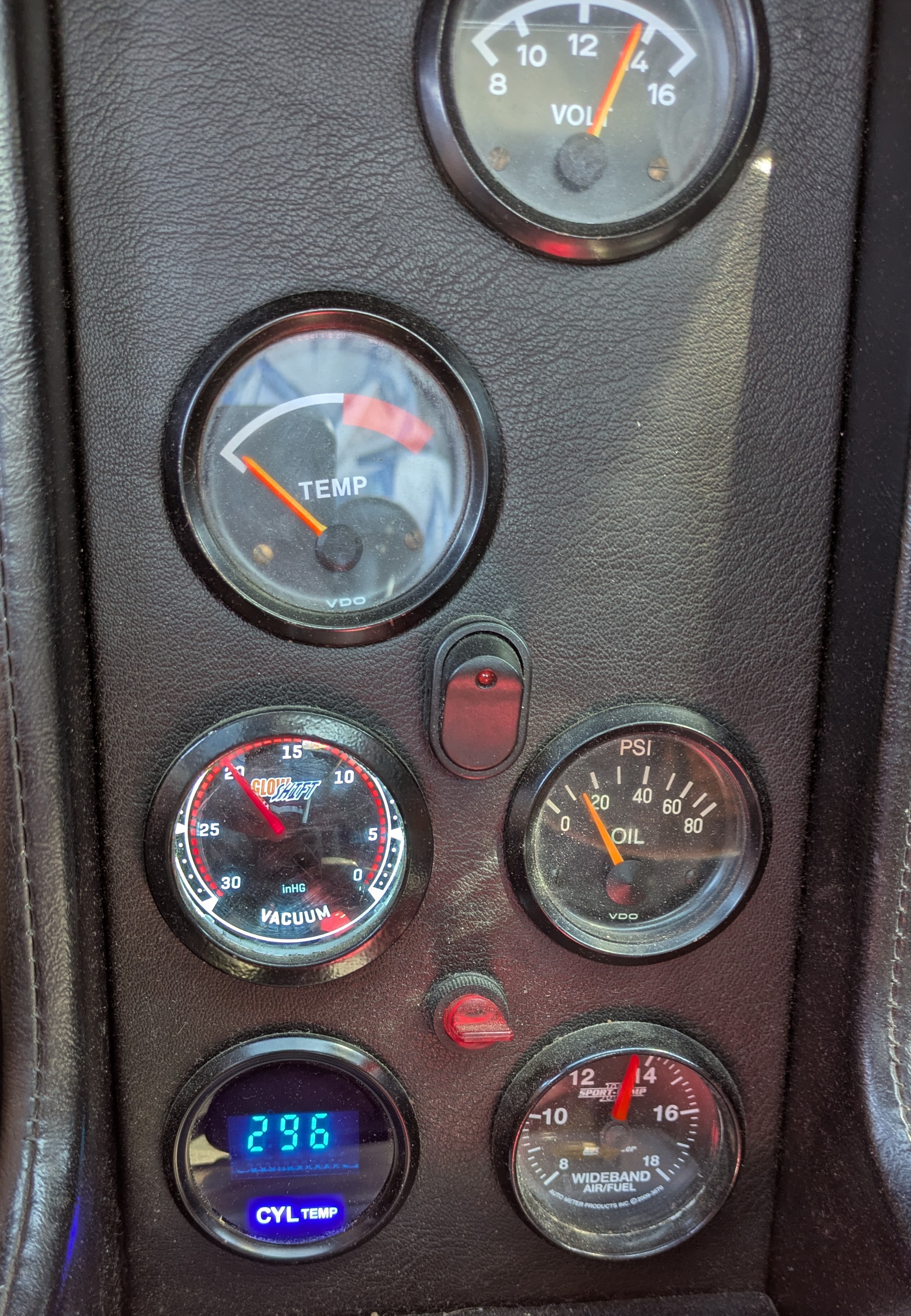

Yes, all good. Tornadoes east of us. It's rare these days for people to add a vacuum gauge but I love having one on my console. Gives you good information on engine performance, mpgs, timing, etc.
