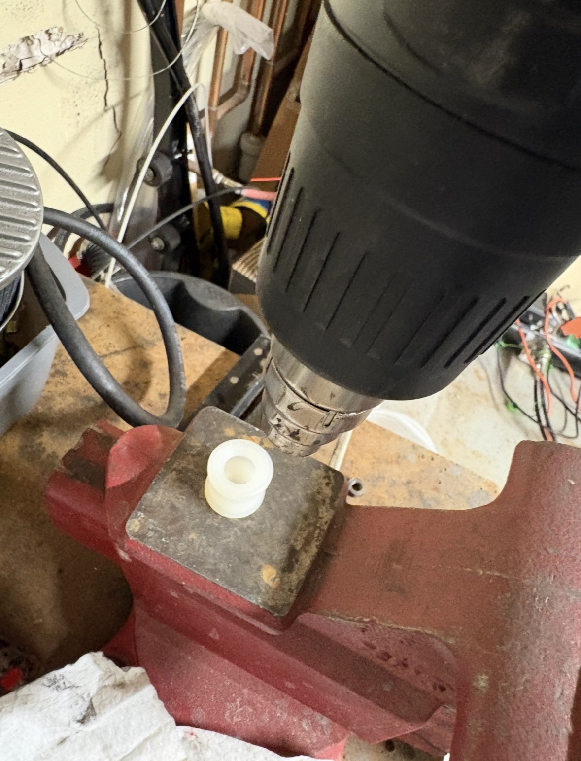

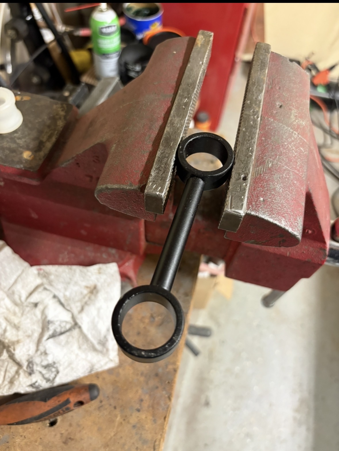

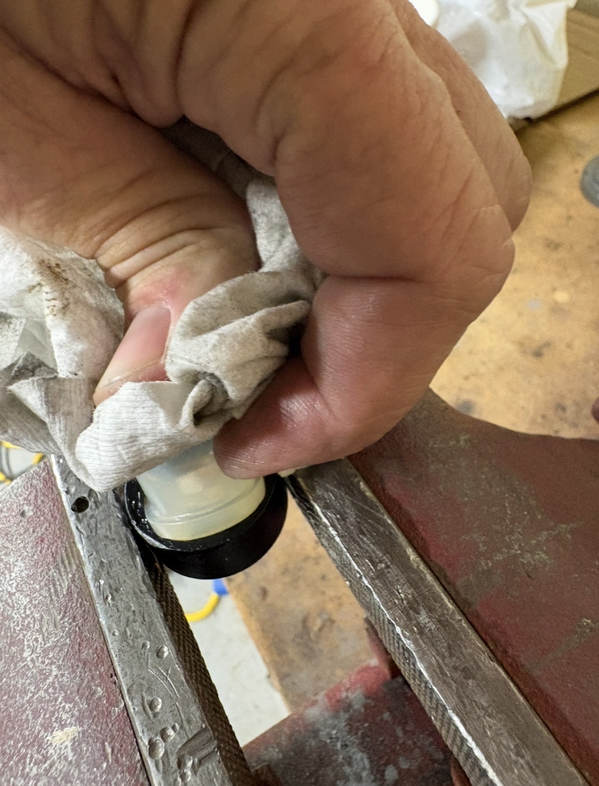

Not easy but it can be done in about 5mins each.
1) put drop link into vise and tighten
2) warm up bushing with heat gun
3) Insert bushing in a way to take advantage of the vise’s pressure
4) use blade of screw driver to push lip into hole
Attached Image. Attached Image

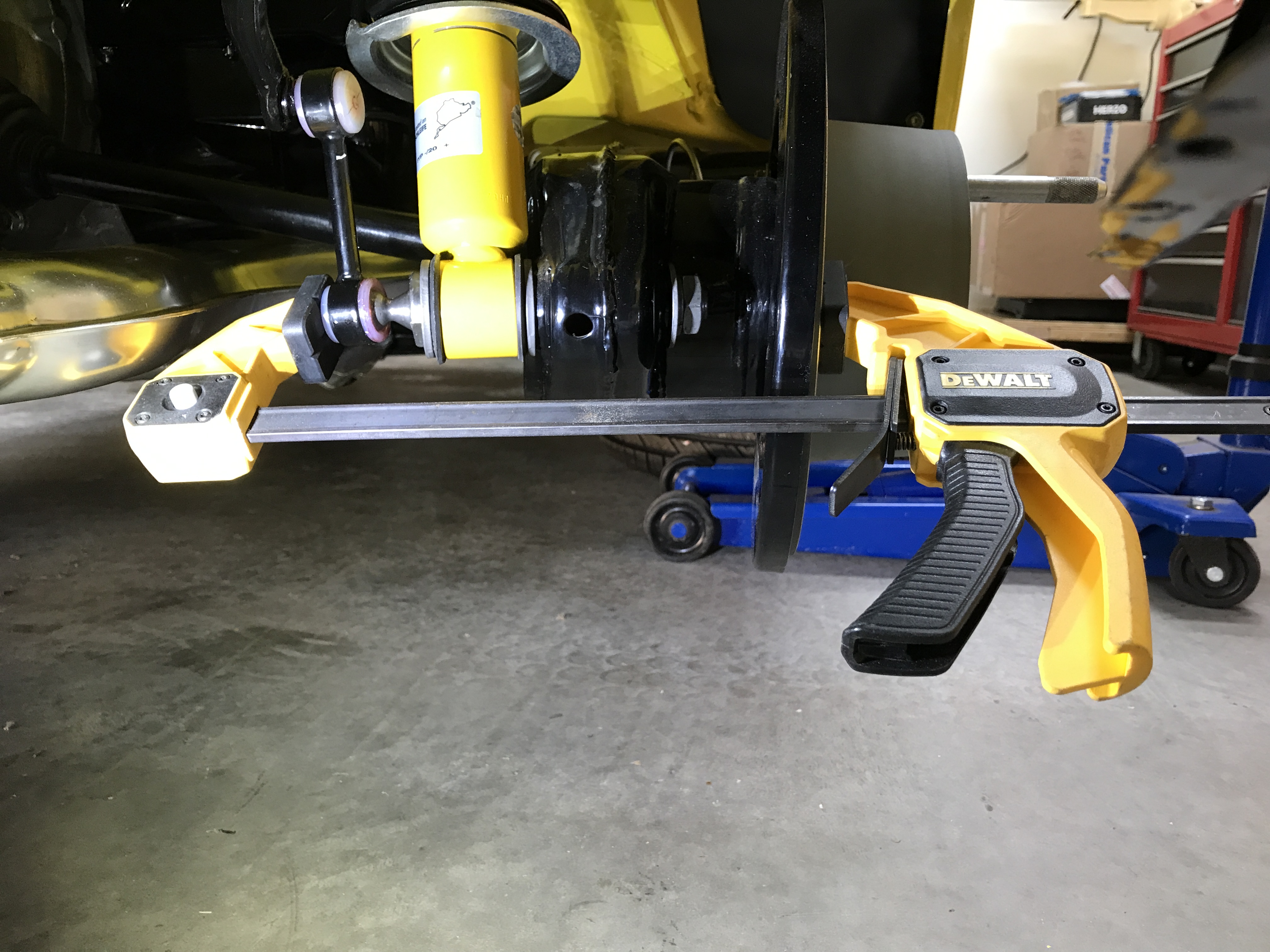

I checked my build photos and waaaaay back when I am pretty sure I used the hot water method to get the bushings into the links. Then to pop the links and bushings onto the sway bar and trailing arm balls I used trigger clamps. big and small.

That's exactly how I did it but clamp the other way and on the shock nut.

Couple of things. 1) getting it in the vice allows both hands on the bushing; 2) warming it helps; 3) using a hard plastic or wood pry tool that doesn't dig into the bushing
