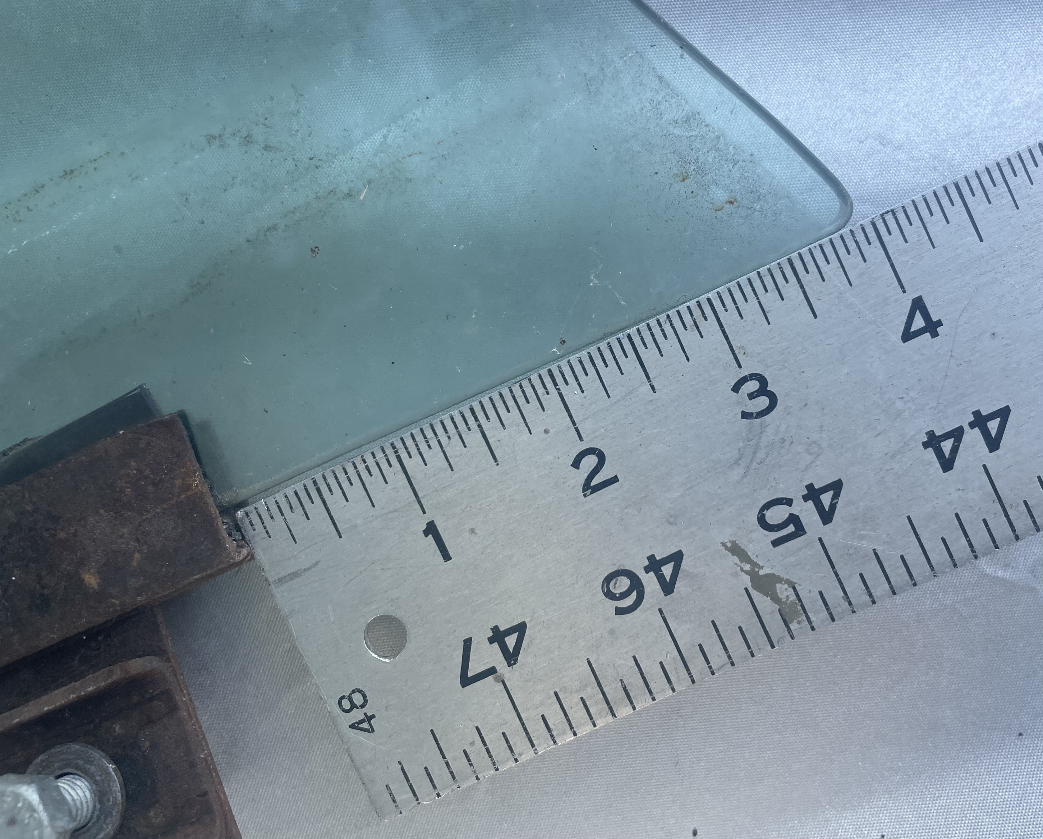

Does anyone know what this distance (red arrow) should be? I guess it could be based on the fit in the door. Not sure. (IMG:style_emoticons/default/confused24.gif) Just wanted to verify this before the weekend fun begins. TIA (IMG:style_emoticons/default/biggrin.gif)

It isn’t really critical as I remember because the glass rides fore and aft on rollers in the bar. What you have looks good.

Looks like 4” (actually 3-15/16" if you wanna be technical), I checked both ..they were the same.
