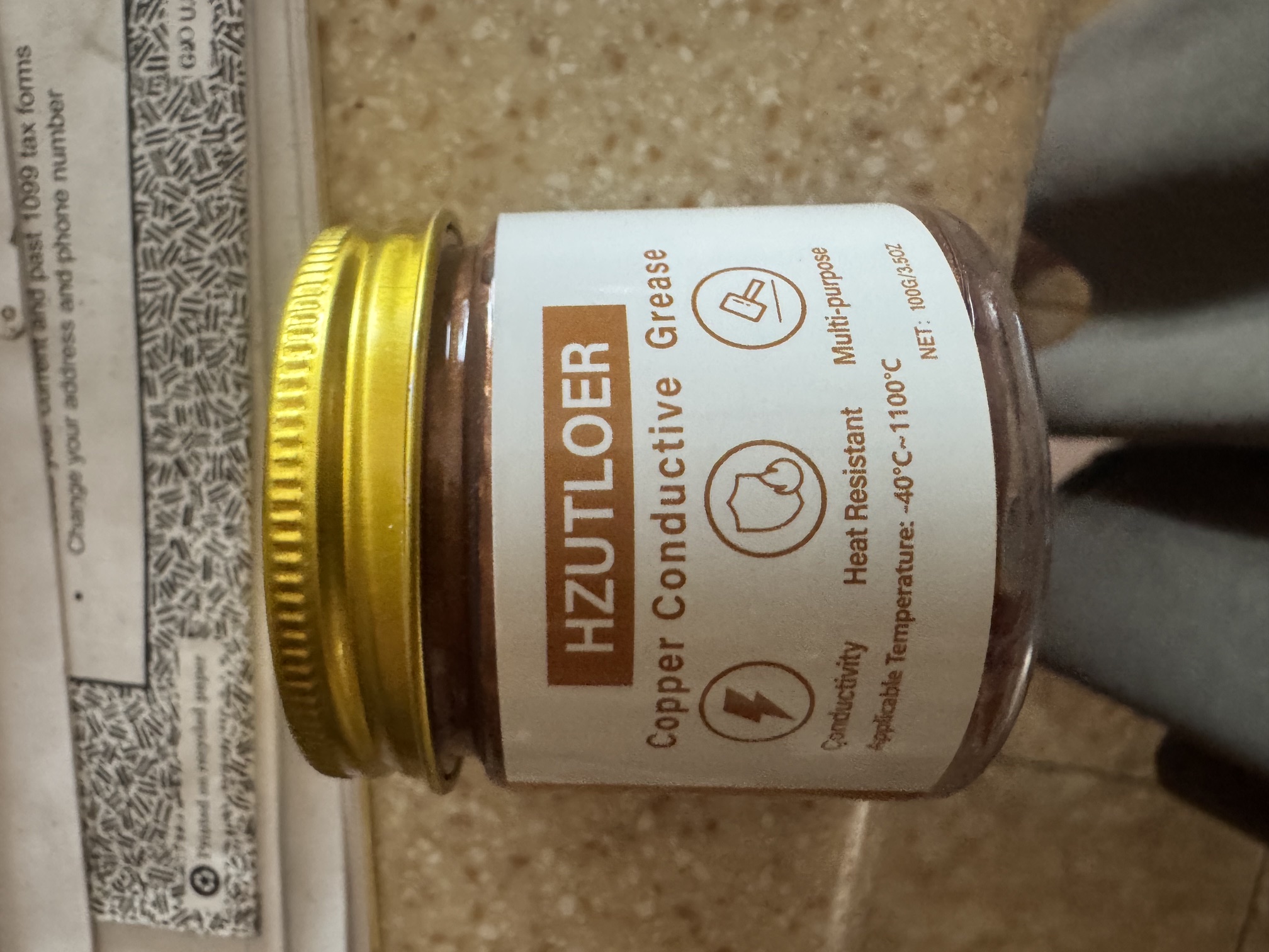

I did some research when I decided to go with a stock wheel on Howard. It was mentioned at at the bird board and others, a thin film of lithium or a similar conductive lubricant. I chose this:
