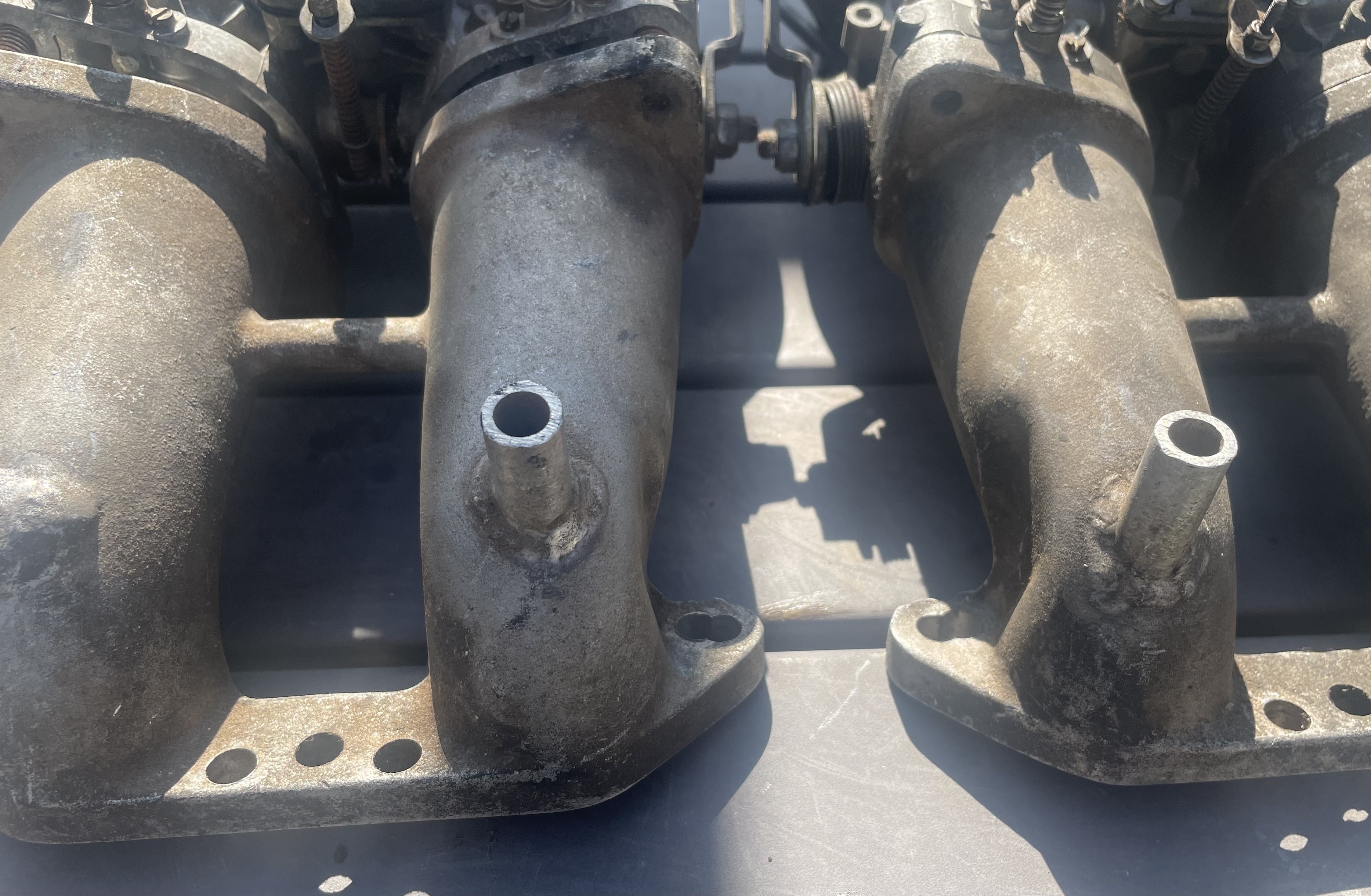

I'm going to restore (try to) a set of Italian Weber 40idf carburetors to put on a 1.7 engine. I have two sets of manifolds... one set has a vacuum port on one runner (each side of engine), and the other has none at all. Is one type favored?
Which do I want to use, and why? - I have no idea what the vac ports would connect to. If they help even out idle, I'd want them I guess. Thoughts?

the inlet manifolds you describe with the large vacuum fittings would have been used on a t4 VW bus most likely ,they are there for power brake servo so not needed the plain ones will be fine on a 914.
Pick up vacuum from one carb with the SVDA dizzy and you will be fine and block off the unused one on the other carb ,just make sure the carbs have 28mm vents and moderate jetting for a 1.7 otherwise it will run like (IMG:style_emoticons/default/stromberg.gif) ,cheers.

QUOTE(porschetub @ Aug 5 2026, 11:31 PM) *
Thanks for the info.. the pic below shows the large vacuum ports I’d mentioned. So I suppose if I pull a single vacuum from my other manifolds as you suggest, I’d need to tap in a small nipple for it? - I haven’t seen that before.

You will want the smallest venturis available for that.
Pierce Manifold is my go-to for Weber stuff.
They should have 27 or 28s available.
I'd start with 135 mains, 200 Airs, and 50 or 55 idles.
40 IDFs with 28 venturis are excellent for 2.0Ls with a "street" friendly motor.
Manifold ports don't matter, just make sure to cap them off.
Those might be helpful if you were going ITB fuel injection as they could form a plenum for an IAC (idle air control) valve.

I'am a Dellorto guy but that sounds about right ,28mm vents provide great vacuum signal and response to assist early transition to main jets which IMO work well on a small displacement T4 .this will work well with the svda Pertronix dizzy you have.
You will be drawing vacuum from one carb and not the manifold as you need a vacuum that is variable due to throttle position so the undrilled manifolds are your best choice as you mentioned you had a set .
