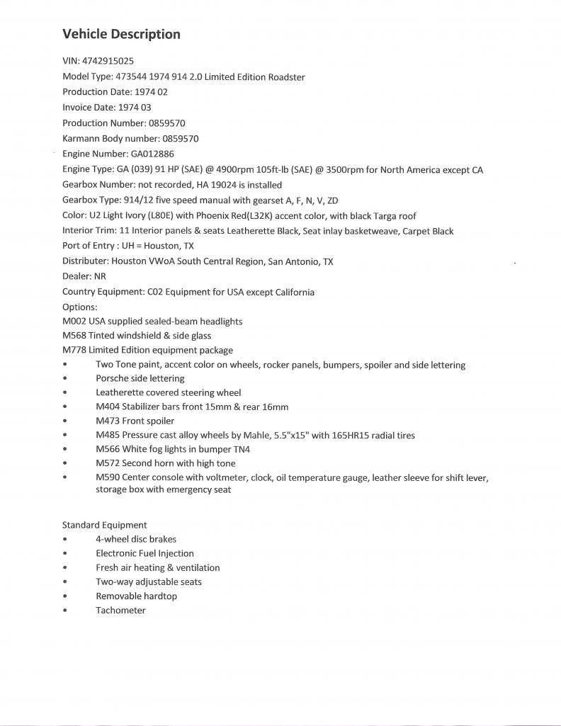

I hate to say it but you wasted your money. Porsche factory specs are a joke. You should have gone with Dave's production report.

I posted LE report as an example of Dave's production report vs what the factory does.

Dave's report was around $165 if I remember correctly. PCNA can't seem to the get the facts correct, you should not have to go back to them.
