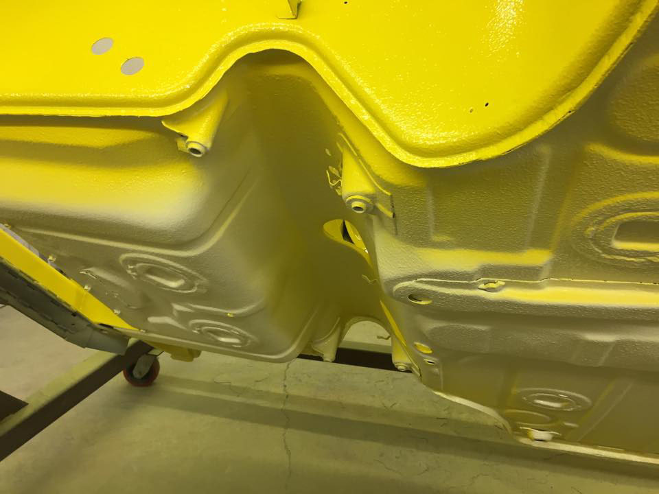

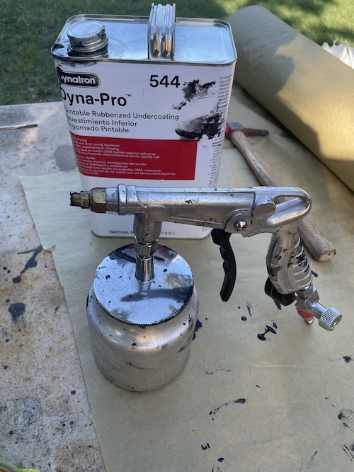

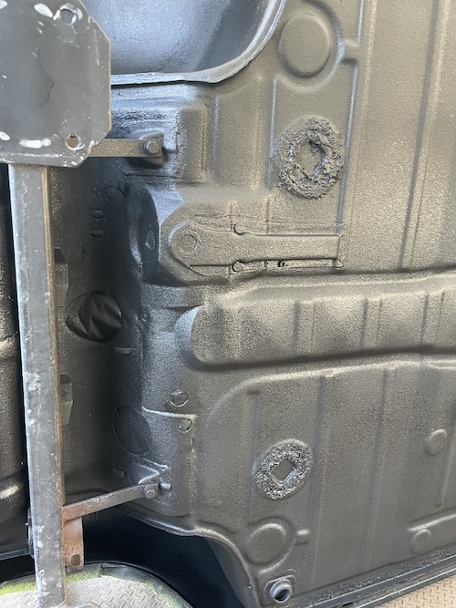

friethmiller
post Aug 11 2026, 08:01 AM
Posts: 1,462
Joined: 10-February 19
From: Austin, TX
Member No.: 22,863
I've used this on my last two builds with great results. Its like Schutz but paintable. Dynatron = 3M, I believe. I like to epoxy, seam-seal, undercoat, and then paint with the body color. I think the sixes where white with the body color partially sprayed-in from the sides. There's a PMB video where Eric explains this. This is back to factory type stuff and your driver-quality car can be whatever you want it to be. Plenty of good options listed above, as well. Good luck.

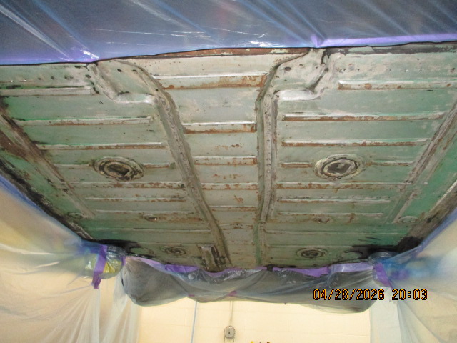

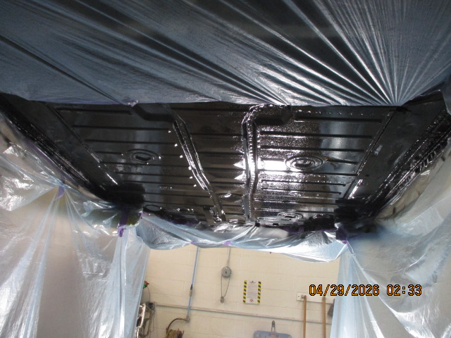

i had mine shot with POR 15

mine was preped with a zinc neutralizer

dtmehall
post Aug 11 2026, 01:46 PM
Posts: 349
Joined: 21-December 23
From: Michigan
Member No.: 27,808
mine is a 73 1.7 driver. my goal was to rustproof the pan
it won't be painted, it will just be flat black

QUOTE(dtmehall @ Aug 11 2026, 10:06 AM) *
QUOTE(dtmehall @ Aug 11 2026, 02:46 PM) *
That looks KICK ASS for a daily fun car!
Nothing will stick to the bottom of that car.
As long as you keep it shiny side up the sun will not be a problem.
I think it will still be nice 50 years from now...
If you want to change the look or do any welding, you will have to deal with the POR15.
Removing it usually requires grinding it off. (IMG:style_emoticons/default/headbang.gif)
It will laugh at mere sandpaper.
The draping in that picture looks like a DEATH TRAP to me.
I'd want a full-on paint booth style respiration system before getting in there with the fumes!

the passenger compartment was de-rustified previously (not with POR 15), so I would think that the chances having to weld on the pan are low
