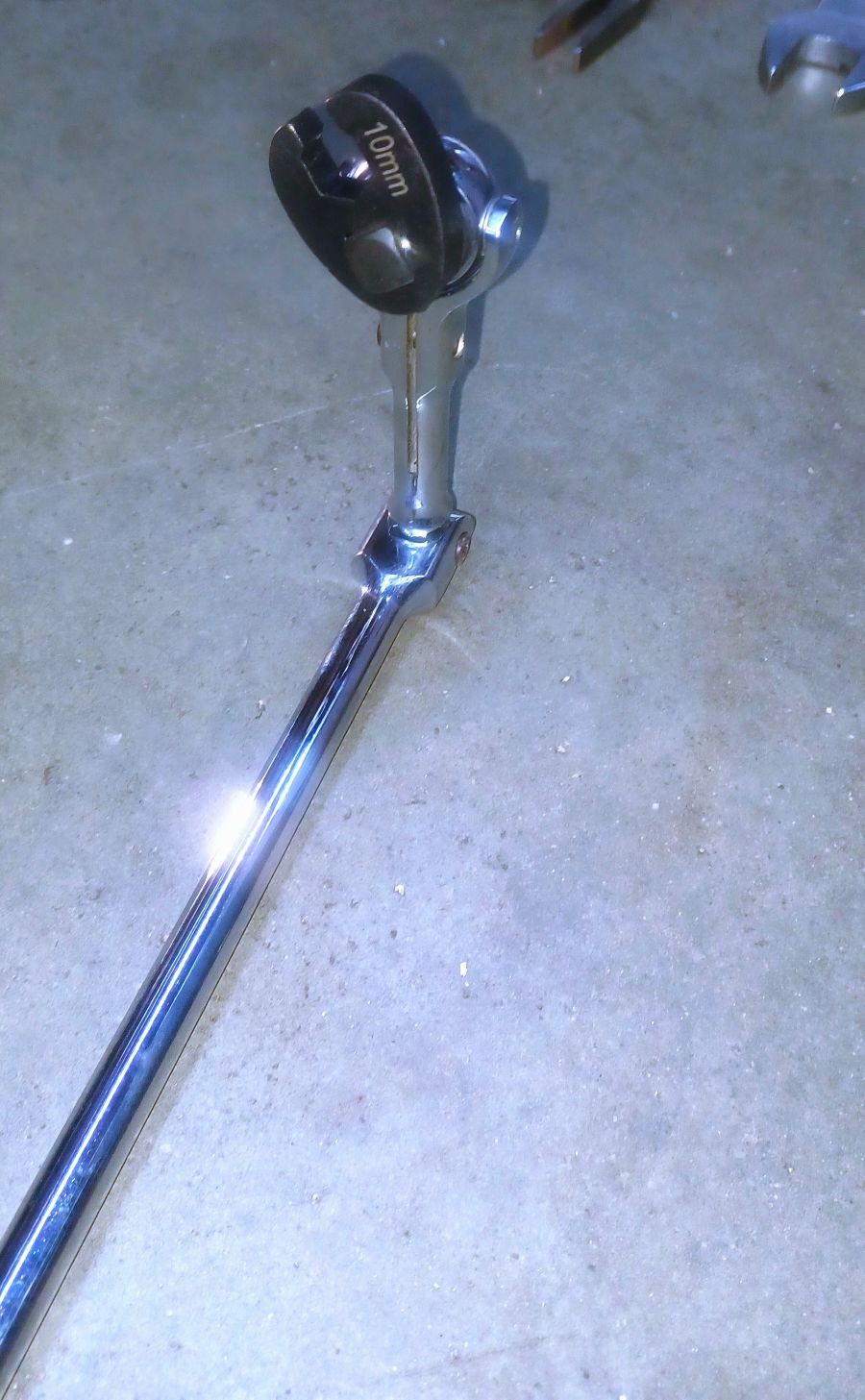

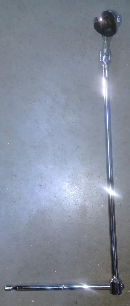

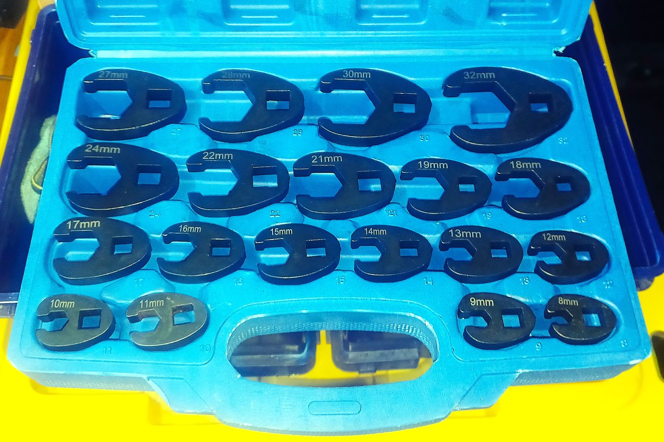

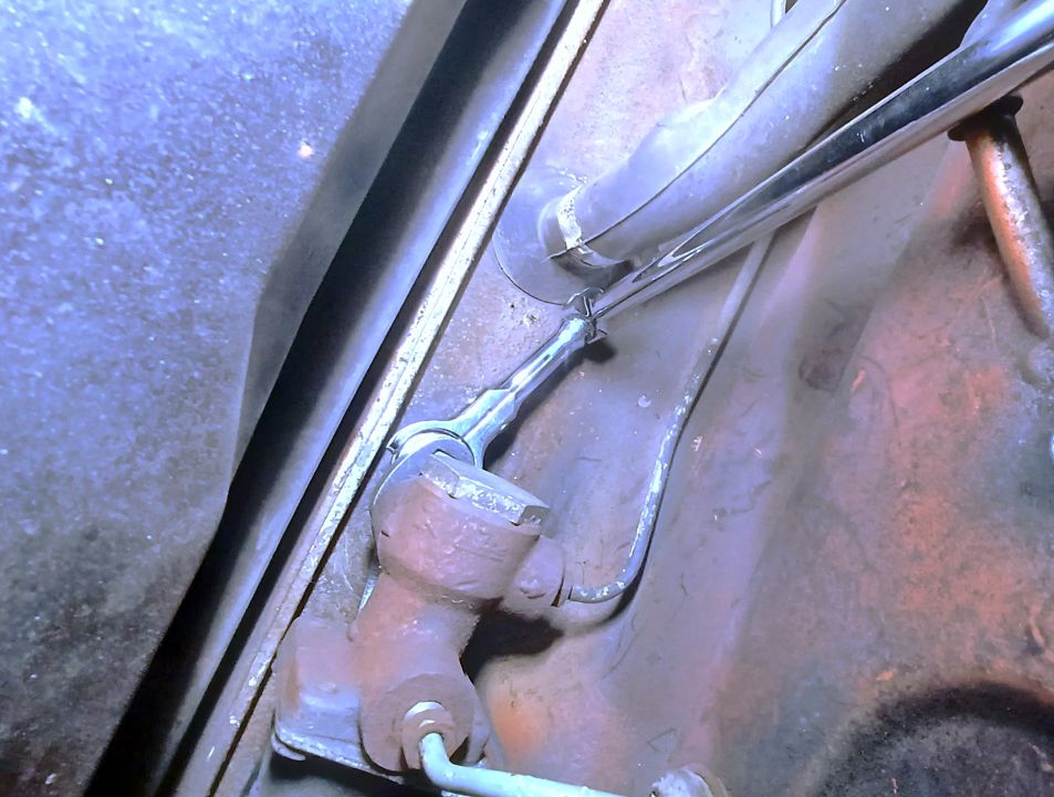

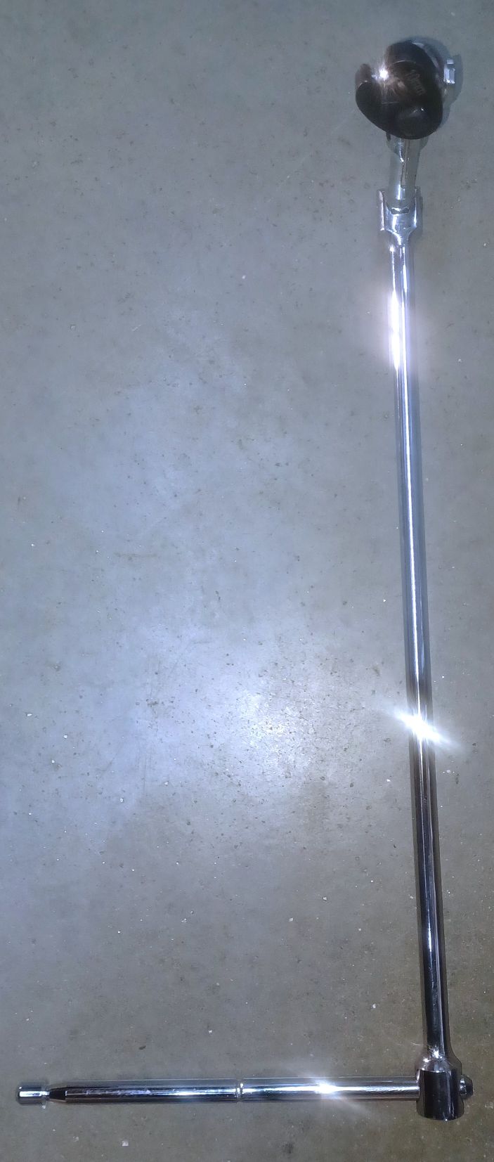

Success!! I was able to remove the passenger side hard line flare nut from the soft line AND the top flare nut on the broken drivers side hard line without damaging either! (IMG:style_emoticons/default/dancinnanner.gif)
I bought one of the cheap flare nut crows foot wrench sets from Walmart and a 3/8" flexible ratcheting T-Bar from Harbor Freight.
These made removing and reinstalling the driver's side hard line's top flare nut on the proportioning valve possible. I honestly don't think I could have removed that top flare nut or reinstalled the new one without them!

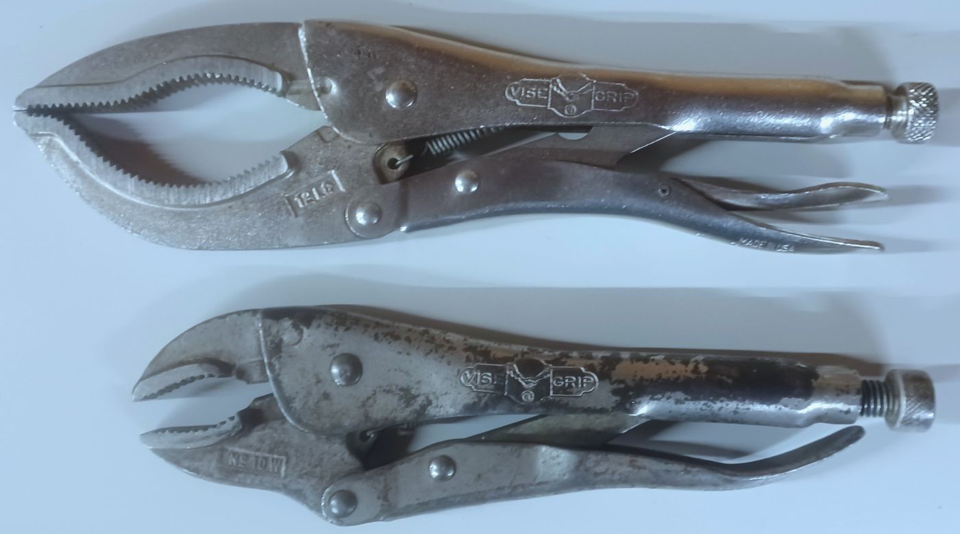

I also used my trusty vintage 3" C-Jaw Vice Grips (favorite tool in my tool box!) to hold / brace the passenger side rubber hose fitting and the 11 mm flare nut crows foot on the hard line fitting with a 3/8 swivel head ratchet and a long 3/8 extension.
