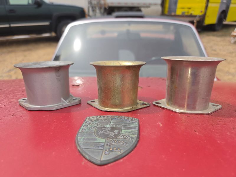

I am assembly IDTP carburetors. I have trumpets (aka velocity stacks) and also boats (bottom air cleaner connecting piece). Are they both meant to be used at the same time?
If so, how do you tighten the nut (8mm ATF)? I don't see room to get any conventional wrench or socket on there. Is there a special tool required?
I'm probably missing something obvious. Top is what I understand to the be stacking order. Below an example of where the nuts need to go.

For me, I got an 8mm deep socket (1/4" drive) and needed to cut it down a bit,
so the end of it is below the top of the trumpet.
Then use a 1/4" extension on that. It helps to be either a wobble extension or at
least fairly 'loose'.

Looks like your assembly / stack up is correct. An articulated or semi flexiblle socket extension is whats required for tightening.
All with the added fun / excitement during assembly that a dropped 8mm nut will be heading straight into the carb throats!
